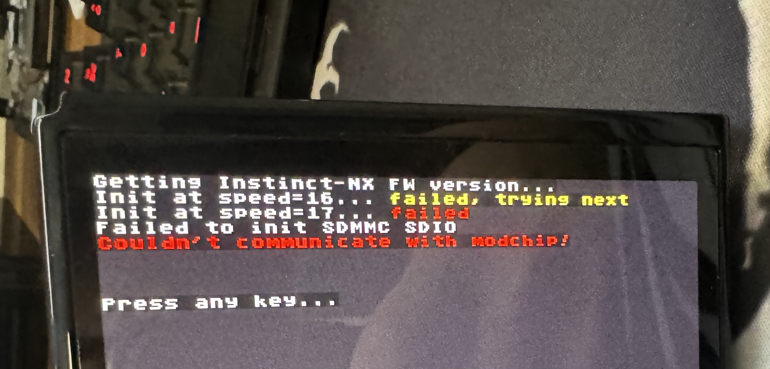

Anyone else had this issue where it lights green, boots into hekate and instantly turns off again just to glitch again?
Its stuck in a glitch loop where it constantly glitches, turns green and turns off again =/
While troubleshooting:
I tried to update the V6S modchip.
But I get the error. "Failed to init SDMMC SDIO"

Anyone who can dump the Gigadevice chip on a working V6S for me and share the complete .bin file?
Seems that it's slightly different than the v1.3 floating around online =/
If you hold vol+ and vol- together while trying to boot, does it boot to stock firmware?
I had an Instinct chip that functioned "fine" as you showed in your video, but there were shorts on the chip itself that, for whatever reason, would not allow the Switch to boot even after going through the training and finally showing the green success LED. I swapped it out for another Instinct and it booted up perfectly.
If you're sure that all your solder points are reading as they should, it could even be a problem with the OLED display. Try reseating the ribbon cable for the screen?
Seems i have this exact issue, trying to flash it using an ST-link :/
