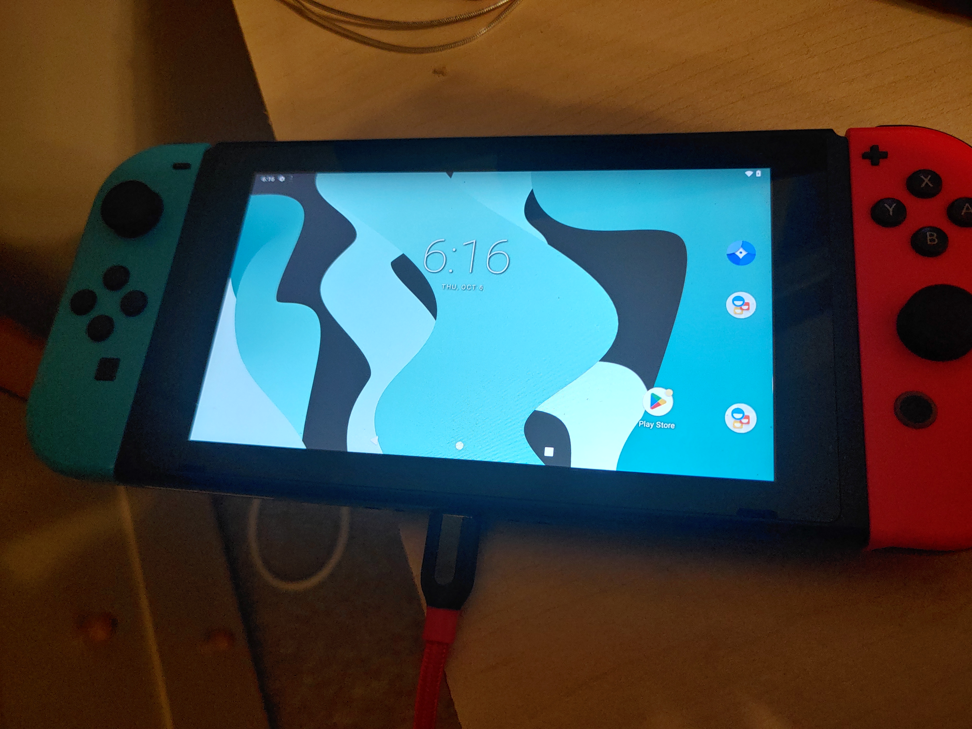

Anyway it looked like lineage os booted and works just fine! there seems to be a mouse toggle feature with the capture button, cool! also, is there a way I can play NVidia games on it? and thank you so much for the tips and files as I always wanted a second android device!View attachment 330560

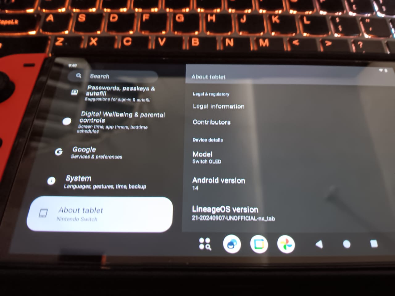

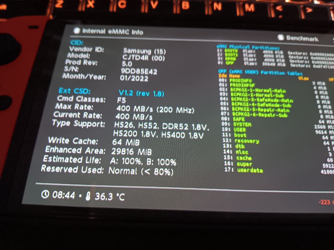

finally, after several attempts to repartition I succeeded after following your tutorial Resizing switch user partion (shrink/expand) on this forum
Thanks, @evil_santa
