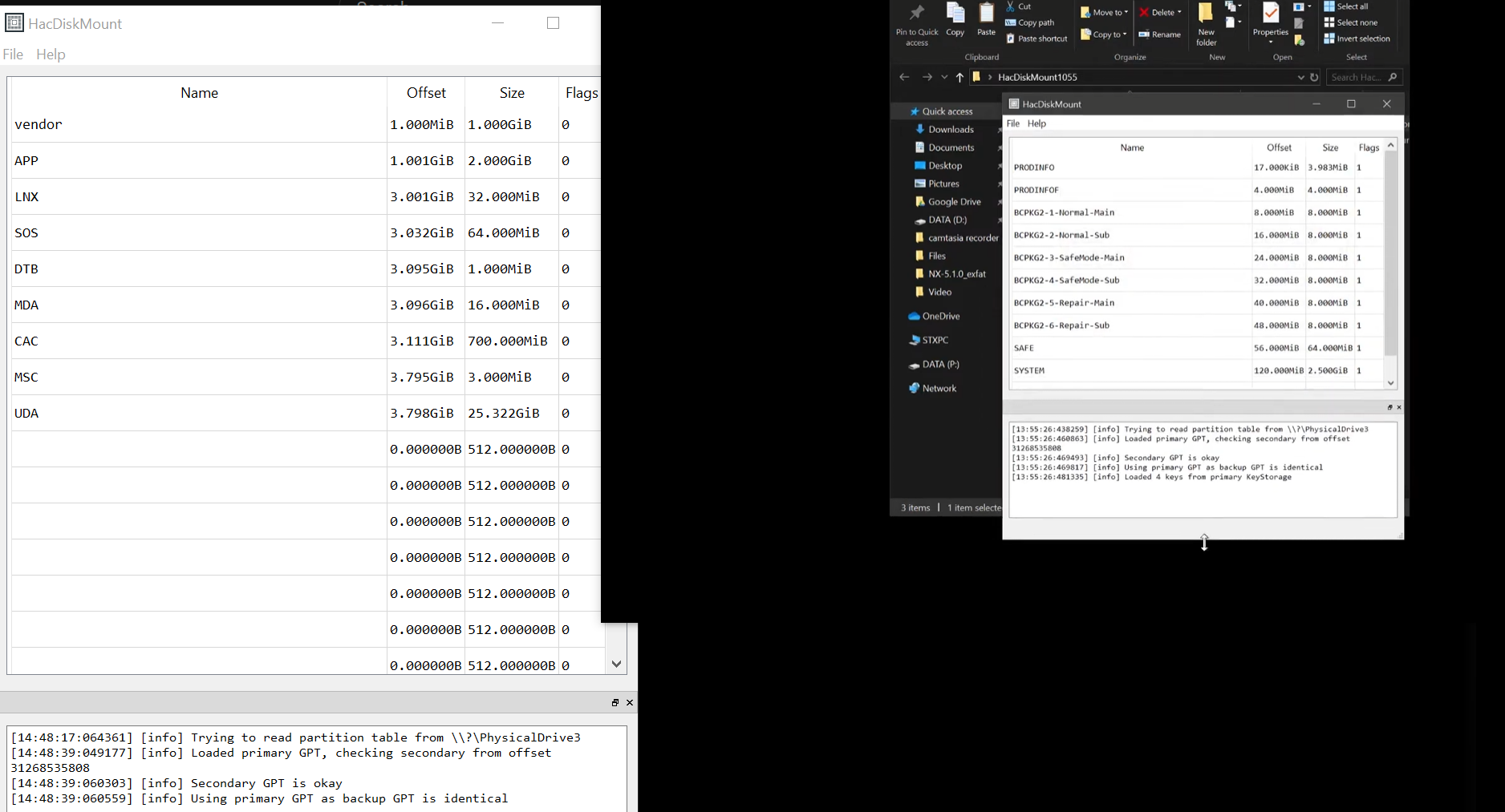

Is there a way to get my switch back to stock HorizonOS? my switch has a purple screen on it now when I turned on because I installed switchrootLOS to the internal storage awhile ago and lost/wiped the SD card I dont have a NAND backup so now what do I do to get the stock switch os back?
Ok you need to follow the level 3 guide
UPDATE: check the 3rd page for my update after following the video you sent me
Oh ok. I was trying to recreate the original partition by wiping the Nand ( I have a backup before I did this) and making identical fat16/unformatted partitions like he has in the video, but I couldn't shrink it below 8mb and I figured this probably wouldn't work.
So I'll try this video instead then thanks.
