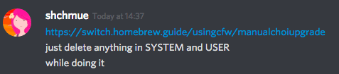

I went through Raj's guide with ChoiDujour because I wanted to update my Switch back then right before ChoiDujourNX was released. However I'm not sure which exact step would involve cleaning the log file and I don't need to go through all the steps (that I'm still a bit familiar with luckily). So I throwed shchmue a PM on Discord and hopefully he will take on me.
At least it's a cool thing to know how to delete logs - for anyone.
I know most people either have a clean NAND backup or went online at least once so they won't benefit from that (as there would be a log stamp mismatch on Ninty's server leading to a ban) but if others that have never been online need this, it might be helpful.
Let's see what (and if) he replies.
Edit: Okay you already showed it in your screenshot (shchmue replied to me on Discord). Just mount SYSTEM and USER without up- or downgrading the FW (obviously) and delete anything in there, that's it. Will try that when I got my friend's Switch back. :)
Edit 2: While deleting everything in SYSTEM, don't delete the file 8000000000000120 in SYSTEM:/save/ or the Switch won't boot! So that's the only file that needs to be left there. Everything else in SYSTEM has to be deleted.
