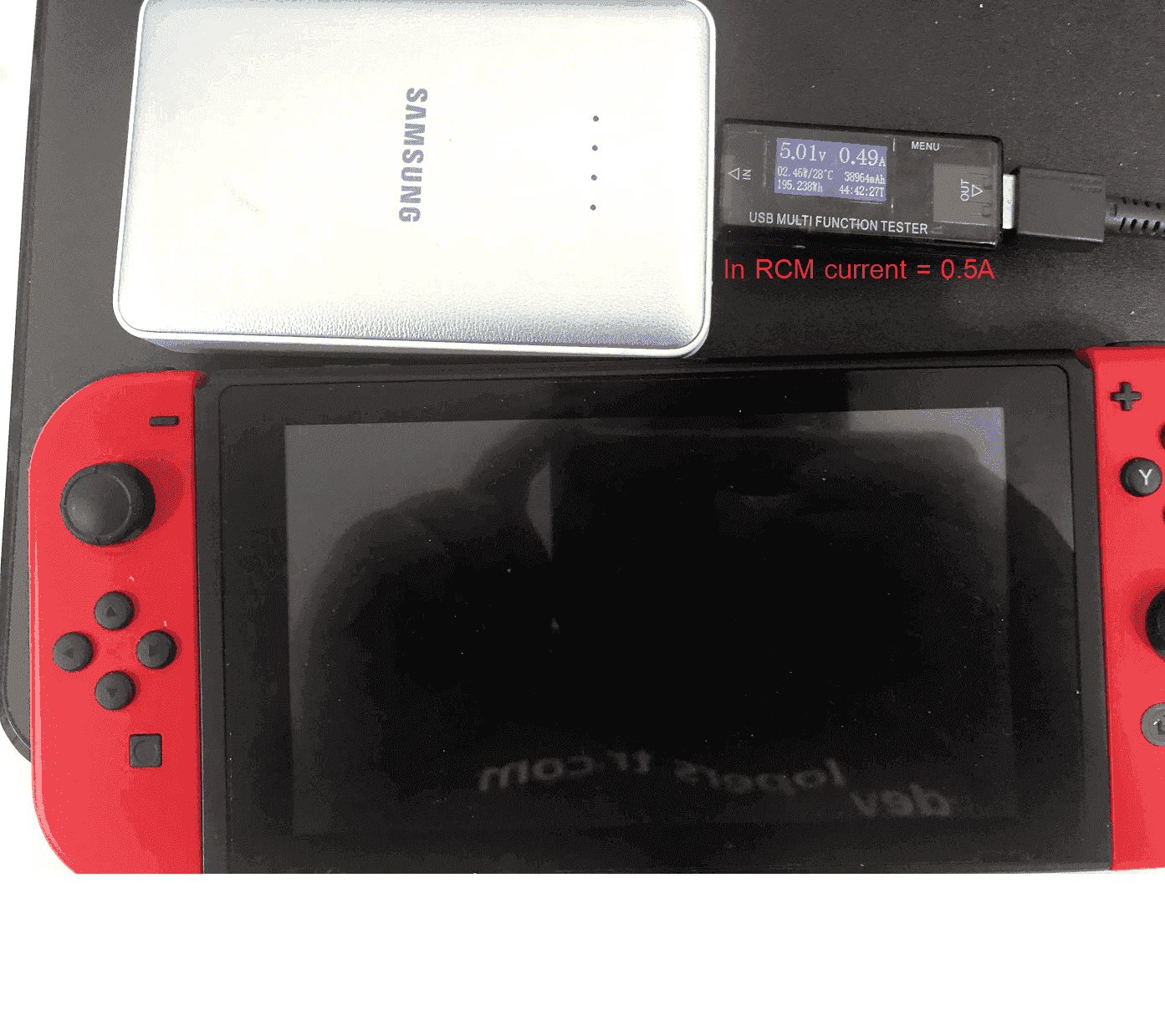

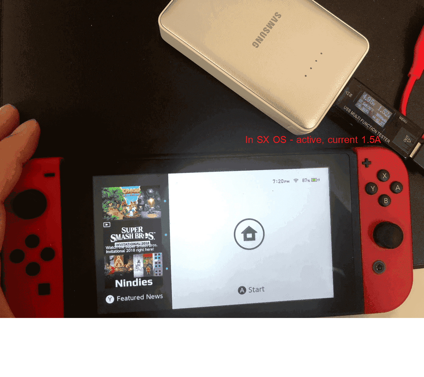

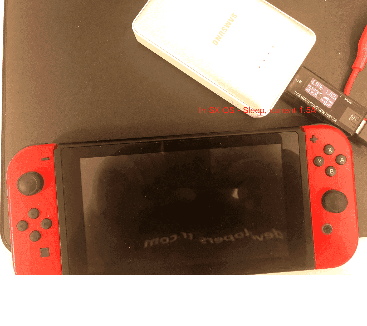

This is my test
RCM = 0.5A
SX OS Sleep = 1.5A
SX OS Active = 1.5A
