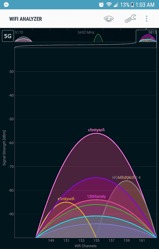

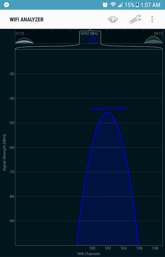

I cleared up my Switch's Wi-Fi issues by doing the following:
1.) Improve the quality of your Wireless Fidelity.
Download and install WIFI ANALYZER for Android in the Play Store, and open it up. Scan the 5GHz band. You'll likely see your Wi-Fi signal over-saturated by your neighbors around you, with many open channels in the middle like this:
Go into your router settings and change to one of the open middle channels. Scan again with Wi-Fi Analyzer. You should now be the only hump by yourself, and that's what we want. I changed mine to 5.5GHz, and nobody else in my neighborhood is using it:
