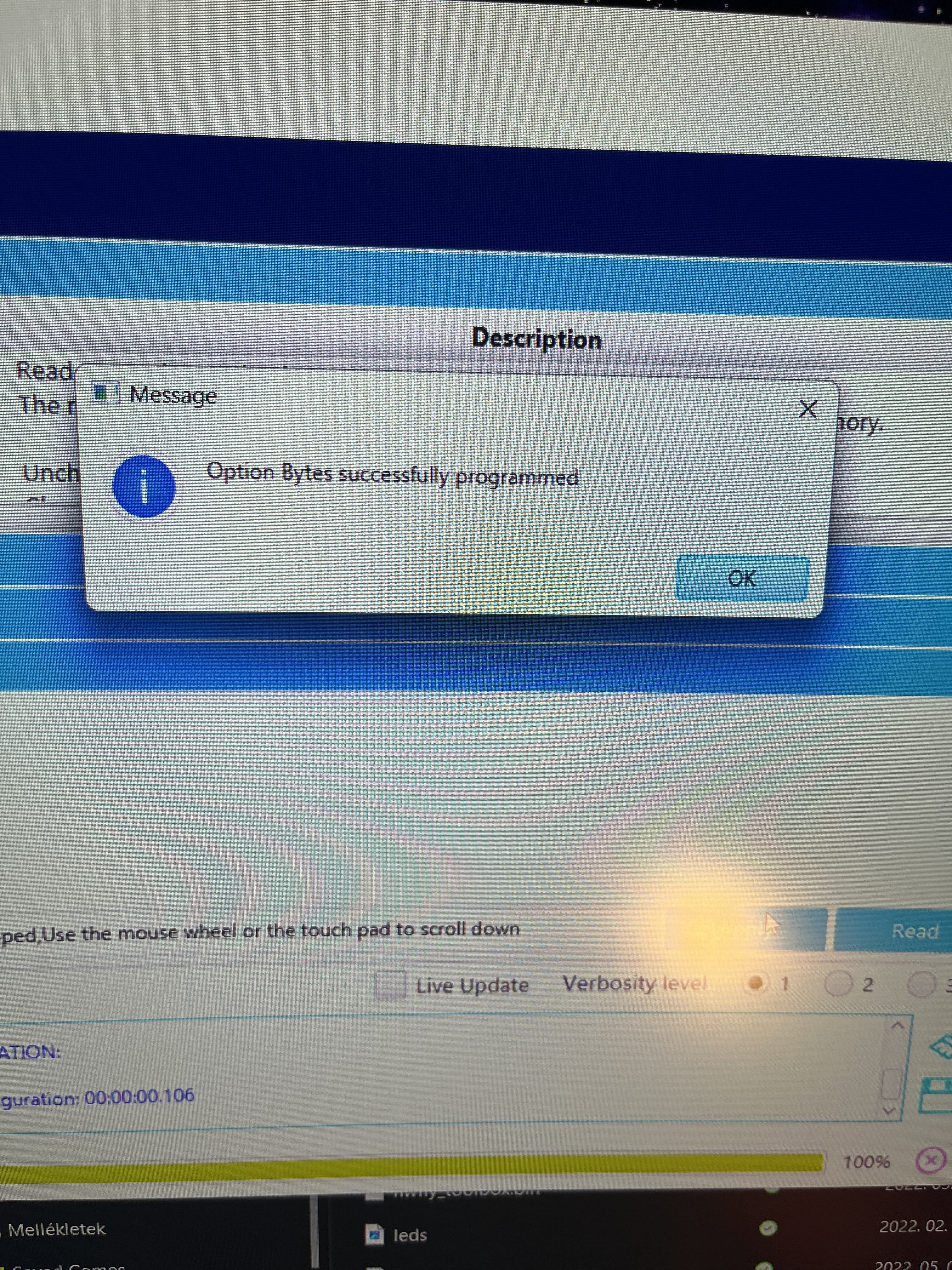

Hi guys . Update :
The chip is not working in my oled , just constant red light .
I tried st link programer , the software see the chip but if i take the tick read out protection and apply it the software give me 3 massage :
1. Option bytes successfully programmed
2. Warning : RDP=165 will be ignored as it has allready been midified
3. Warning : RDP=187 will be ignored as it has allready been midified
And the thick is checked .
If i browse bootloader and hit start programing button i got , failed to erase memory error .
What can i do now ?

Hi guys . Update :
What can i do now ?

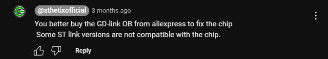

1. You should have bought a GDLink instead of an STLink. As per sthetix he has been receiving failure reports with regards to using STLink.
2. Have you tried updating your STLink programmer firmware? I encountered issues with flashing thru STLink before but I manage to fix it by updating its firmware.
