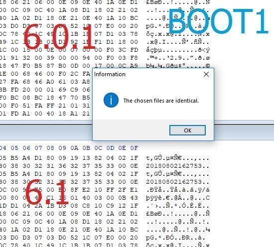

UPDATE
Firmware 6.1 won't update BOOT1. Emunand signature in BOOT1 will remain in the Switch after updating to 6.1. If Emunand disappears (unlikely) use emunand-BOOT1 backup from previous firmware (6.0.1).
CONFIRMED
Emunand works
SX Menu works
HDD works
HBM works
HB works
Nothing has changed for end-users to worry about.
P.S.
I have 6.1 firmware files, leave me a message if you'd like to have it.
Enjoy!

UPDATE
CONFIRMED
Emunand works
SX Menu works
HDD works
HBM works
HB works
P.S.
Enjoy!
