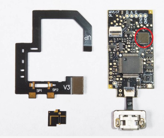

UPDATE 2: This is only going to work on some HWFLY chips. Older ones use higher protection than the new revisions that seem to use the QFN FPGA.
UPDATE 3: This should fully work on OLED modchips with the QFN FPGA. https://github.com/Pheeeeenom/firmware

This is the official site of the QFN FPGA chip. chipnx. com
Sorry, but can you provide verification of this? I'm a little bit sceptical given the fact that the site contains images for the OLED and Core variants, but no image for the Lite (which would make sense for someone making a fake, given nobody has seen a lite variant of the flashable chip right now).
