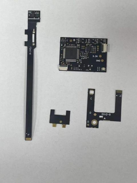

I finally received my OLED HWFLY today. First thing I did was flash it with 0.6.2. The flash.bat completed without error. After installing the chip and booting the first time, it flashes orange. I left it run for about 10 minutes, but never changed to yellow or green. from the LED diagram, orange is supposed to be either writing payload to BOOT0 (during training) or an unknown error code. Has anyone come across this? I am not getting any red LED, so I believe all my solder points are good. Any help is appreciated.
Reactions: Donnie-Burger
Donnie-Burger
Oct 27, 2021
927
www.youtube.com
1,810
Check all points with a multi meter in diode mode. Ground should beep and rest should give a value. If no value thats the point that needs attention. points C and or D I would assume.
