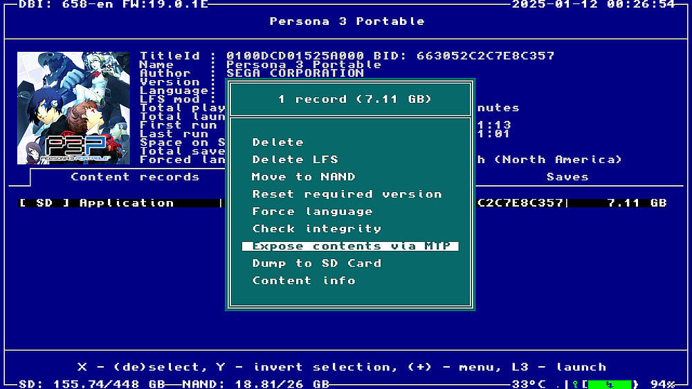

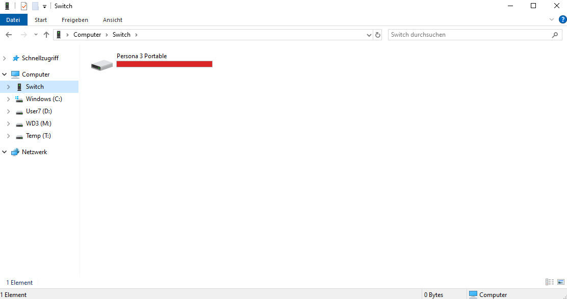

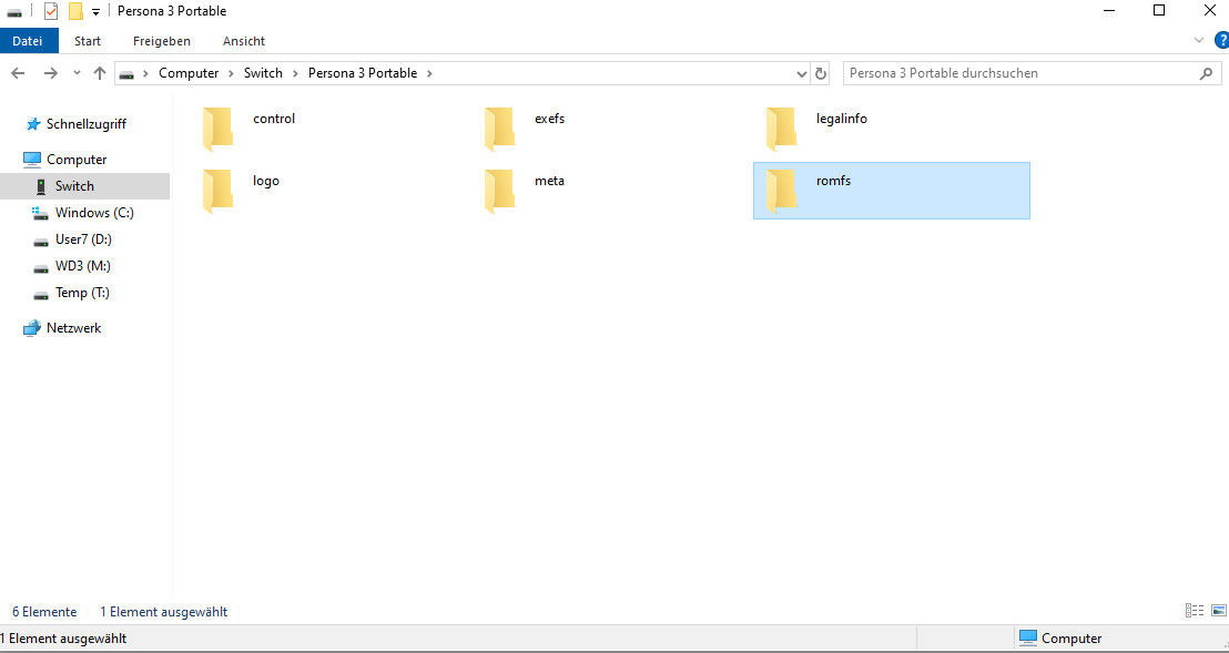

A better way is (/ would be) using DBI (658-en)
(USB-C cable required)
Browse installed applications and select the game - press (A),
then select base game *or the latest update* (up / down) and press (+) to
Expose contents via MTP
Finally copy romfs / *the file(s) needed*
Repeat with the latest update and copy / overwrite into the base game romfs folder

i dont have this option, i missing something?

Make sure you've run the rcm lockpick payload from Hekate and your prod.keys file exists in your /switch folder. That file needs to be there for decoding functionality to work in DBI (it won't show up if it's not there).
