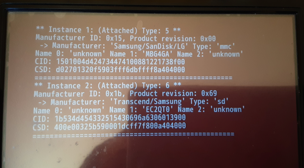

I also went ahead and downloaded your new mdinfo to check the CID

@skawo you can find a diagram by the user nino in the original German thread: Brick nach Speicherfehler

When the MEDIA ERROR console arrives, I can take a look at the CID, which will give us another Datapoint :)
