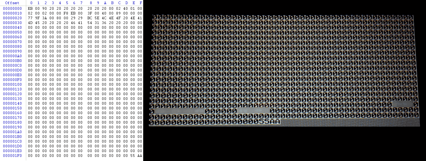

Kane, what sort of SD are you testing with? The one that came with my 3DS(2GB Toshiba) initializes but doesn't seem to read right. Another SD I have(1GB Lexar) won't even initialize.
I've attached a pic of what reading the first sector of the 2GB one looks like. Left is from my PC, right is from my 3DS. I've blurred the odd bits of the 3DS one as I have no clue what they could be. But as you can see, only the last two bytes match up.
I cant say whats happening on the other card but the one where you posted the screenshots:
Your PC is reading sector 1 (or higher) while the 3DS is reading sector 0 ^^
To get another SDCard to work try changing the SWIDelay modifier
It's definitely sector 0. Look at 0x36, it has the bytes that PFF looks for to know there's a valid filesystem there(0x4146). But on my 3DS, that spot just reads as all 0's. PFF keeps returning "FR_NO_FILESYSTEM" when I try to mount it.
1. Thats definitely not sector 0, Sector 0 is the MBR,
2. Does your linker script have a heap section ?
