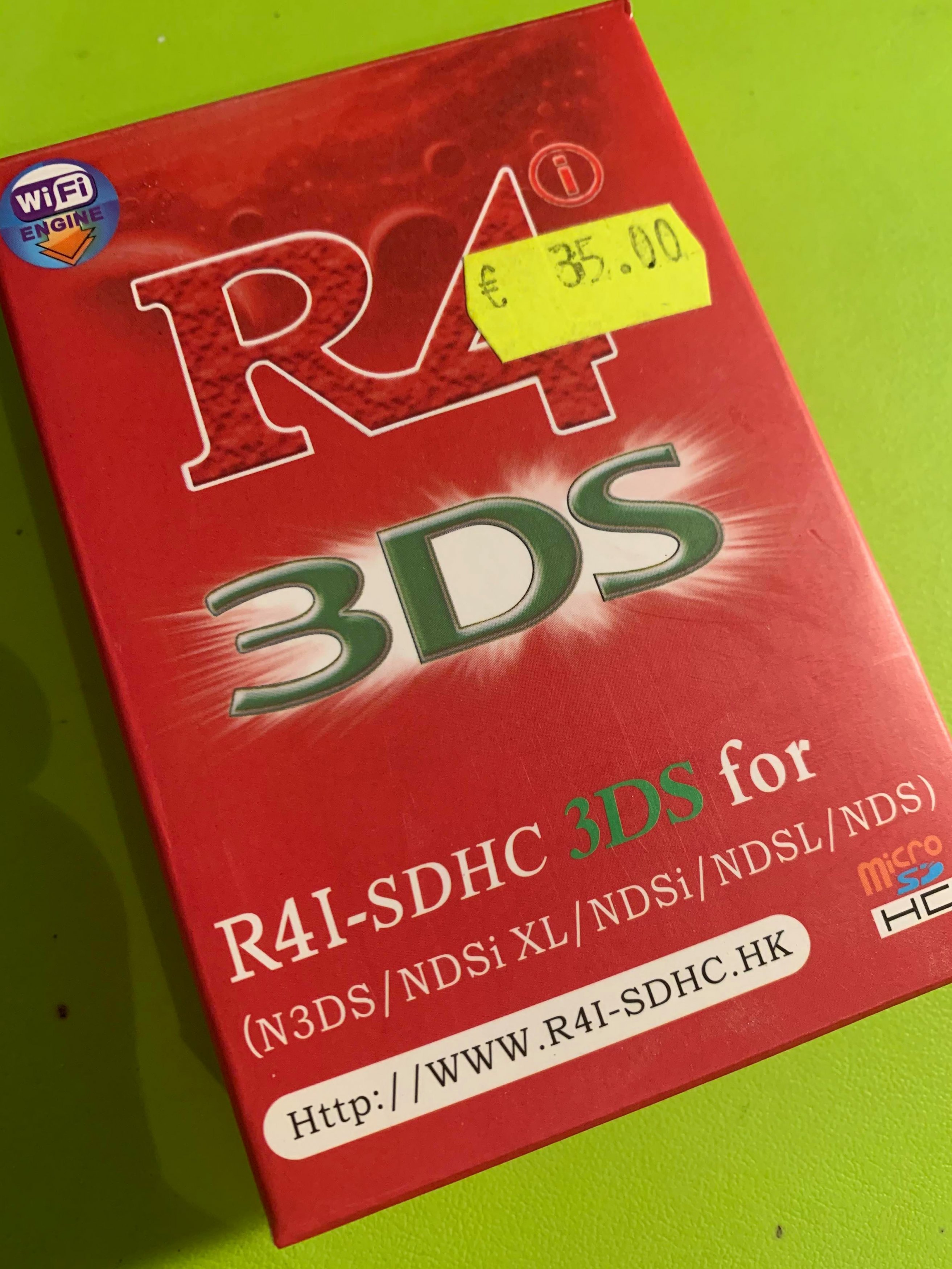

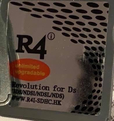

Hi everyone who reads this,
First of all, I'm new to this forum so please dont judge my knowledge of this problem.
I have an old R4I card, but it's a clone. The website advertised on the packaging is "ww1w.r4i-sdhc.hk", which is offline.
I've tried installing a few kernels. Some work on my old DS Lite (which is half broken so can't really play), but then I get the error on my DSI "An error has occurred, please..."
Does anyone know an update to this problem/ a kernel that I should try?
I have uploaded an image of my R4i-card as well as the packaging.
Regards,
Thomas

Hello.:)
Thank you for the Pictures,that helps a lot.:yay:
Maybe this great GBAtemp Thread helps you:
https://gbatemp.net/threads/salvaging-r4i-sdhc-hk.375220/
Good Luck.

Then it has maybe nothing to do with the Kernel of your Flashcart.
Nintendo Ds Lite - Flashcard works
DSi - Firmware Version 1.4.5x ?
If YES,your Flashcard is BLOCKED ! There is unfortunately no Chance to use the Flashcard regular.
You maybe can make the Camera Exploit/Memory Pit and install Hiya Custom Firmware and TWiLight Menu on your DSi.
That unblocks your Flashcard for use on your DSi.
Thank you.:)

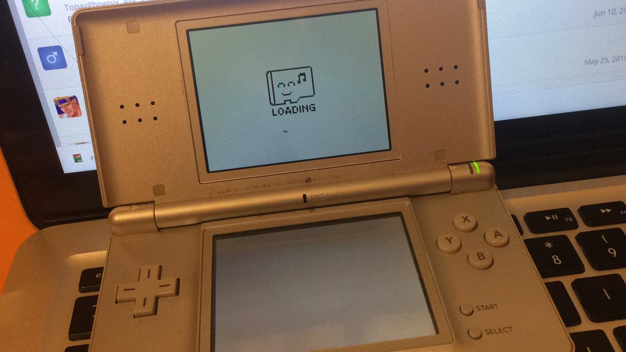

I would like to ask about
R4i 3DS Unlimited Upgrade Firmware clone
I tried with a 2gb Sd card and a 4 gb, but it does not support more
It shows the The Spiderwick Chronicles without an sd card in it.
It shows a white screen with loading and a smiley sd card.
The site on it is r4i-sdhc.hk
But it does not move from here on. I have a 3ds and Ds lite, I would like to make it work on the ds lite.
Thank you for any answers

Chil, you just need a YSMenu, and the problem surely vanished : https://gbatemp.net/download/retrogamefan-multi-cart-update.35737/
download it, use the "R4 clone", follow the instructions, copy your games, aaand play your NDS again

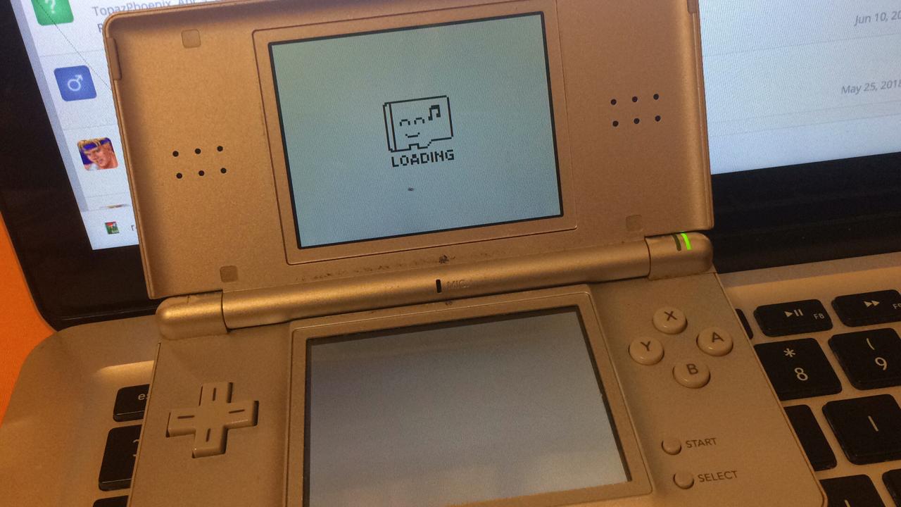

Thank You for your answer. I followed the step, the Sd format application made my card Fat16, i used the R4 clone file and i looked for a kernel online. I have put both file on the sd card root. Unfortunately the same result happened.

a FAT16? wow, i just using FAT32 but i think its not a big problem, as i thought, there is a theory named "time-bomb", you must return the date of DS to maybe older than the R4 dates, year 2000 maybe? , then try to put your R4 on again. First, please try put your R4 on the DS without micro sd on it, to make sure that the error is just came from the kernel, not the R4 itself
