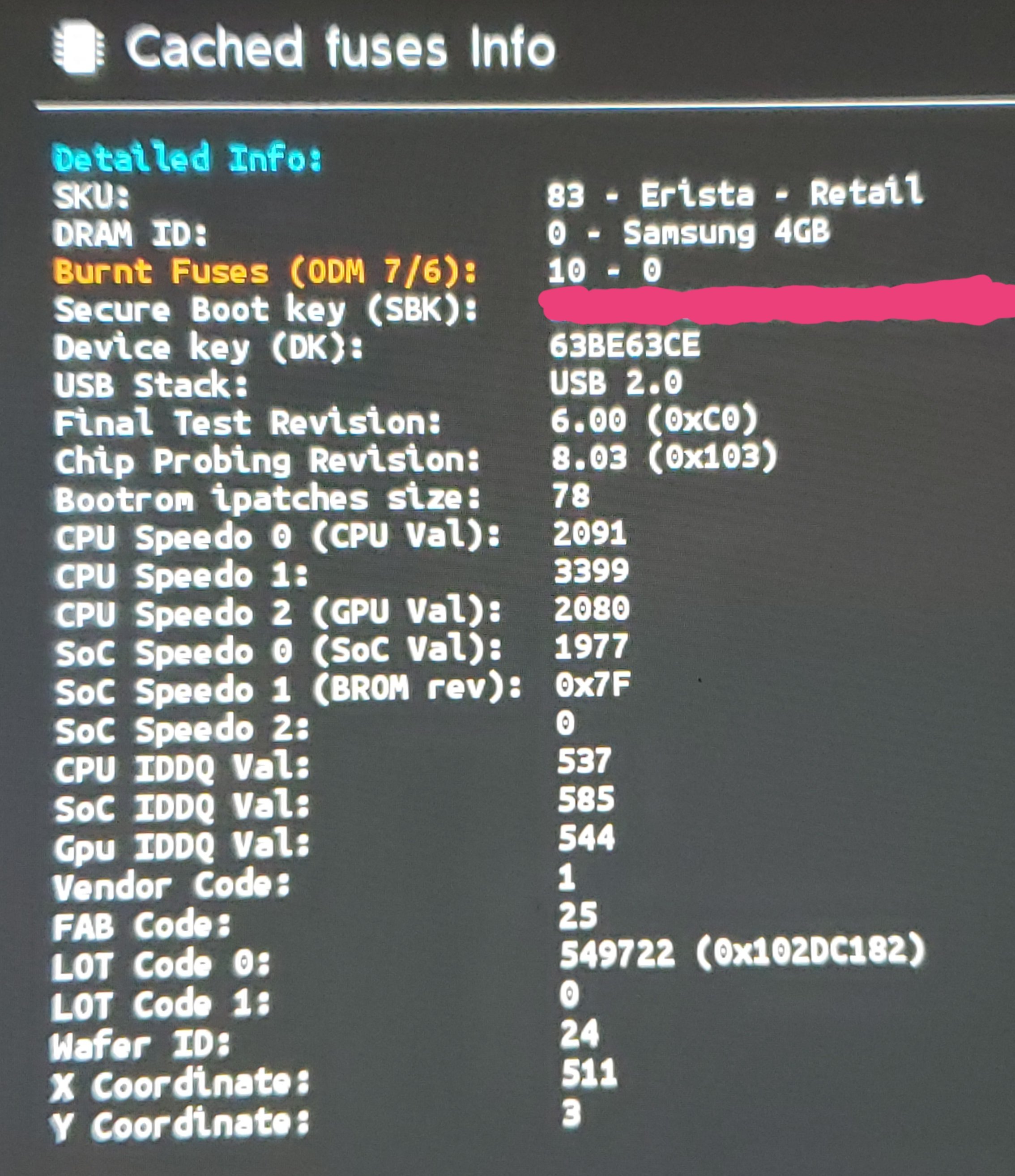

Hey man sorry for a late reply and thank you for taking a second to help. My backup nand is 8.0.1 just like my current. once i got the switch i immediatly updated to 8.0.1 using the settings, then i put CFW on it, sx os (unfortunately) and then learned more and more and have been on atmosphere for a while now with kosmos hekate. Here is an image of the fuse stuff. i know what burnt fuses mean but i dont know how to make sense of this.
Your Fusee count isn't right...
8.0.1 has 9 fuses
8.1.0 has 10 fuses
Update using choi with autorcm, without it you will burn even more fuses.
You currently have 10 fuses.

thank you very much man hopefully this thread can help otthers with the same issue. i was able to get into OFW clean the sysnand with hacdiskmount and memloader and am now enjoying online play on warframe and have CFW on emunand. All it took was your suggestion of running choidujour on switch and updating the firmware, then turning off auto rcm to load into OFW.
