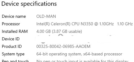

Starting to have problems with mine overheating, and getting notifications about low on memory. Cleaned fans just a little while back. weird.
Asus
1.1 Ghz Celeron and 4 GB of RAM.
There's your problem.
Sorry, I don't see it. I only type on this darn thing. Know little about it.
This is the way it came. Bought it used at a Rent-A-Center. Floor model
You would be much better off purchasing a new system. Even $300 laptops from WalMart would blow your system out of the water. They're also much, much more energy efficient and run cooler than your older Celeron. If you're running Windows 10 or 11 you just don't have the system specs to run the operating system any more. I've recently had to ditch Windows on my mothers laptop (about the same age as yours, honestly - a low end Toshiba) and replace it with a Linux distribution just so she can keep using email. And if all you do is type on it and browse the web look into a Chromebook to save money.

Tiny bit of PC gaming on it also [PPSSPP, RETROARCH, [downloaded] GOG games], too slow to run steam games online on it.
