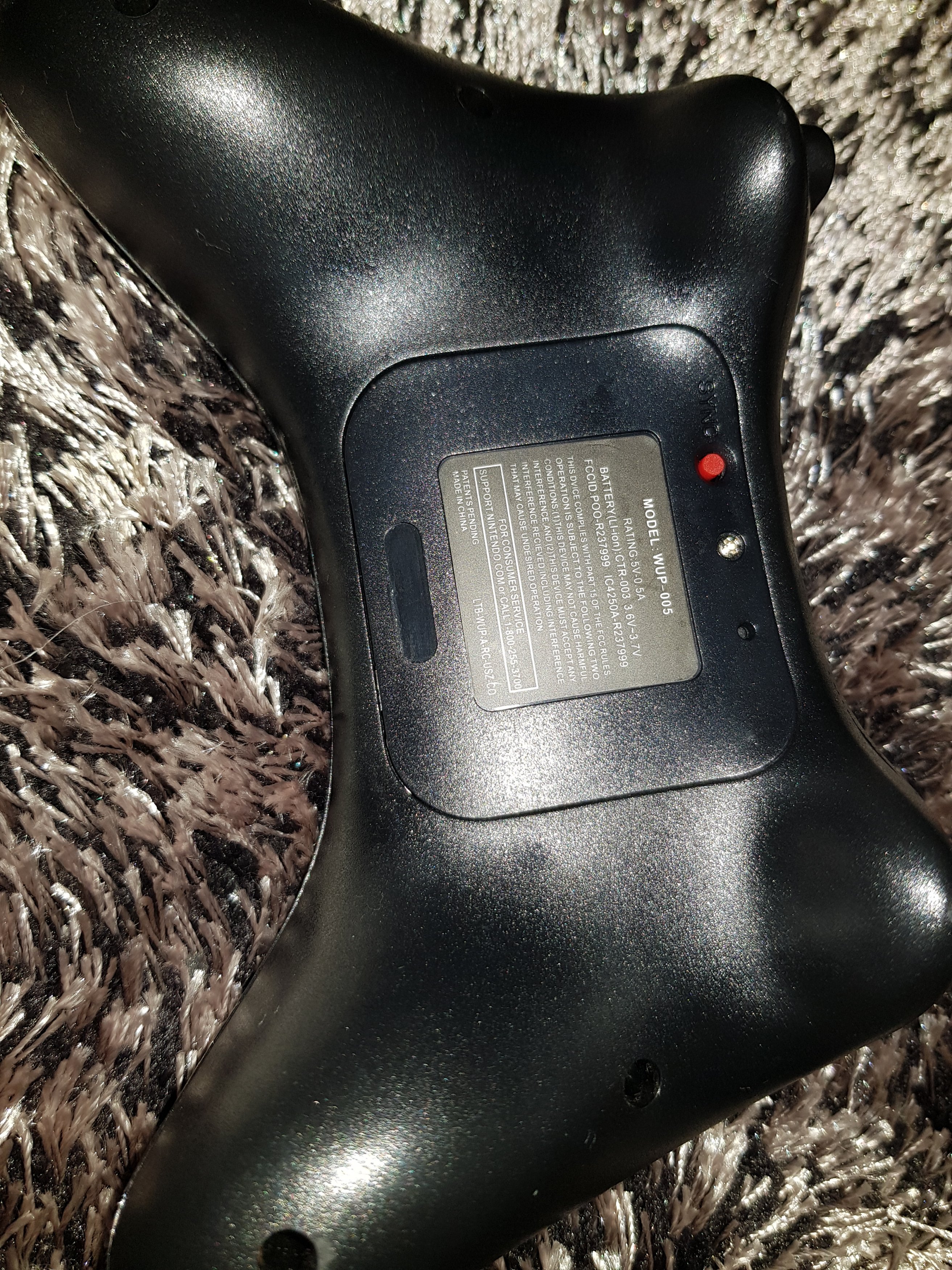

you sure its not a good fake? did you bought it new? did it come with the box?
what type of screws does it have? triwing screws or regular ones? take a picture of your batery cover on the back of the controller.

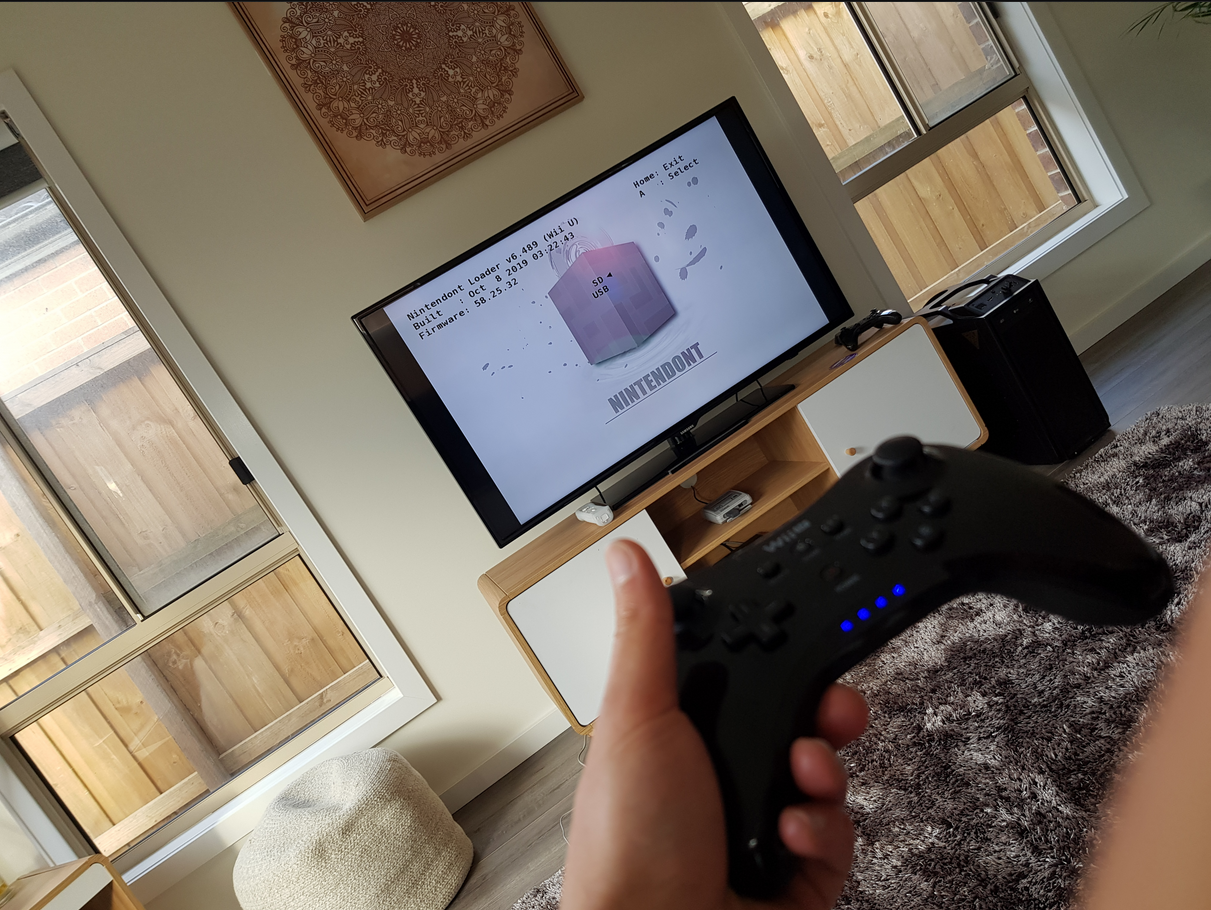

I have exhausted all above options and am reaching out once more.
WUPC disconnects as soon as I open vWii homebrew channel or any vWii homebrew for the matter. Wii mote stays sync'd as player 2.

It seems you have a counterfeit Wii U pro controller, look at the power button in the image, the red power icon is not centered and the joysticks look very different compared to the original. Nintendont is very picky with non official controllers sadly.
now that you say it i see it too, his power buttons inst even centered on the controller, and i bet all his screws are all normal screws and not trywing screws that nintendo uses, its a fake controller for sure.
So yeah fake ass controllers usualy dont work on nintendont or homebrew in general, never buy fakes, get official ones.

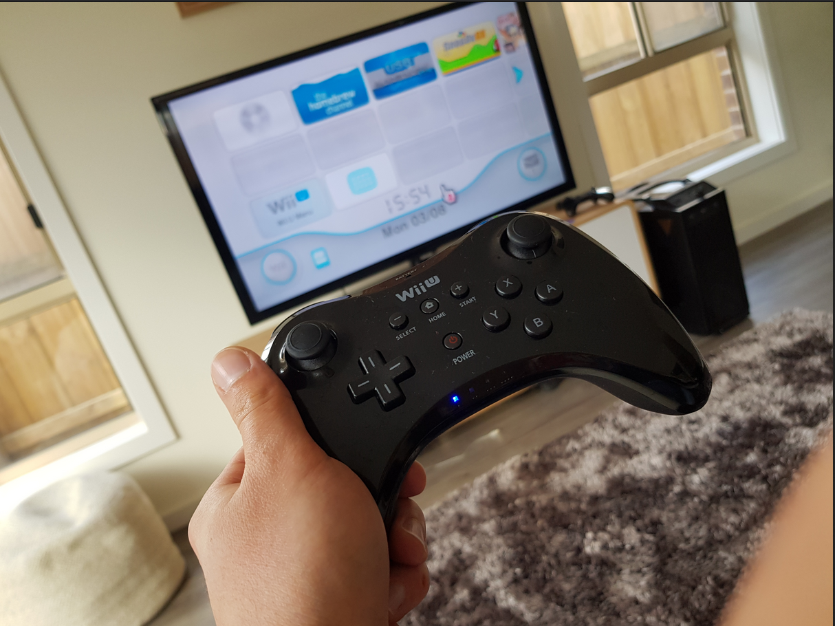

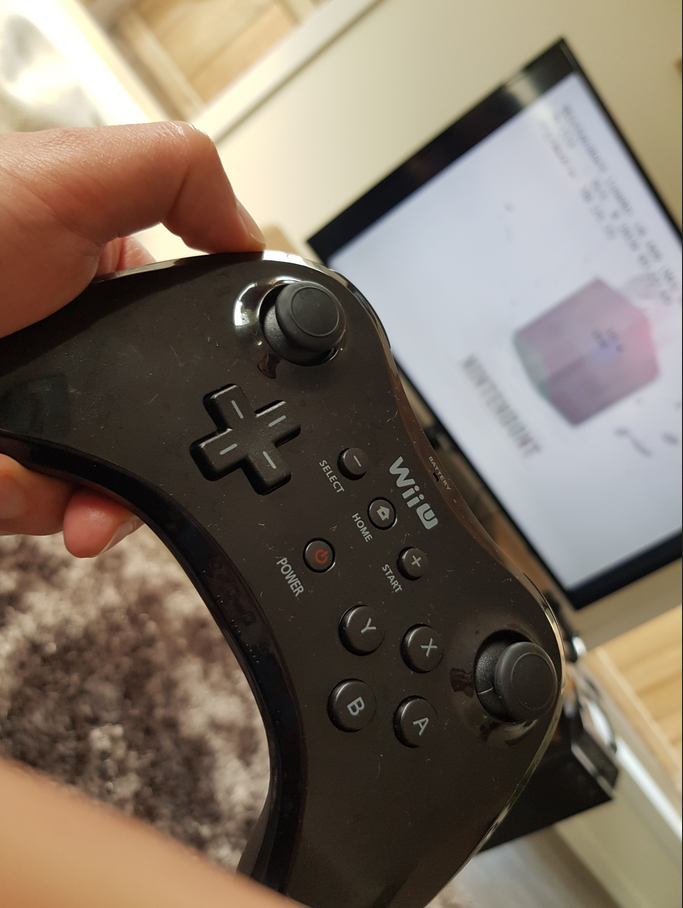

Hey all,
Thanks for the reaponse, however I'm not entirely convinced my controller is fake from a print of the power icon.
I've attached another close photo for your inspection.
Can you provide any other clues/deductions which would be indicative of whether it is genuine or not?
For those asking, these controllers were included in my score from Gumtree.
Have done a google image search of official WUPC and my controller is identical. Not sure what you're on about with the joysticks?

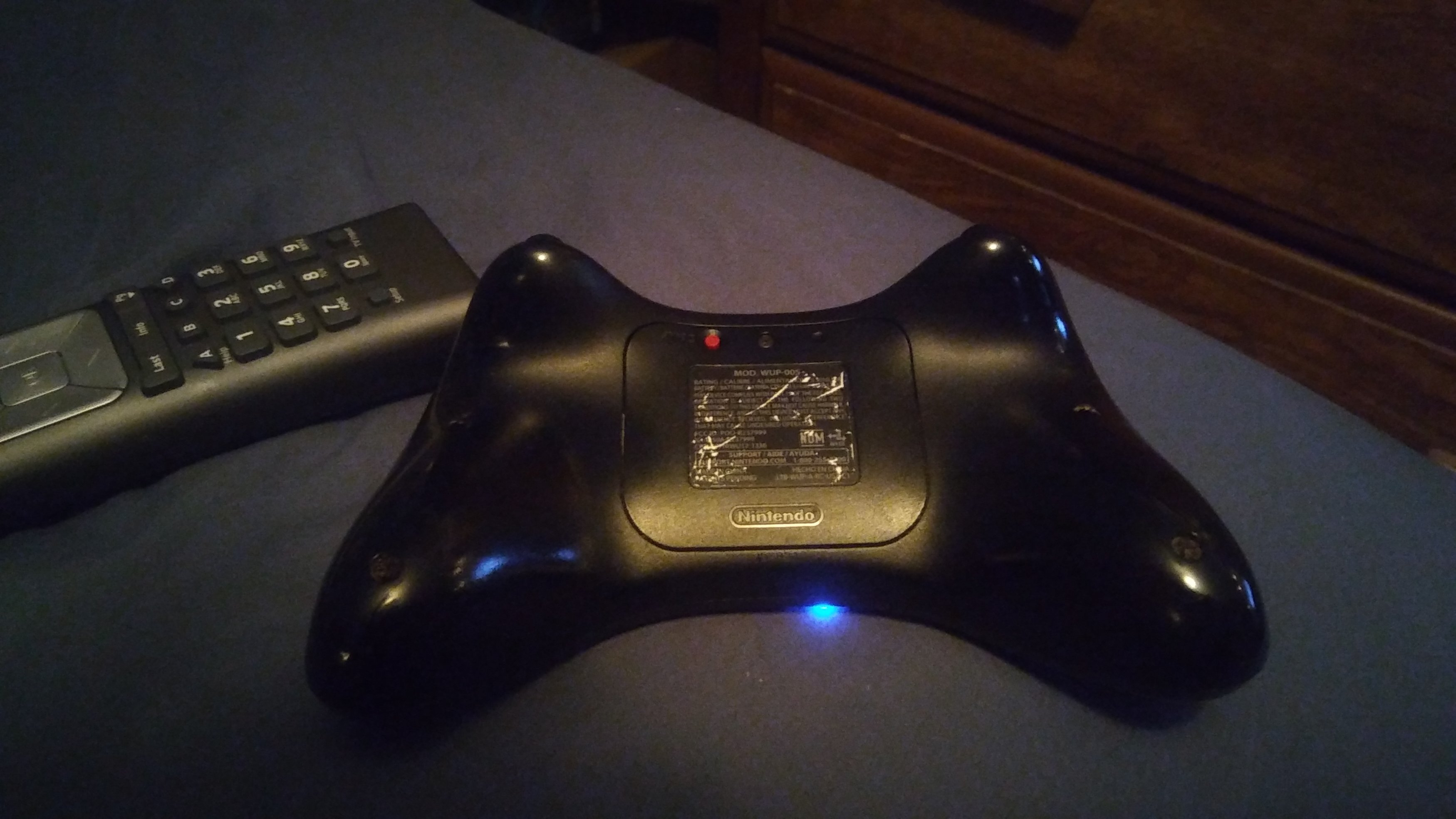

could be smudged off. my wii u model number sticker is scratched up. anyway, the part right below it, the elongated oval, it should say nintendo in the center of it.
like this. I have my wii u pro controller out, since I'm playing tropical freeze:

fake controller for sure, the space should say nintendo under the sticker and says nothing, also your sticker is nothing like the original stickers.

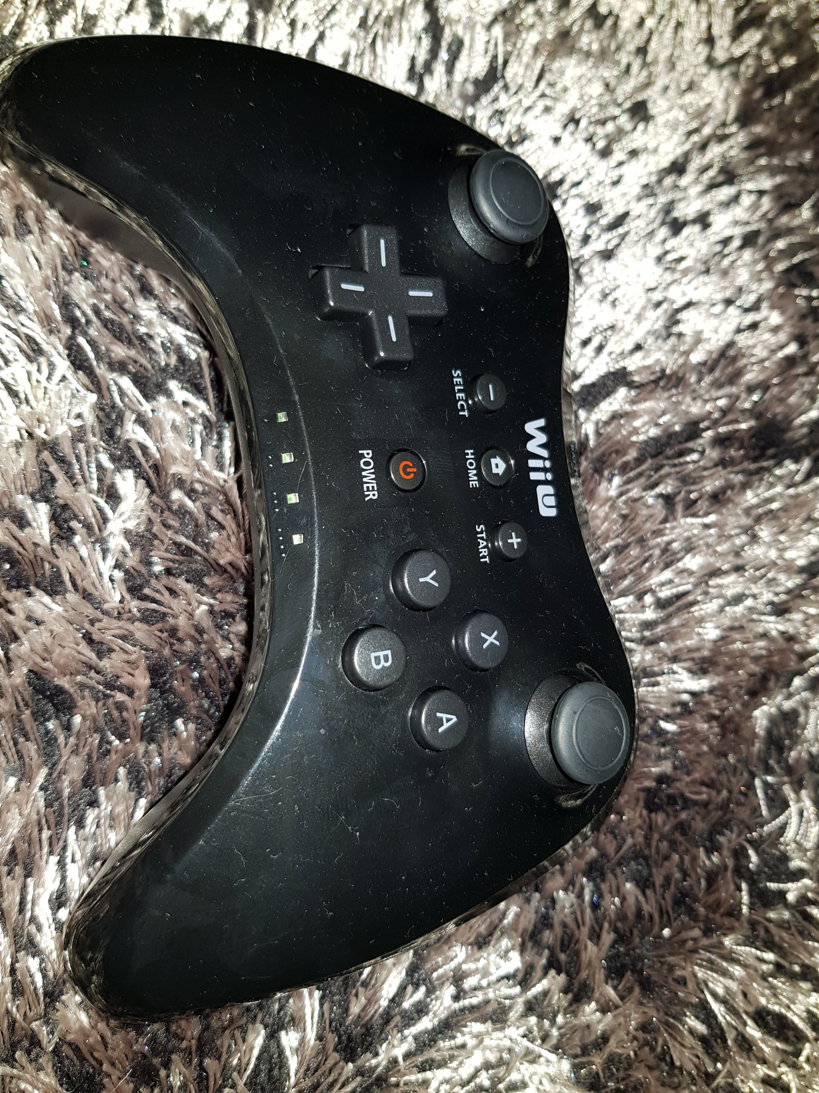

Hello everyone. I just got a wii u and i cant get this damn pro controller to work in nintendont.
Only my wii u part is hacked, not my vwii part.
whether I go directly through nintendont or through a game directly injected on the console it does not work, the controller automatically disconnects when launching nintendont or the game installed, and does not want to synchronize again.
Of course, the gamepad and the wiimote synchronize them.
Did I do something wrong? should i hack my vwii part? Or is my controller just wrong?
Please help me, I don't want to play gamecube games with the big gamepad. Thanks in advance.

that's the way my new pro controller looks. I have two black pro controllers, and the back text looks different between them. however, nintendont works with both of them.
Reactions: Cyroko
Thanks.
I even opened the controller when I got it to try and fix a button that wasn't clicking properly, and the battery inside appears to be official as well.
If the controller is good, where could my problem come from? do you have to hack the vwii part for this to work? Please thanks
