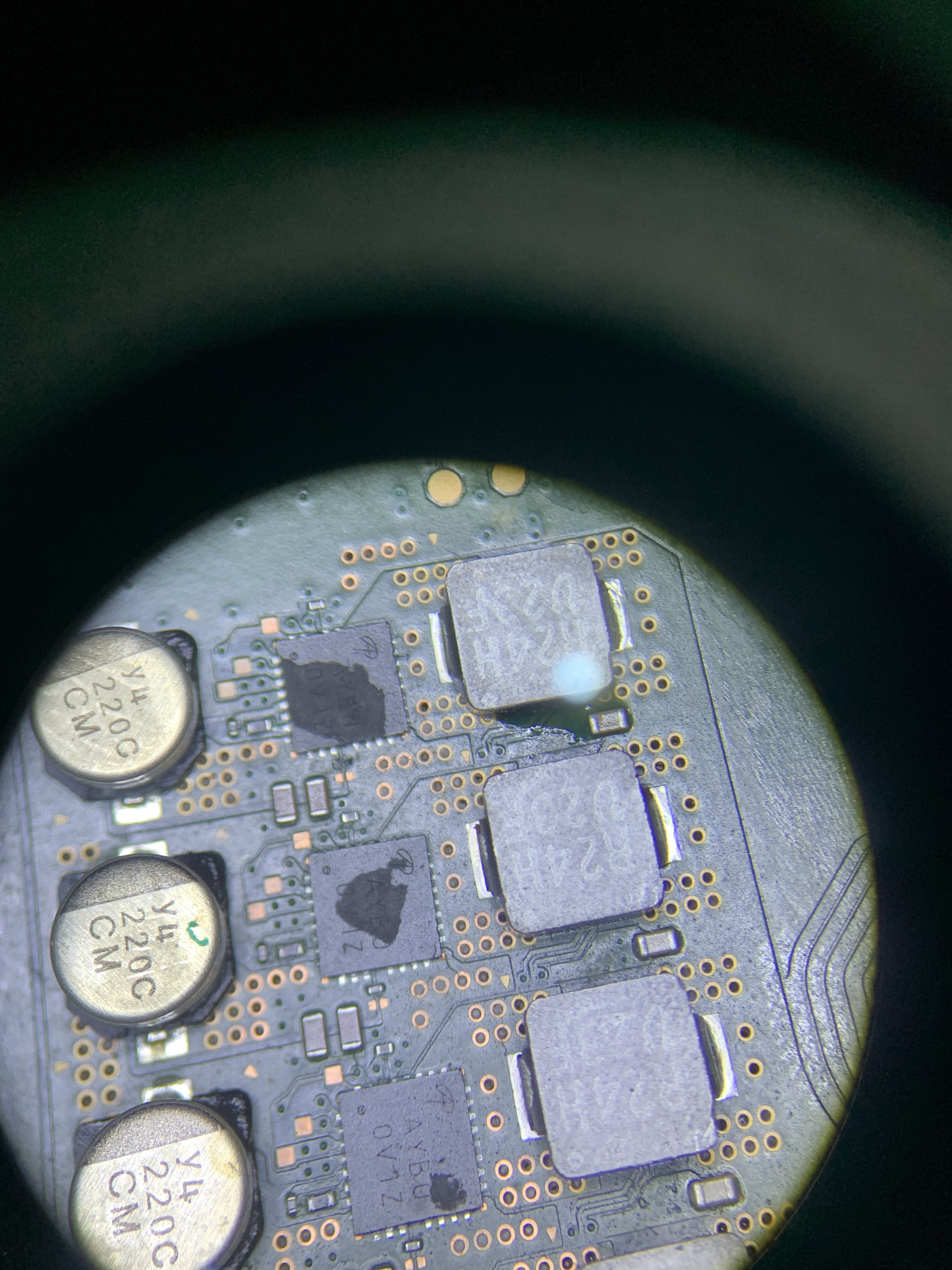

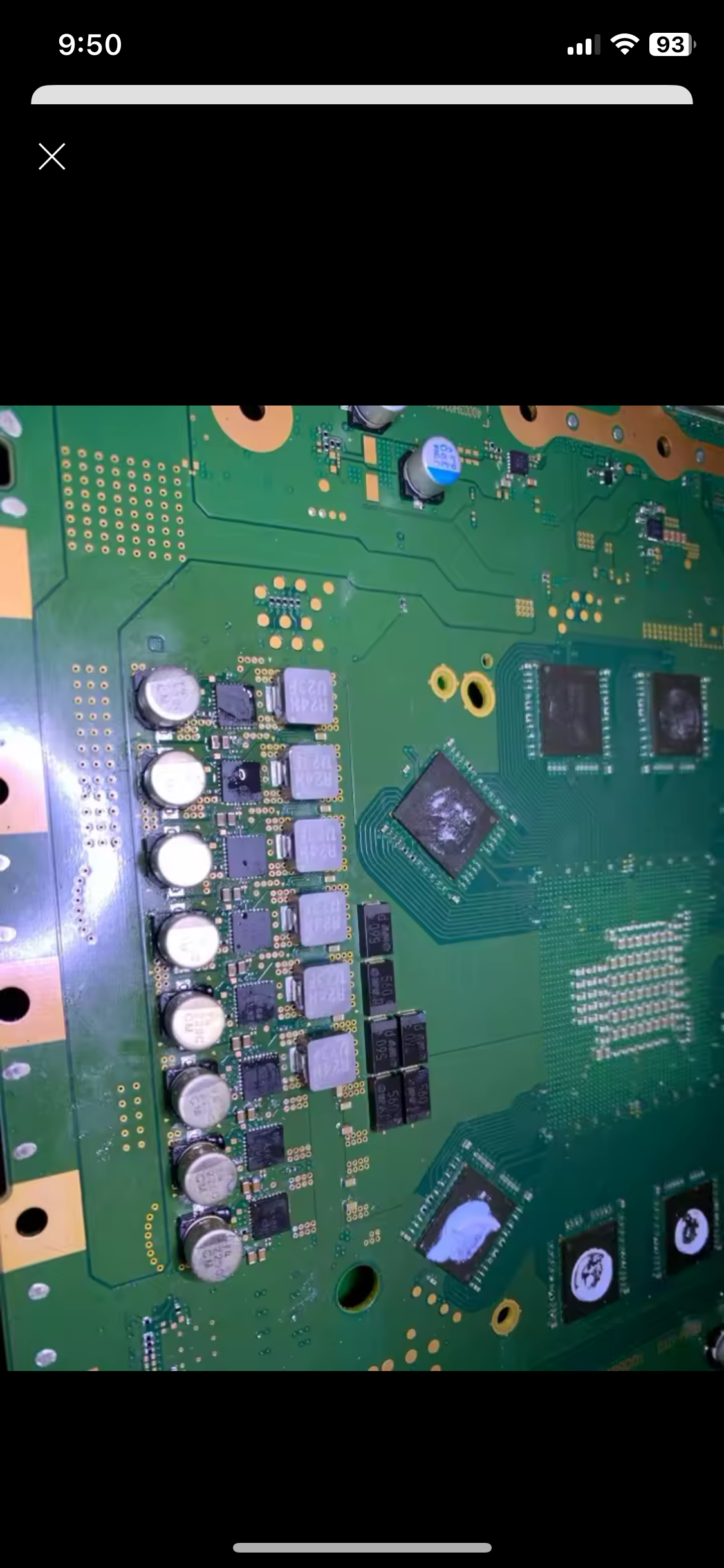

Could someone help me identify the value of the capacitor in the image and then what low price to buy them and what type of voltage is the capacitor?

The one next to the chip (with the arrow) and the one that is missing in your picture have the following specification :
ceramic 0.1uF/16v 0603 package
They are 'just' connected to the input power line of that regulator so anything close to that value will also do imho.
If you have a hard time ordering them, just grab such a capacitor from some other board.
0.1uF is a pretty standard value.
