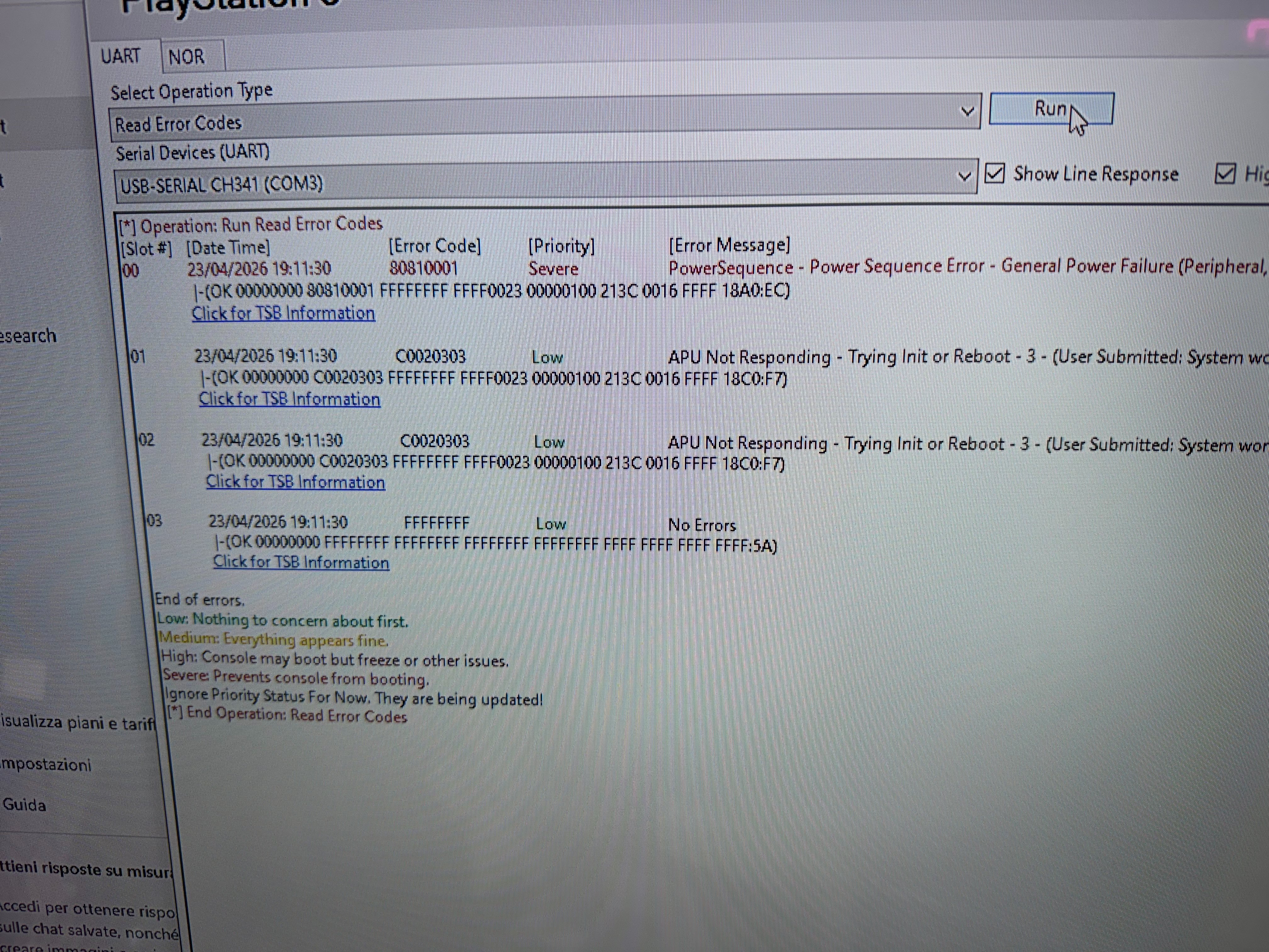

Hi everyone, I have a faulty PS5 in my hands: the string code is 213C. What exactly does it refer to?
I used to use Dony Tools GUI, but unfortunately my old desktop PC has died.
@stetofix, you might be the only person I know who could help me identify the problem.

SOLVED, the problem was in GDDR6 bank n°7, it was completely short-circuited. The strange thing is that after removing it and replacing it, I started getting 8080110E on banks 1, 2, 3, 4, 5, 6, and 8. I had to replace them all to fix it permanently.
