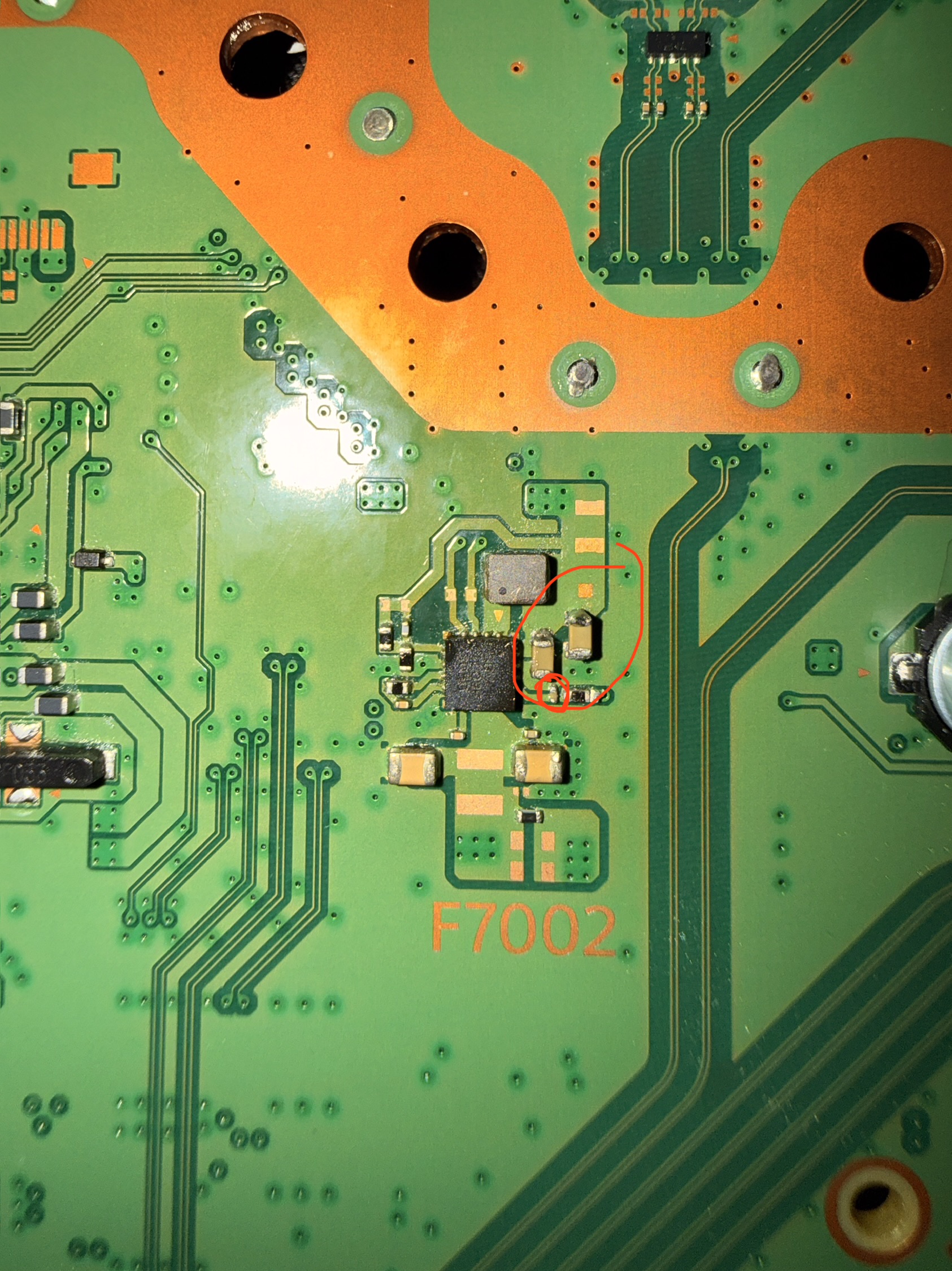

Also, is it an issue to reflow components using 138°C solder
Not an issue but 138C wont do anything. You might need 381C instead.
Is it problematic to replace capacitors solely based on size and color, or do you have any suggestions to improve this repair?
why dont you circle the caps area you need and upload the picture here?
FYI the component you circled in the picture is a 1uH inductor
Thanks for your reply.
For the capacitors, I used low-temperature solder (138 °C), which is much easier to work with. I was wondering if this could cause any issues.
As for the two capacitors I replaced, I took them from an EDM030 donor board, choosing ones of the same color and size, located in the 7002 area.
Could this be a problem? I’m concerned they might not have the same value.
WHY dont you measure the value before you put them in the circuit? They should be 22uF if I remember correctly.
Low melt solder(Bi involved) is not recommended for high heat application.(console gets more than 60C often, unlike smart phones)
My multimeter can’t measure µF… Am I taking a risk by doing this?
I’ll redo the soldering, but I’m waiting to receive my leaded solder first
Get a cheap-ass capacitor/inductance meter from Ali or Amazon.
They are like $15.
Note that the component you encircled in your opening post is the inductor in the schema that jkyoho was so kind to provide.

Thank you for your advice!
I’m going to buy a capacitance meter. In my case, both are dead, so it’s difficult to measure them. I’ll replace them with 22 µF ones (according to jkyoho). Does the 0603 size seem appropriate to you?
Yes, 0603 imperial is the right size, and you should order 22uF_6.3v_0603 specs since they are on the 3.3v_standby rail.
FYI, the resistor below 2caps looks broken solder on the right.
Indeed, in the photo, it looks like the solder joint is broken. I’ll take a closer look.
Regarding the small capacitor near the resistor, do you know its size and value? If I also need to replace the resistor, I’m afraid of losing it.

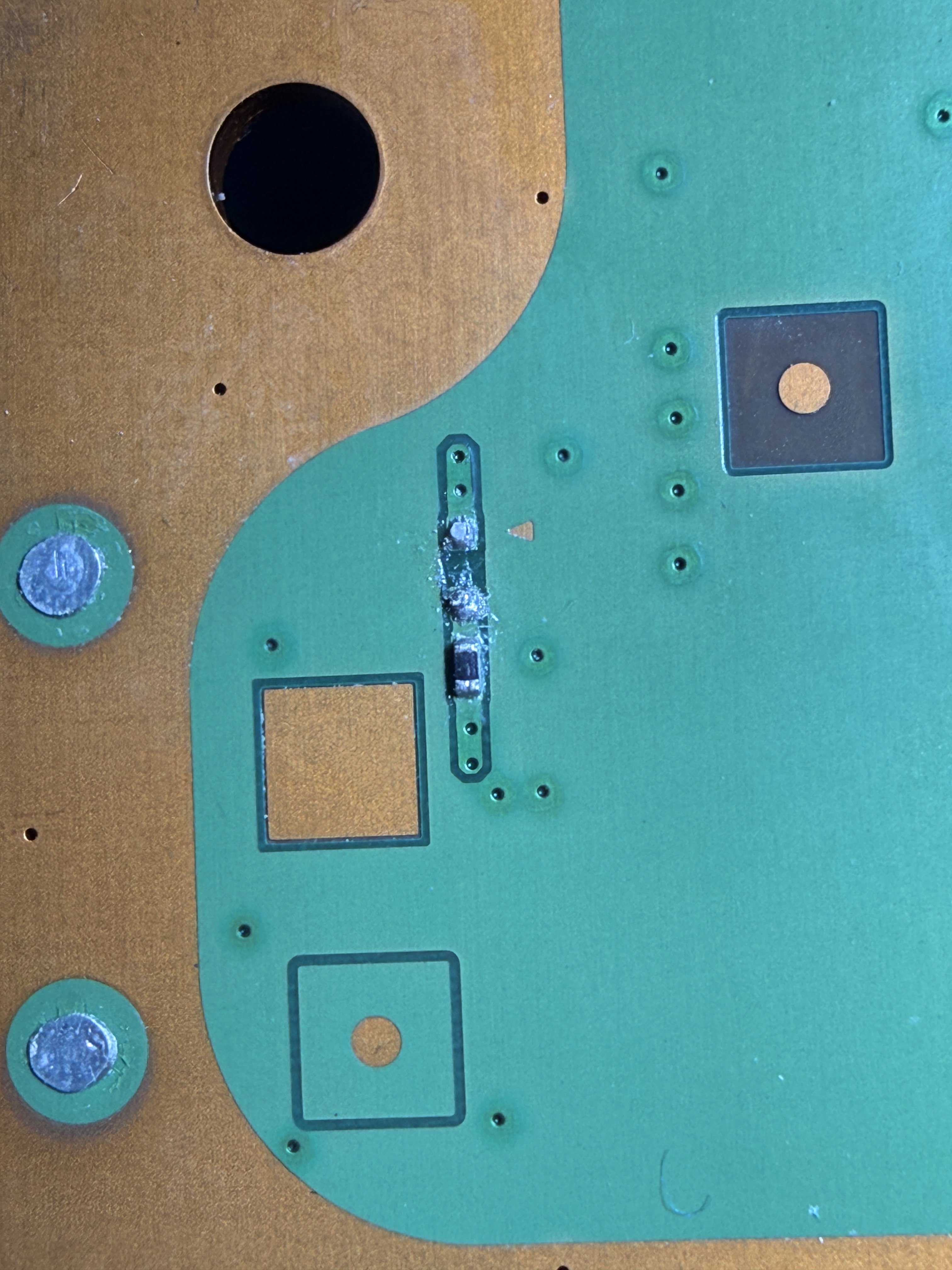

Hey guys,
Yesterday, I replaced the Wi-Fi chip — everything went smoothly, and there’s no more short circuit in that area.
After that, I reassembled the console: it powered on for a second with a blue light, then turned off. So I decided to take it apart again to check the motherboard.
I didn’t find any short circuits. I tried turning it on again, but this time there was no beep or blue light.
I have 5V present, but the 3.3V is missing.
Do you think this could be caused by the inductor I replaced?
I also noticed that a component related to the BIOS battery is missing (see photo).
Any ideas?
