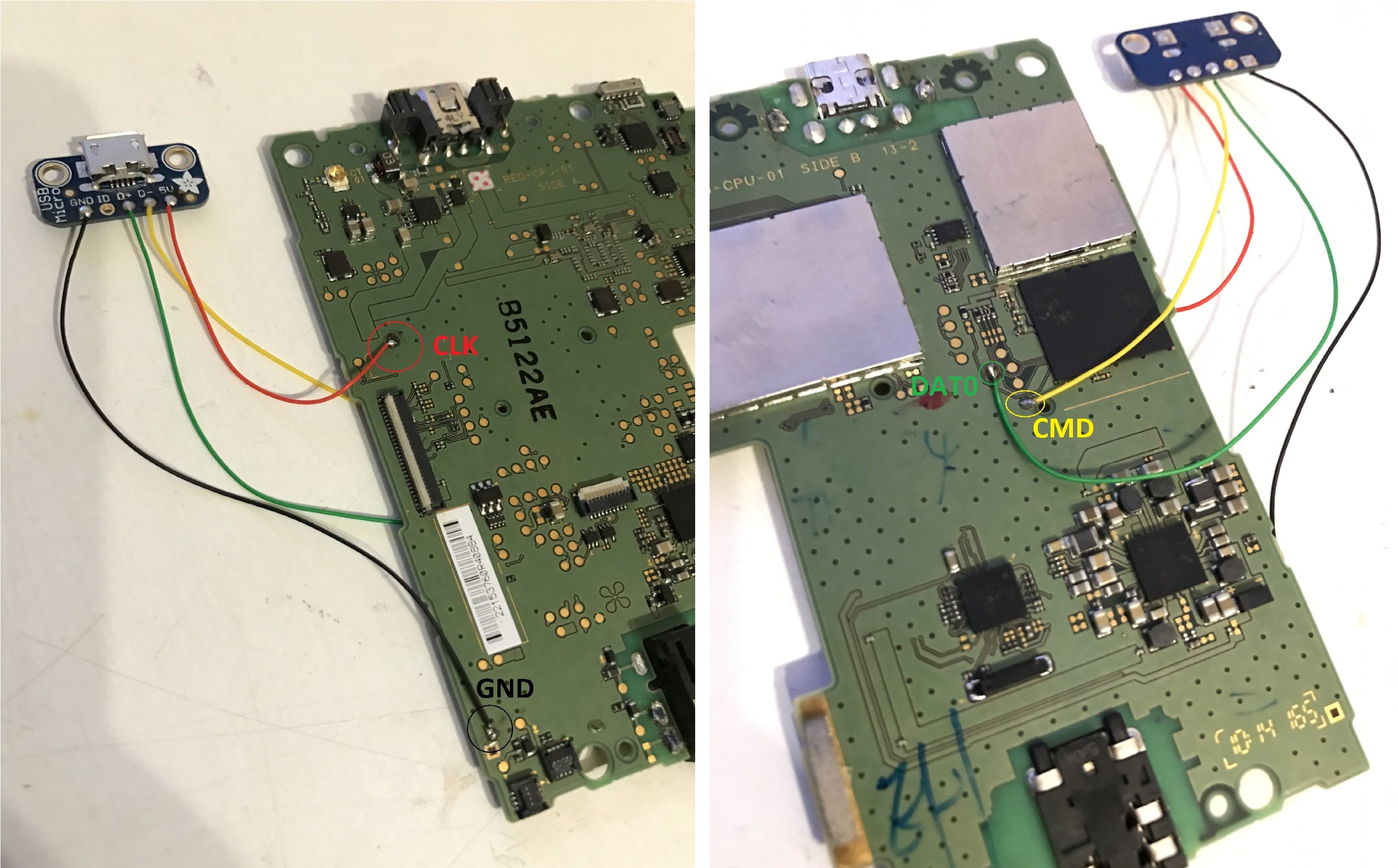

please don't tell me you've tried to solder 8 wires just for a single downgrade? this video guide is idiotic, all you need is 4 wires, the other 4 will just increase speed while downgrading but the risk of fkn up the hard mod are so much higher with soldering those 8 wires, i only use 4 and i get 5.8mb a second if that's not fast enough you have some issues :s, all you needed was, clk, cmd, gnd and dat0. nothing more. also there is a clk on the other side of the board which is 10x easyer to solder to. this guide is really bad...
this is how you should have done it:
the usb port is not needed, but those 4 spots were all you needed

I only mounted the four wires needed. I initially mounted the GND where he had it but it would not hold, and after four attempts to solder it where he had it I just stuck it to the outside casing of the cartridge slot (metal). Would mounting the wires even matter though? I never even got to the next step, my DS just stopped working after I took the wires off.
Edit: I also want to mention that I tried to mount the CLK on the back of the board, where the four little pins are located and failed that a few times, so I had to re-mount on the alternate CLK, on the front. Could damage to the CLK points cause the unit not to turn on at all, including not having any LEDs work?

iirc if you put the battery in backwards it blows the board, not 100% sure but I seem to remember someone else did that and their board was dead even after replacing fuses
EDIT: nvm I see someone dug up another thread on this and it was just the fuse on the daughter board :) good luck
