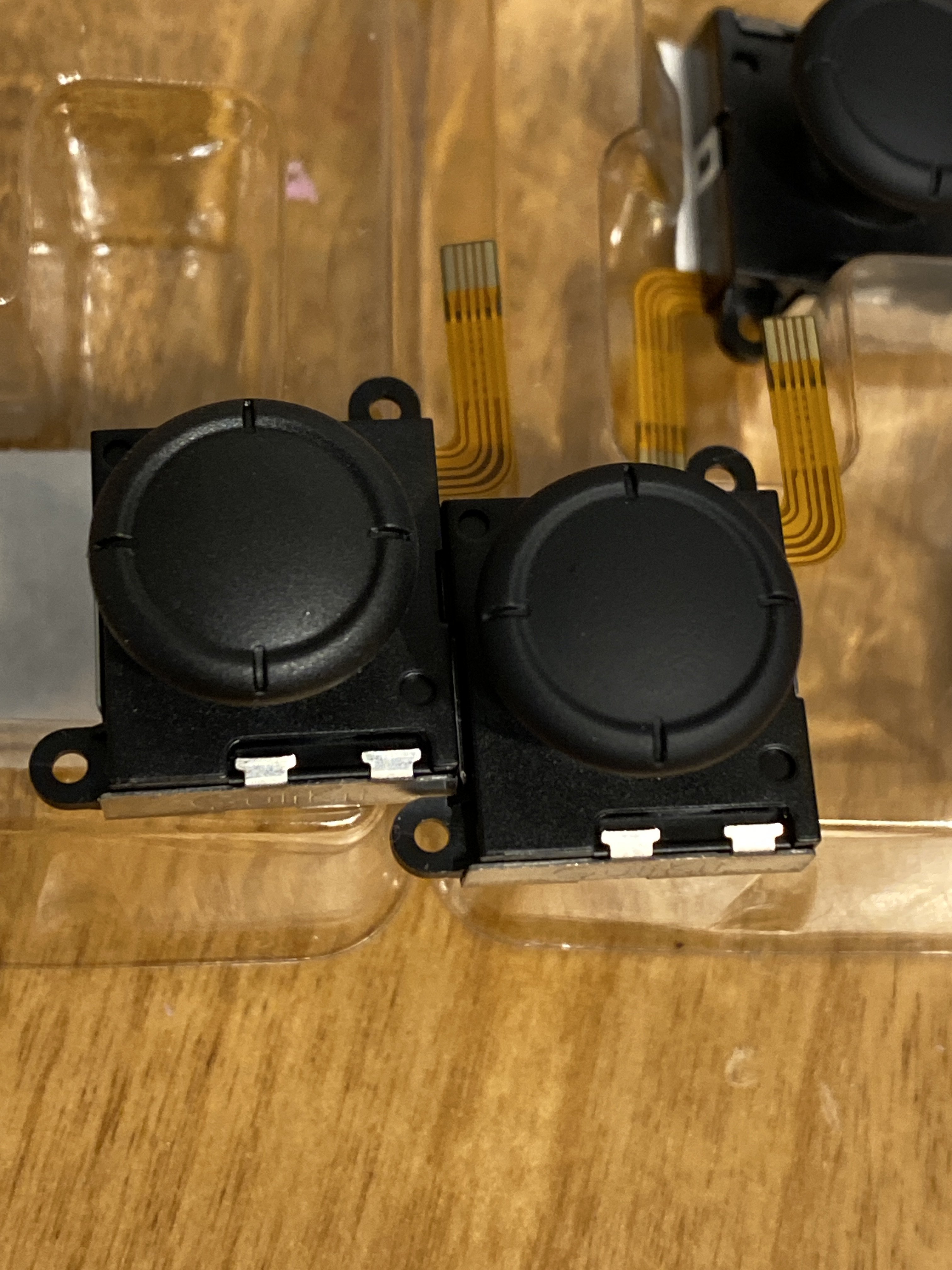

@AKNES I kept these from an older AliExpress order, only 2 pair had these what I feel are improved caps, any idea if they will ever move fully to these. Image for comparison, the right pair are a lot less slick.

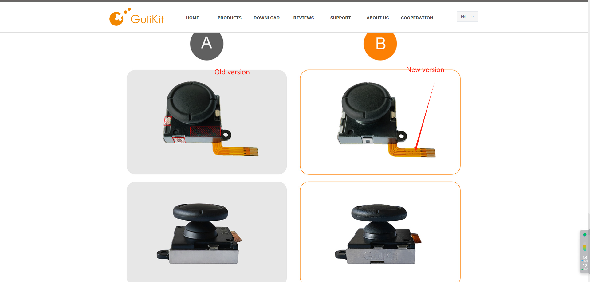

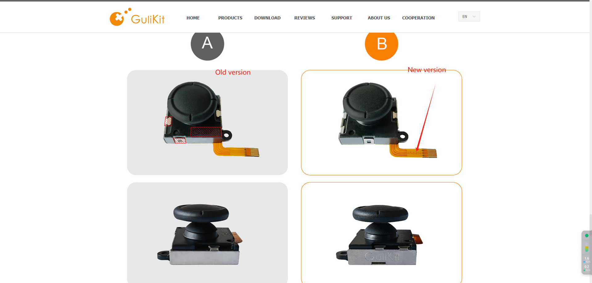

You can take a look, the one on the left is the old version and the one on the right is the new version. If you have both versions, you can easily tell them apart from the pictures.
There should be new versions on the market now. If you still buy the product on the left in the near future, it may be the seller's old inventory.
Thank you! Both are the new version, but the caps are still different, not a big issue but I do like the new version! I’ve had a lot less issues.

1. In fact, there is no functional difference, except that the gap has become smaller, and the material of the joystick cap has been changed.
2. Later products in the old version basically solved the "click" problem. However, since the early and late stages of the old version cannot be directly distinguished, this makes users more anxious about whether the old version is equivalent to the inferior version. In fact, it is not.
To sum up, no matter the old version or the new version, only the material of the joystick cap has been changed, and the gap has become smaller. As long as you encounter product problems, no matter the old or new version, you can seek after-sales support from the seller.
As for stickers, both old and new versions need to use them to eliminate gaps. On the AKNES Amazon link, you can find picture or video to learn how to use stickers. Pull out the cap, put a ring-shaped sticker on it, put the cap back on, and that's it.

We have not changed the packaging or pictures, but GuliKit has added pictures of the differences between the old and new versions on the official website. It's true that there are very few older versions out there, so we don't think it's very important. And for AKNES, we provide after-sales support whenever there are product issues.
