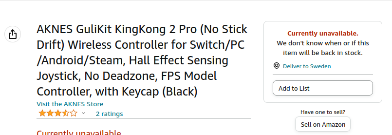

@AKNES sorry for tiny bit off-topic. But the Zen Pro. Is it available somewhere in the EU? I can't find it.
Reactions: AKNES
Actually Zen Pro is just a different color to Kingkong 2 pro.
This is a version customized for offline dealers, which is different from the online version of kingkong 2 pro.
So if you don't mind, you can go and buy kingkong 2 pro on amazon.
If you don't mind, you can go to AKNES store to buy it, at least our service is quite advanced. (just as I'm promoting my brand, don't mind:grog:)

Oooooh.... I thought they were something new! Well then.
I checked your German store and it say it's out of stock.
Reactions: AKNES
It will come in the short time. You can buy the joysticks with kits(Not including the one without kits) on the GAMEROOM store on Amazon.us next weekend. They are the final solution without GAP.(The store also belong to AKNES)
Like I said above, buy from GAMEROOM store on Amazon.us next weekend. (The items with kits)
Is the one without gap in stock now?
