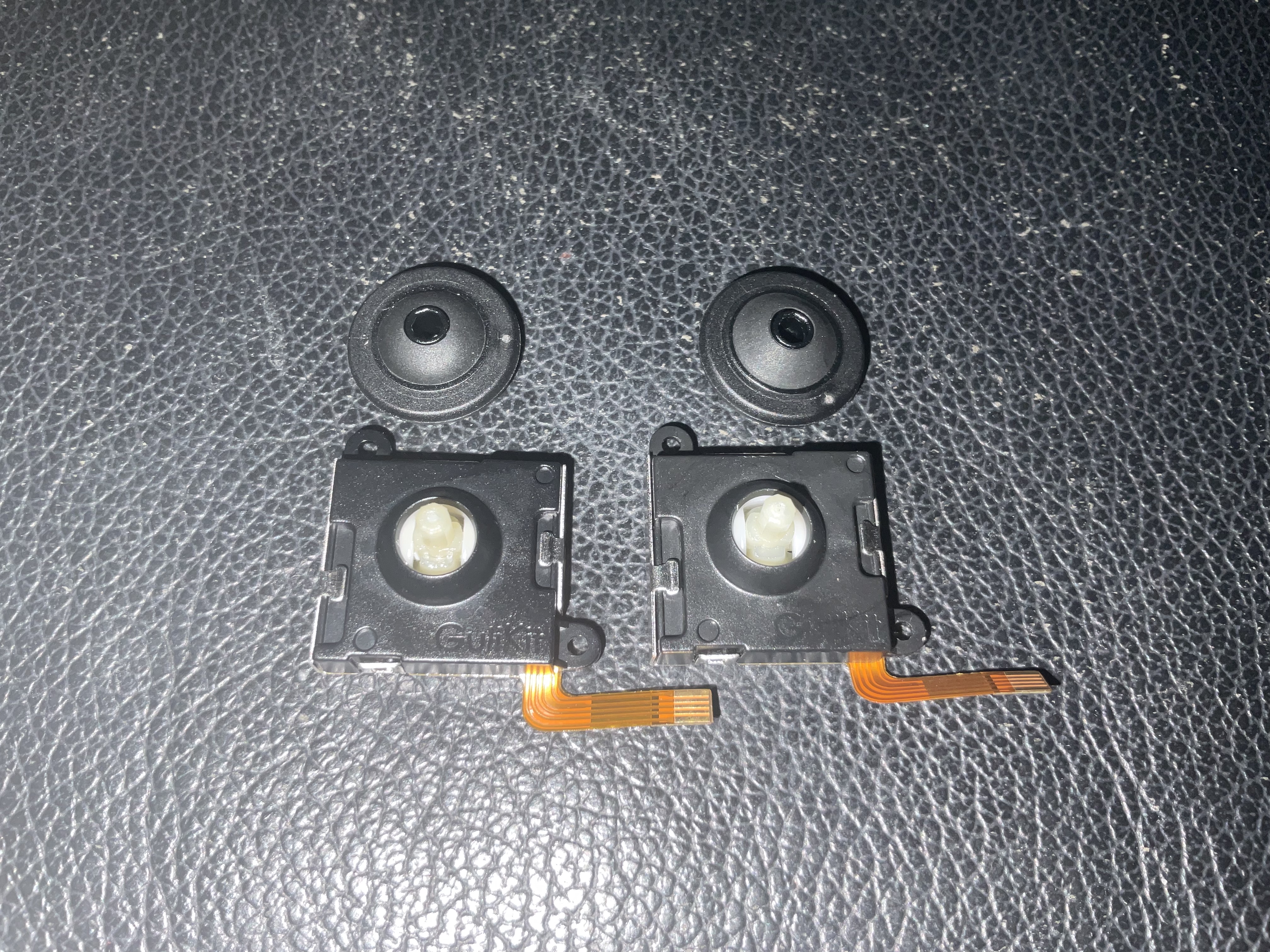

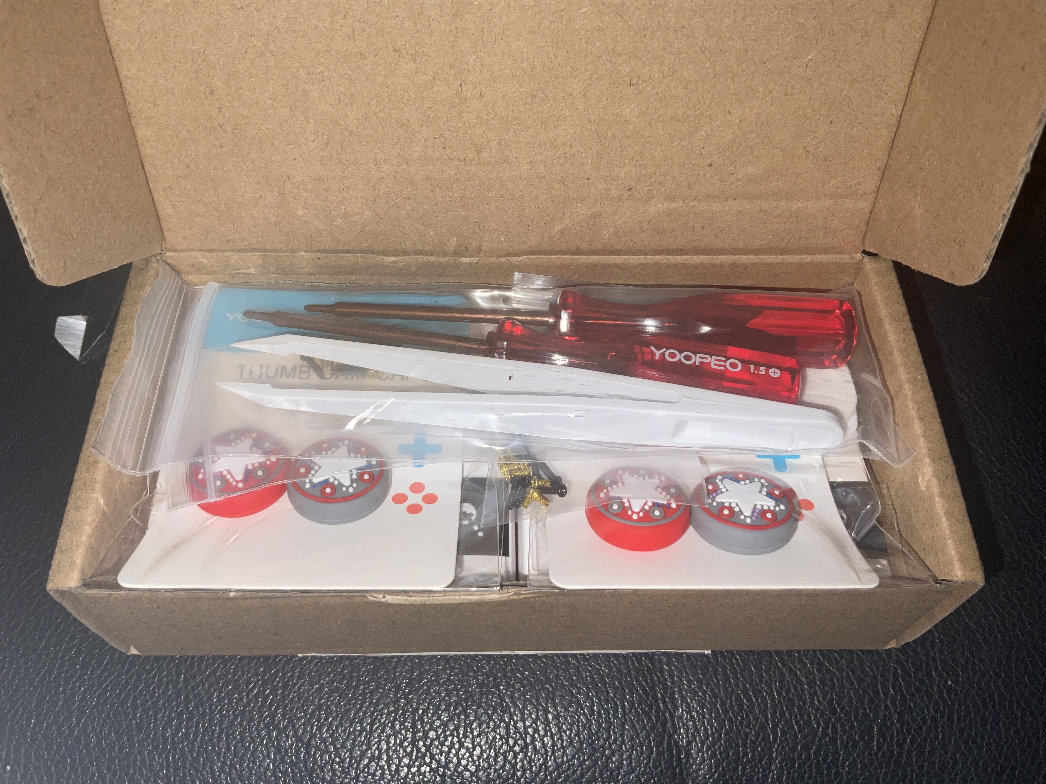

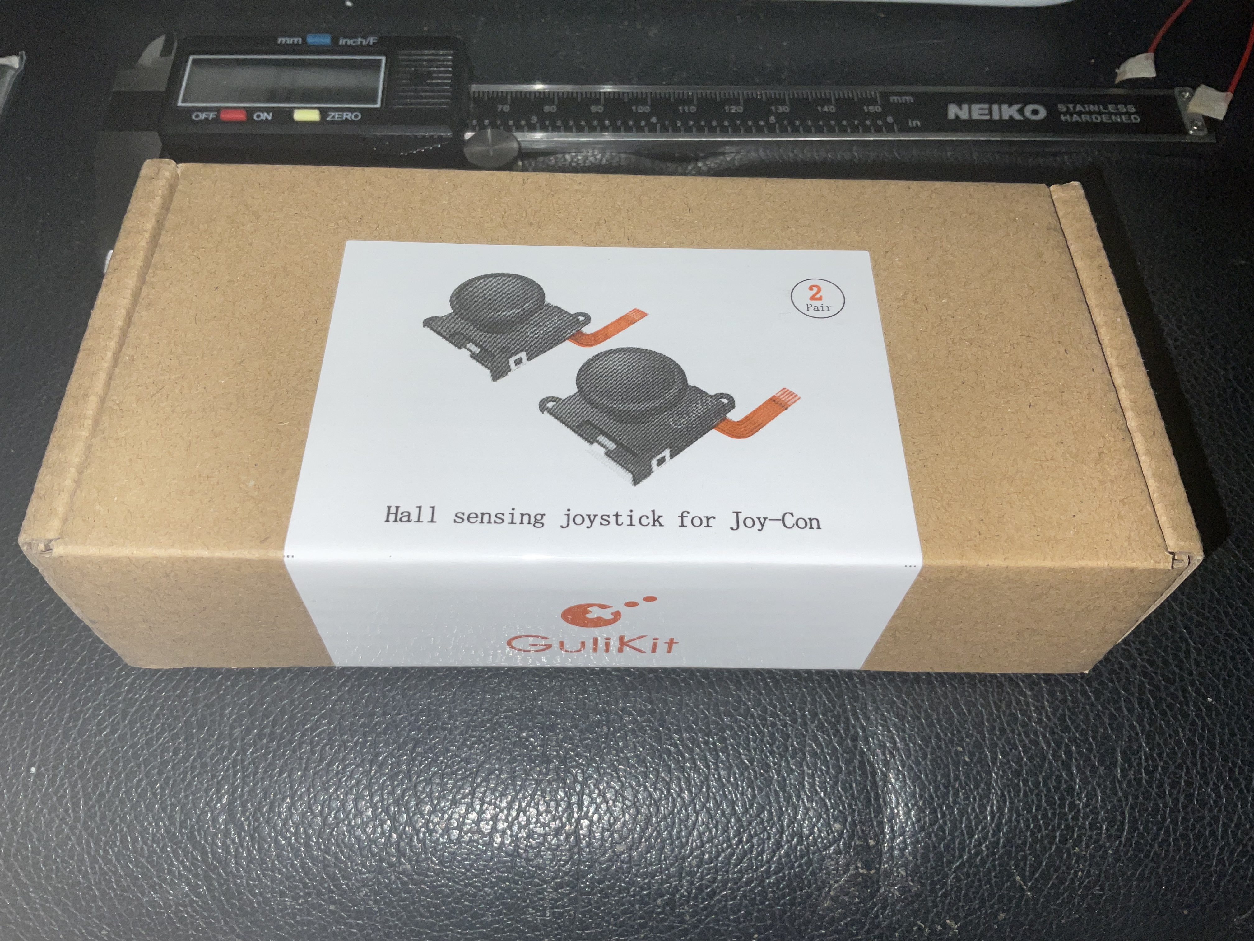

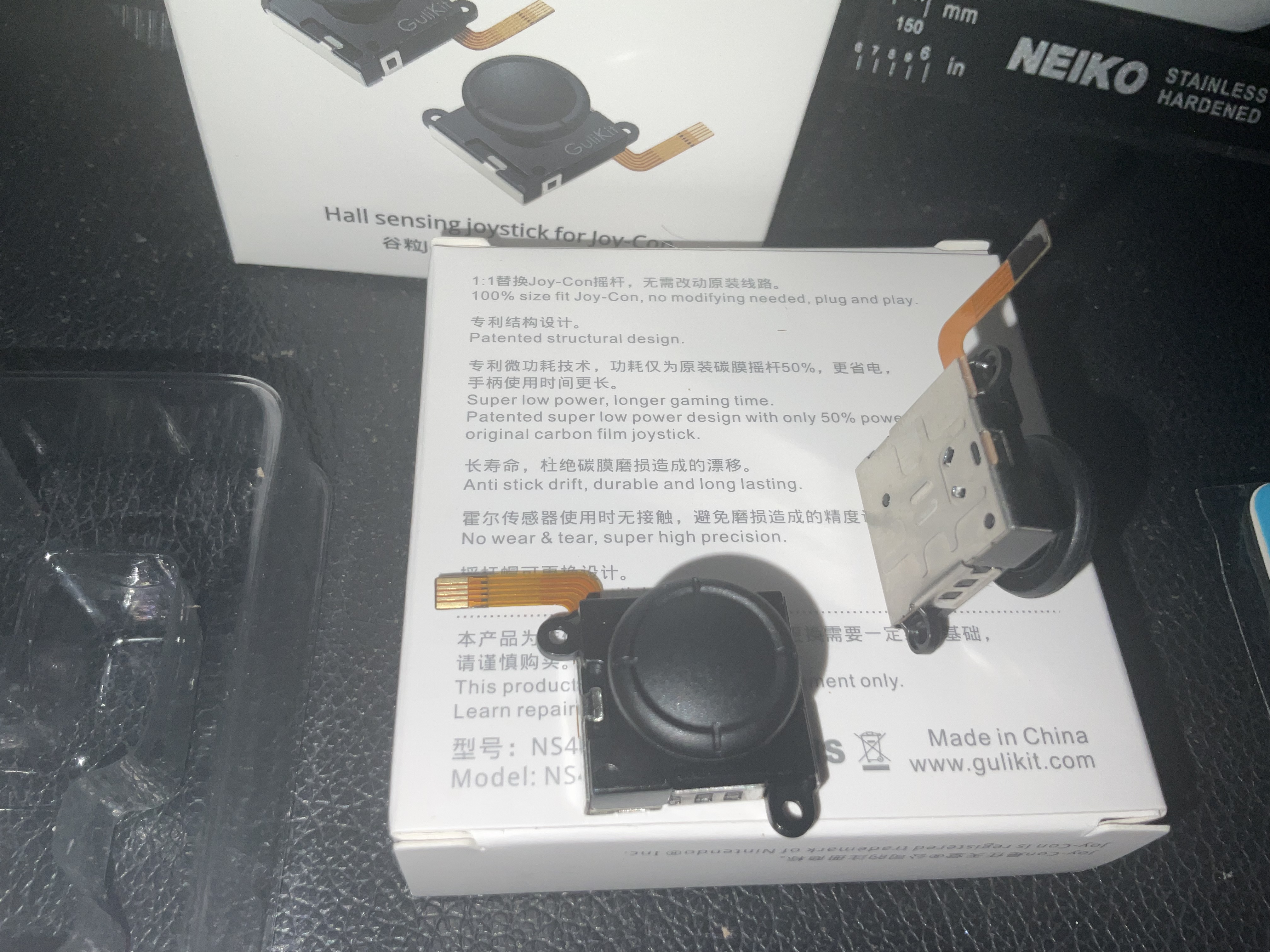

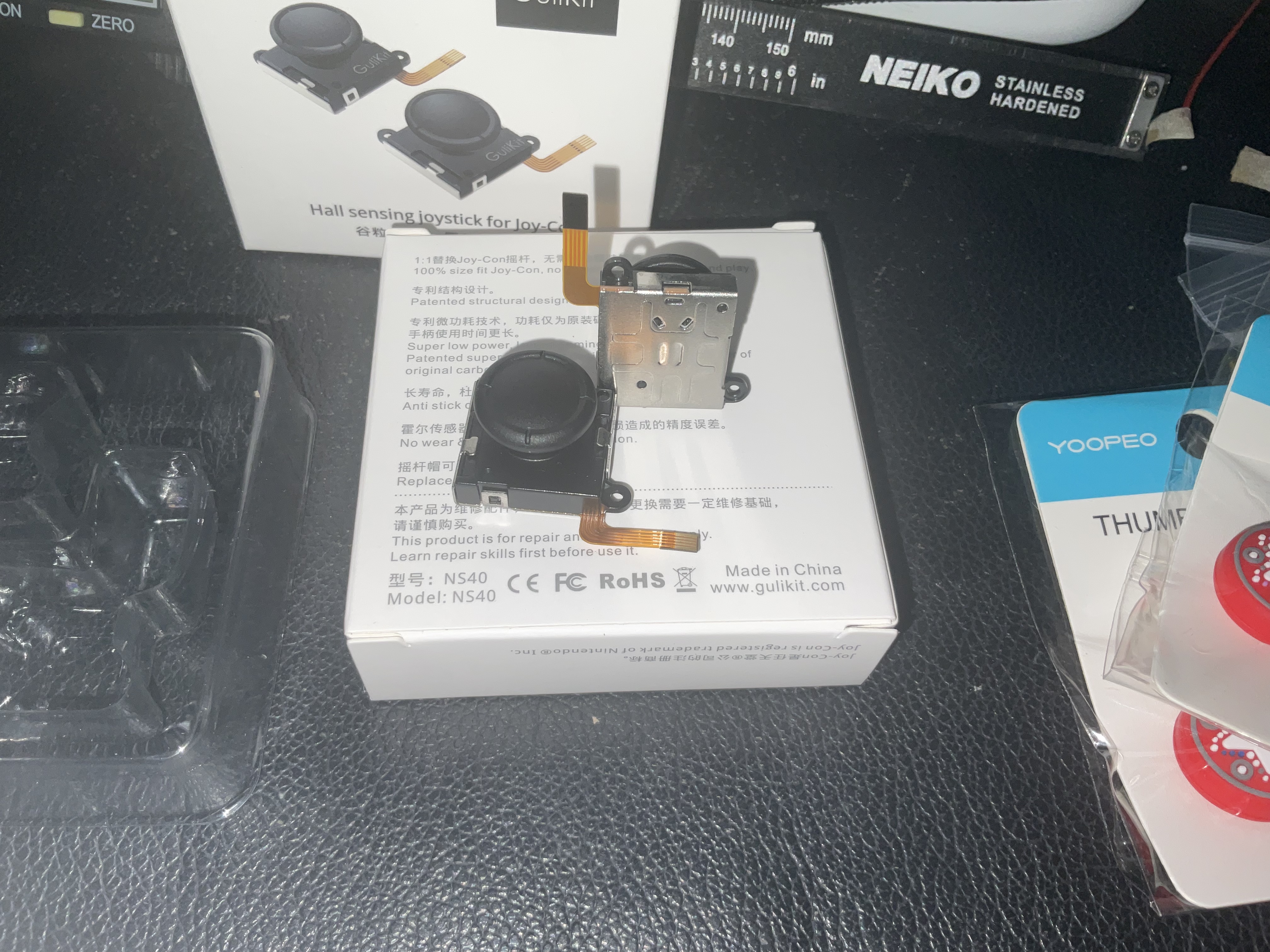

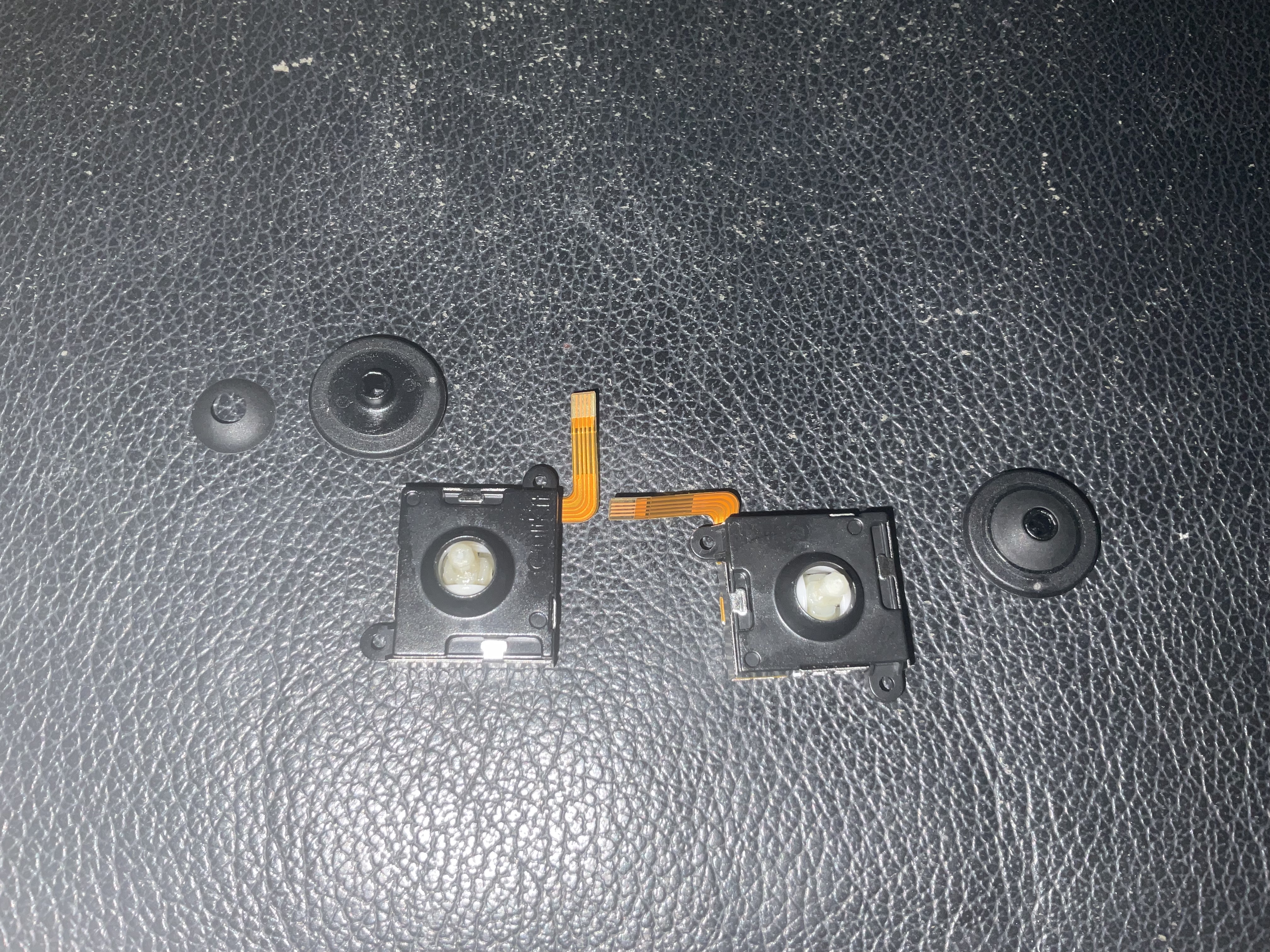

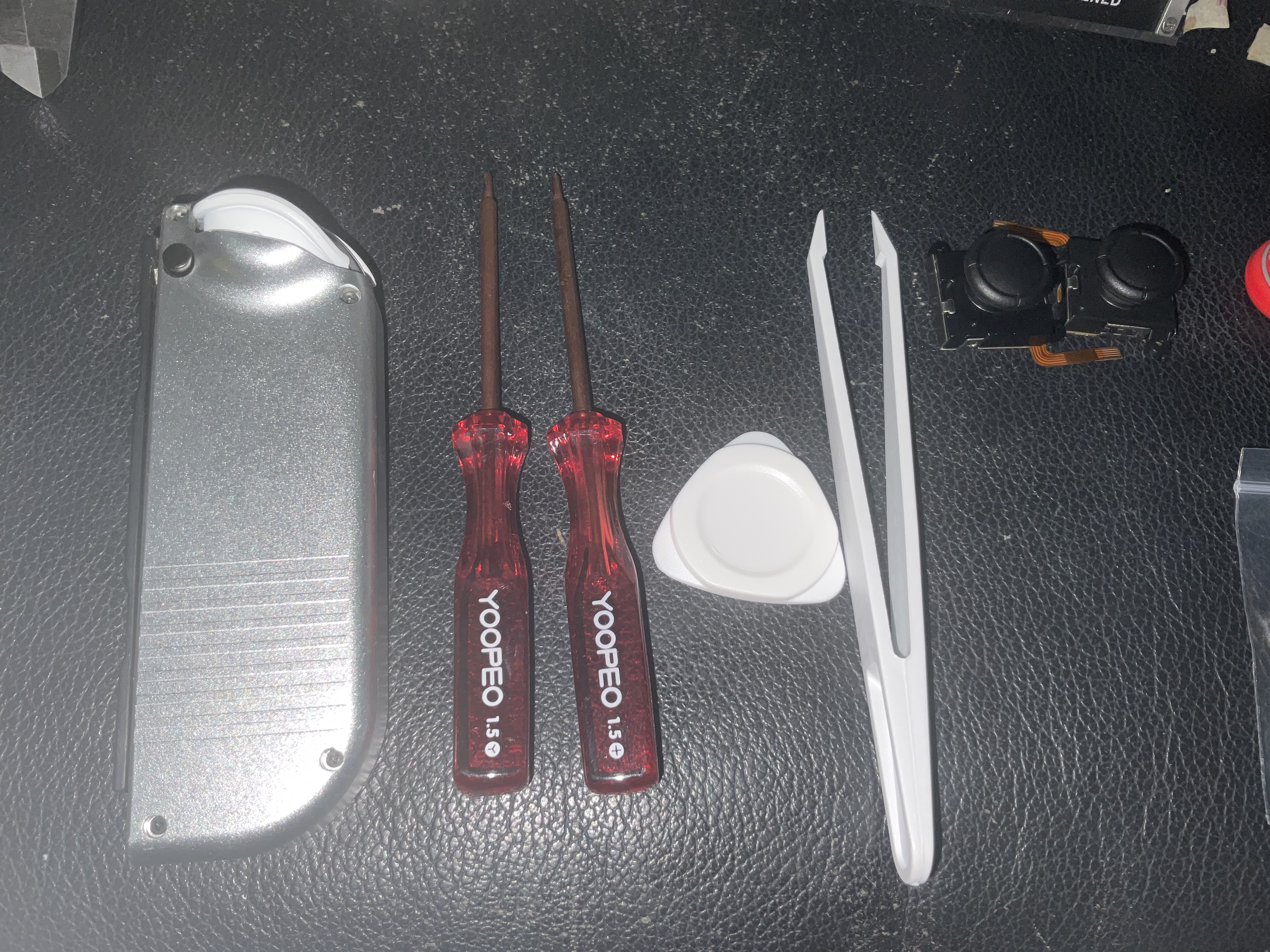

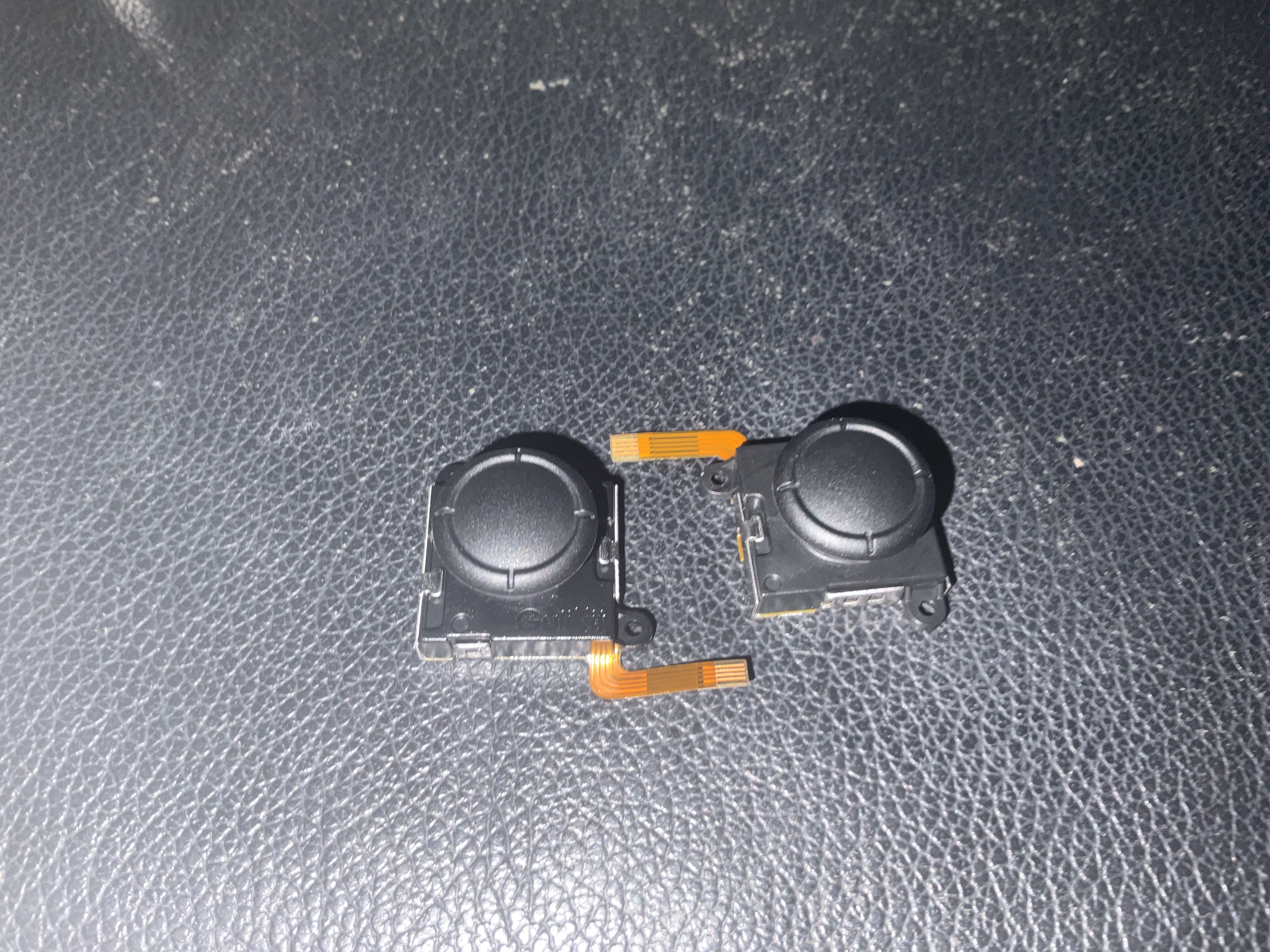

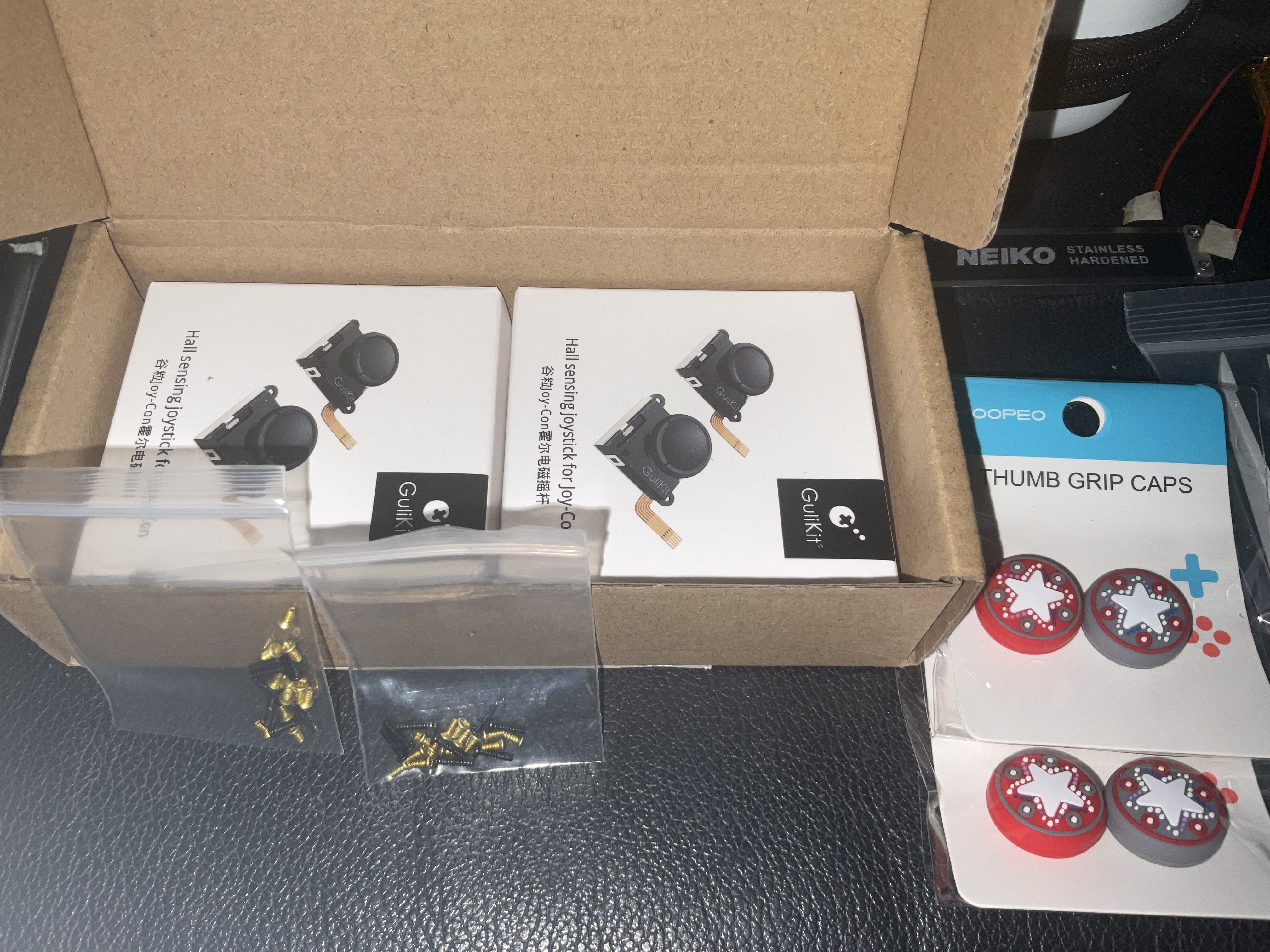

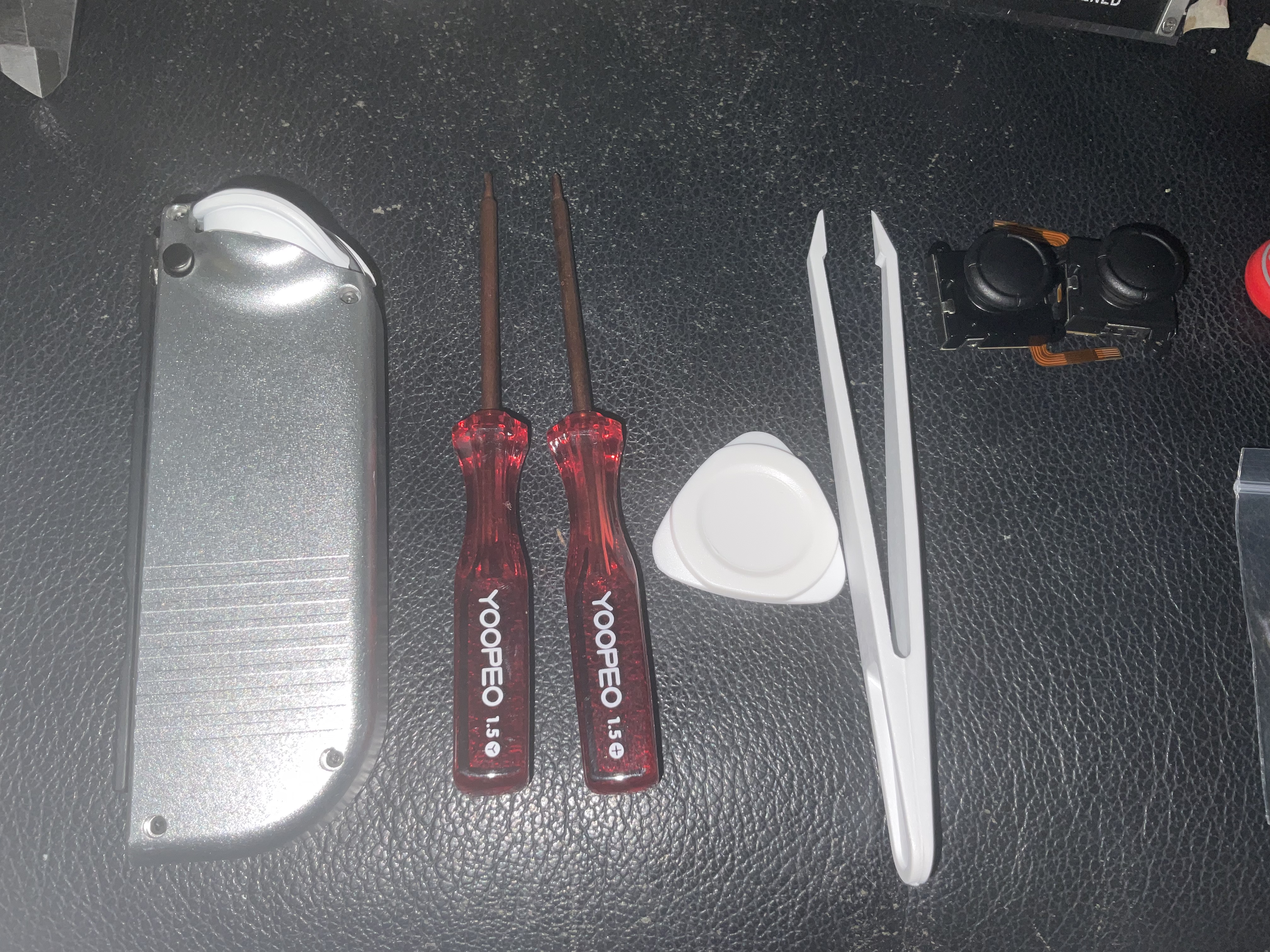

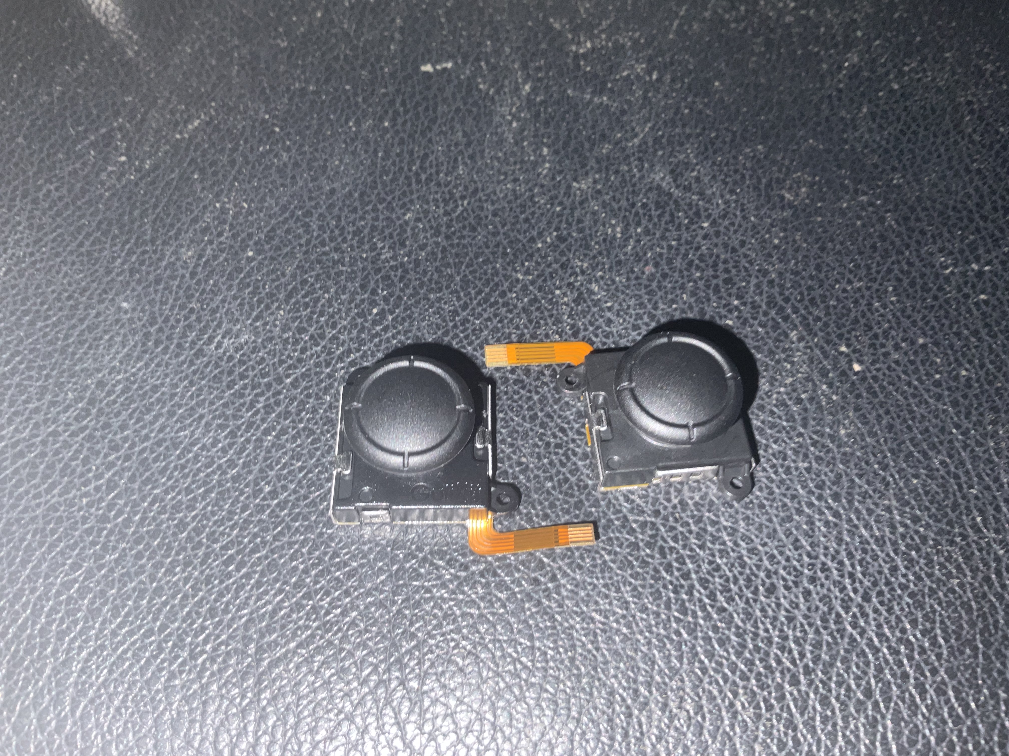

Here we go…strip of unboxing pics (sorry not gonna do a video, I’m not that pretty) and they we’ll get to work opening her up.
I’ll kick it off off with the real reason I bought the double pack!
enough joking around…enjoy!
3AE84716-3AAA-4CD2-92E3-92DB17E3724F.jpegDDADD6BA-6EBE-4EC4-8E79-9357A5D53784.jpeg997114AB-3580-4950-80D4-AAE31DF59E24.jpeg96BC72D3-1538-470D-AFE5-7B1372D927E3.jpegB37AEBBA-9165-4DB9-96CE-1A074EF4619C.jpeg90642987-B1BE-4C94-A899-F52182D6E2C1.jpeg1A213C71-F512-413E-A223-C0EF96E827EB.jpegC49605CF-2DB9-4423-B7B1-F7013A7EDAE2.jpegBB4CDDB3-27DD-480D-96FB-2D78EC40D08F.jpegE61C3A58-804C-467E-97AA-3A1F63B9171D.jpeg921EB800-B60D-416F-B66C-85D0EE5FDB46.jpeg
View attachment 347595View attachment 347596View attachment 347597View attachment 347600View attachment 347601View attachment 347603View attachment 347604View attachment 347607View attachment 347610View attachment 347614View attachment 347615

LOOK LEGIT FROM THE PACKAGING
Gotcha! I just watched the video below. With your explanation and the vid I believe I know what to look out for now.
This was helpful!
Give me a bit, I’ve got an LED kit in my joycons and they are fiddly to say the least. Plus I have to find a spring I forgot to install last time. Nobody time me! It’s gonna be a little slow.
Yeah…that’s what I was thinking. If it’s not GuliKit they are awful bold going out there with full branding on the box and and took the time to have the logo imprinted on the plastic and everything.

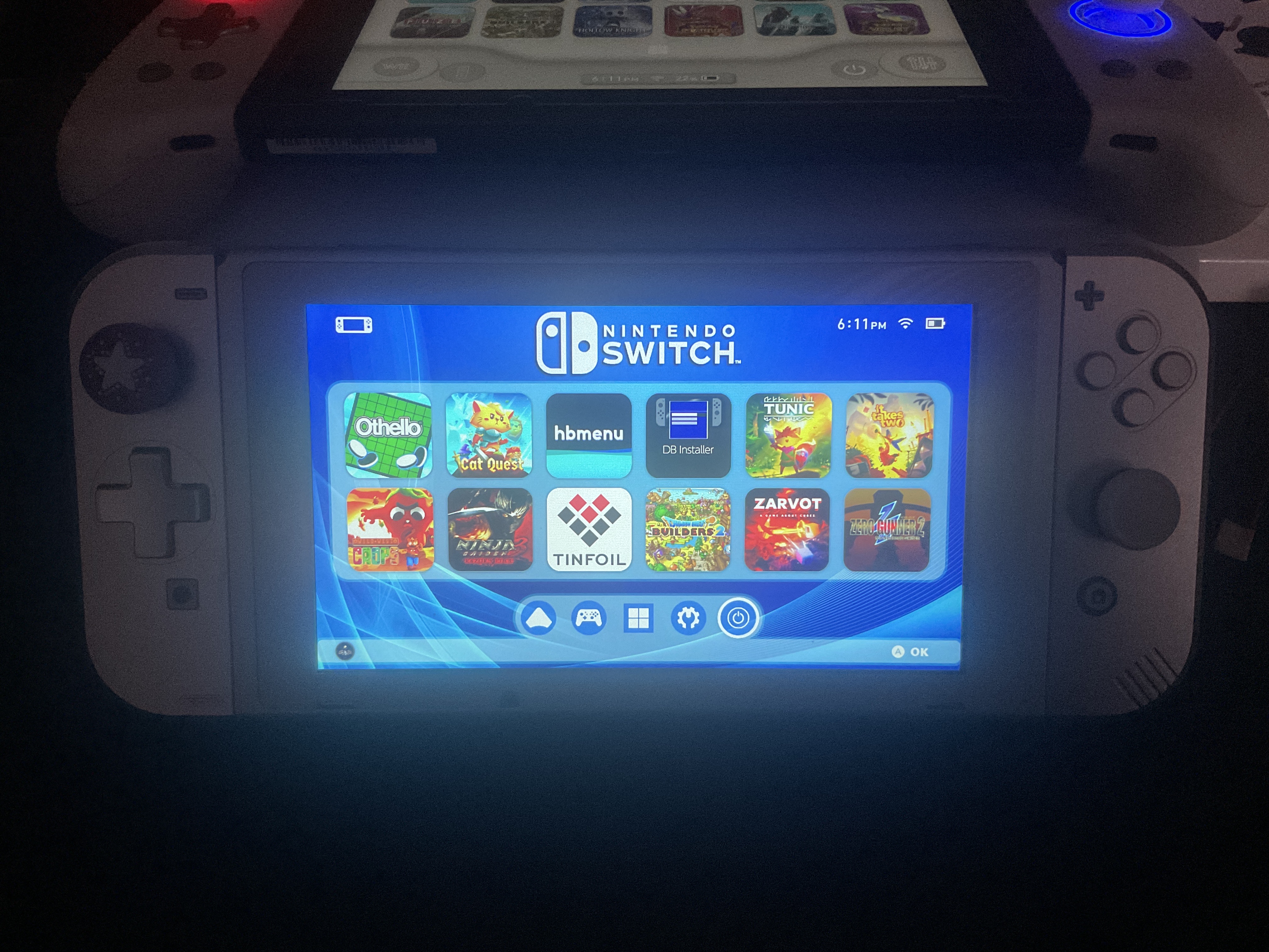

I can “move“ the joystick and control a character onscreen with a magnet (not physically touching the stick…nothing but magnetism.)
In calibration I didn’t see anything like the issues in the video. It might have been (anti?)placebo effect that I thought that maybe it was a single pixel or two off center. I was going to convince myself I needed to one way or the other so I ran the calibration anyway and I squinted really hard and could not trick myself into thinking it was off by even a pixel.
I rebooted and came back to the calibration screen and everything was still intact. Bumping it off center took only a millitouch (can that be a word?)
I’m over here going back and forth trying to see if I can tell a difference between my old one (that was brand new) and the new one I just put in.
Fortunately they came with the cool thumbstick covers so I can easily tell which one I already did!
(Hint: it’s the one with the star on the left!)
