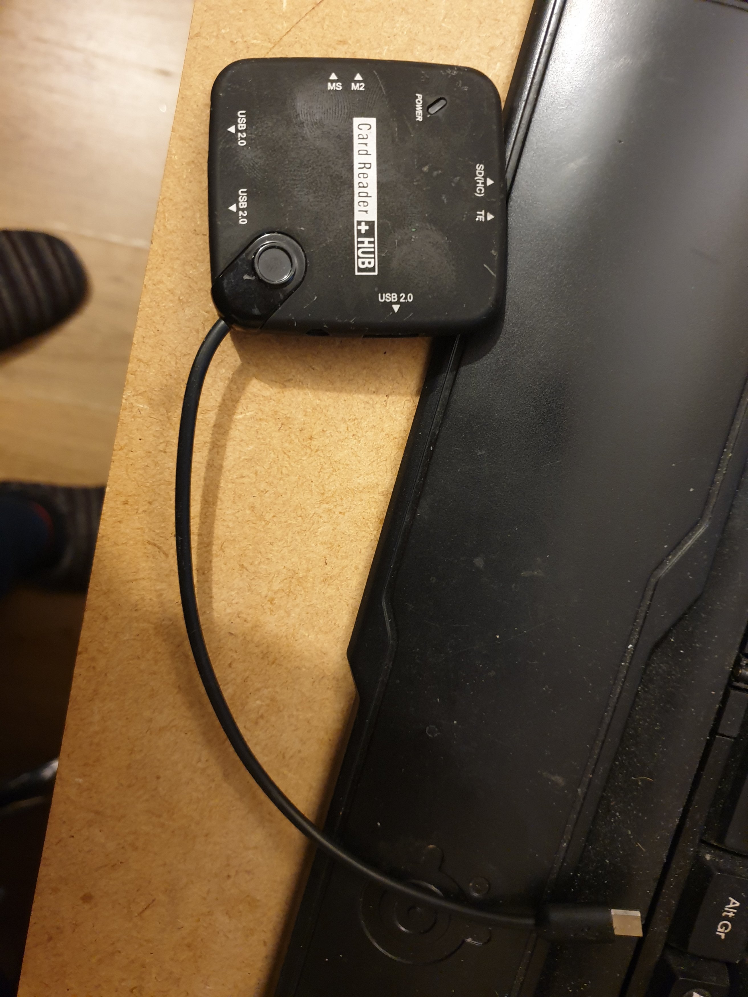

i have just set up my snes classic mini with hakchi2-ce-3.8.0 and i can see the boot screen and i have put on nes, snes, megadrive, master system, n64, neo geo which comes tpo 7.6gb so ive exported to a 16gb usb but when i plus the usb into my otg hub connected to the mini i cant see the games and have no options to use usb or select cours
i have included the structure and was woundering what am i doing wrong?
what kind of otg device do you have? some don't work very well. I found one that works 100% of the time, and it's shaped like a squid.
it looks like this:
its a 7 port usb hub that i use for my mister, not sure of the make
i have seen them on ebay for 2.50 and was looking at getting one to connect full time
if you flashed the system, and put all games on the flash drive or whatever, I assume the issue is with the otg adapter. I had a right angled one that wouldn't work most of the time.
I'd say try another otg device like the one I upped a picture of. I use it for both snes and genesis minis. I only have the flash changed with the nes mini. I put only the entire no intro set for usa, plus a few Japanese games, on each system. I only put the roms for that system on each, so the nes mini's flash was large enough for the entire no intro usa nes set. the snes and genesis minis can't do it without an otg adapter. and, the psx classic doesn't even need an otg adapter as you can plug that into the second controller port. anyway, both snes and genesis mini work with it every time (use the same adapter and flash drive for both).
