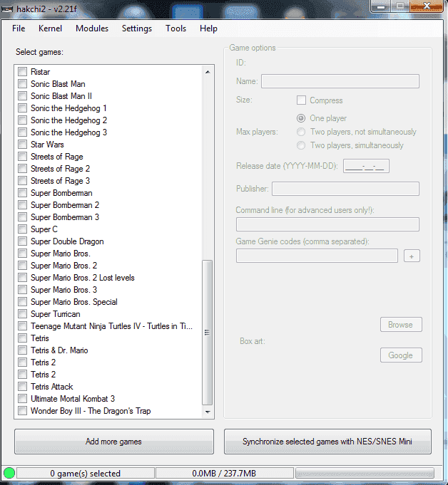

hi i think i had issues with a memory leak so uninstalled hakchi and installed my original firmware. now i have flashed custom firmware and memory is only showing 237mb is that normal or do i have a problem. nohmods,no games and no custom borders ect installed. have incuded a screen shot to show possible issue
have tried:
Q: Why my NES Mini lost some space available for games? I used to install X megabytes of games early but I can't know!
A: Writable partition can be filled not only with games. First of all, check save-states using Save-States manager. Remove unwanted ones. Then check for installed mods. If you still can't find flash memory leak, use FTP Server (available since version 2.16) and check /var/lib folder - it contains all writable data. Maybe there are some unused large file. But think twice before deleting something. Remove them on your own risk. You can't brick your NES Mini that way but you can brick some settings or save-states.
with no luck

I know you posted a question and answer about NES, but are you perhaps using a SNES Classic?
johnnytheboy12
Jan 16, 2017
51
44
115
If I'm not mistaken, that's the amount available for the SNES. Everything seems fine. NES had more available because the included games are 8 bit and not 16 like the SNES (which means the games are smaller).
Thanks for your reply I was hoping that was the reason just thought I would ask just to be certain.
