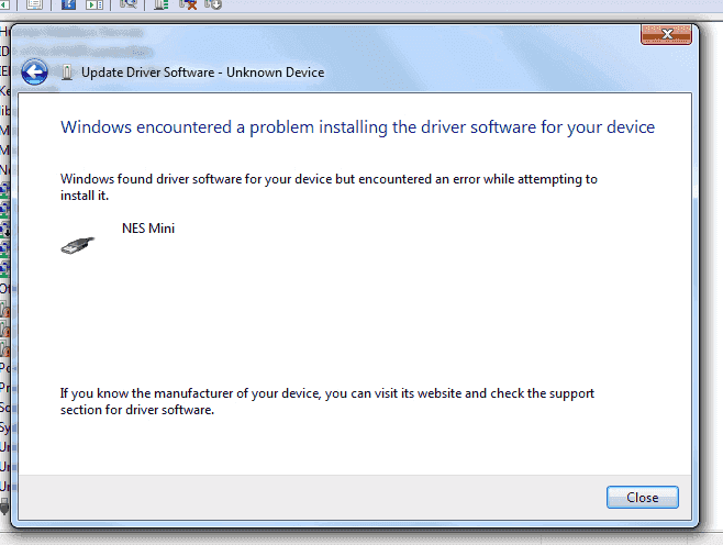

After trying everything I can think of, I am unable to get the driver to install.
Boot in FEL mode (holding 'Reset' whilst pressing 'Power') - no LED illumination - get the Windows sound confirming it has detected something.
Firewall Off, Windows Defender Off, Boot with pressing F8 and deactivating the relevant checks, using Zadig, using device manager (all in Admin mode) ...nothing will get the driver to install...?
I am going crazy trying to get this to work!
I get the screens below from Device Manager and Zadig.
PLEASE... Can anyone assist? Is there something I need to have on the MINI NES beforehand, like no save states...?
Using Windows 7, SP1 Home Premium - .NET 3.5
View attachment 74364View attachment 74365View attachment 74366View attachment 74367
turn off device signature checks (accessed via reboot on windows 7 F2 or F8 I think). Then run the driver installed as admin.
