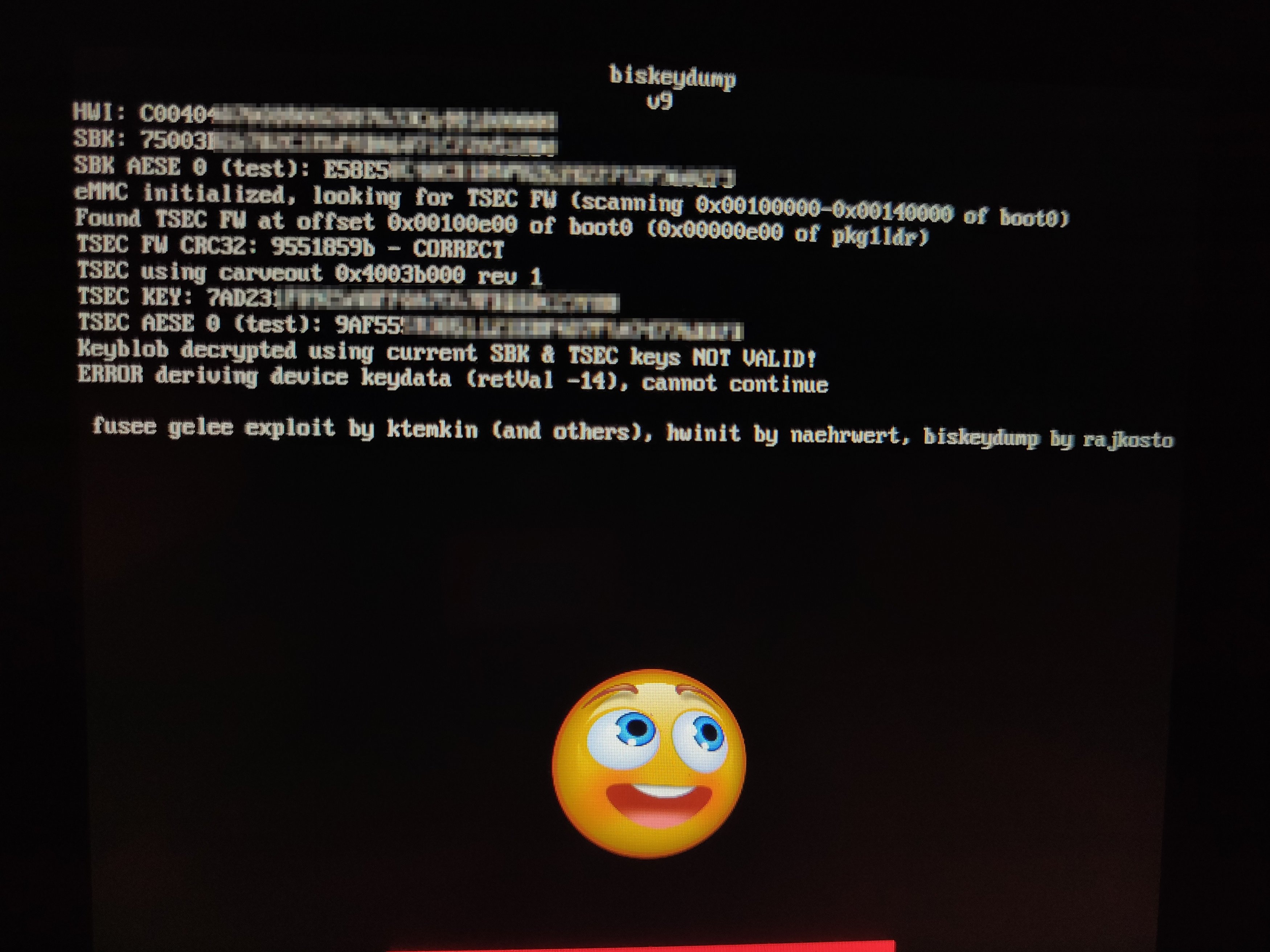

My first problem was dumping the keys via Lockpick_RCM. I get 6 errors for keyblob 0 through 5. I don't know if this is a significant problem but I nevertheless got 78 keys which include tsec_key and secure_boot_key which are used to generate the bis keys.
Also biskeydump only dumps the 3 keys: HWI, SBK and TSEC KEY. No individual bis keys.

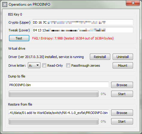

I am currently follow this guide: https://switch.homebrew.guide/usingcfw/manualchoiupgrade to try to restore it to 4.1.0 to get ChoiDujourNX to upgrade it back to 9.1.0 (11 fuses are burnt, so I think that means 9.1.0) but now I am at the point where I need to access the emmc via memloader and HacDiskMount and none of my Bis Keys work.

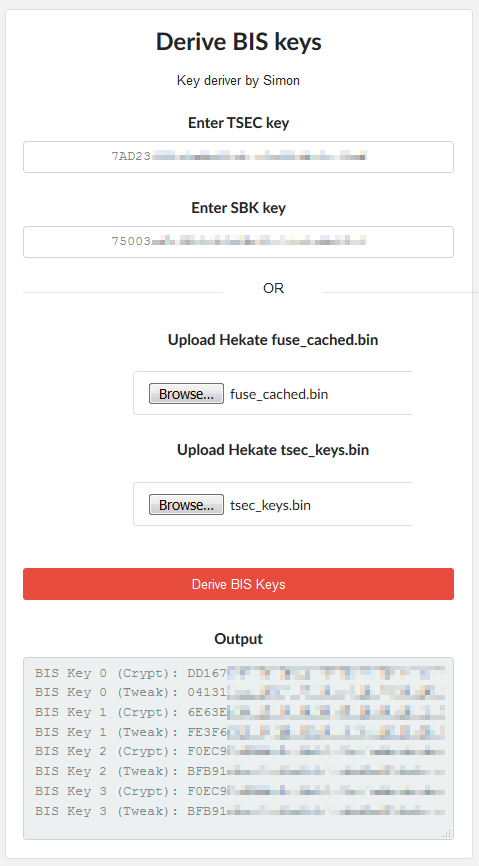

I used this website https://sdsetup.com/biskeygen to get my bis keys but here is the funny part is that i get different keys when I use tsec and sbk or fuse_cached.bin and tsec_keys.bin but if i use the bin files the tsec and sbk fiels are populated with the same keys as provided earlier. This only happens if I use the keys from prod.keys which have lower case letters in them but are otherwise the same as the ones I got from biskeydump. This is an error on the website which I already submitted a new issue for: https://github.com/noahc3/SDSetup/issues/146

My dumped TSEC and SBK keys (or fuse_cached.bin and tsec_keys.bin files) don't generate the correct BIS keys which I need to decrypt the emmc in HacDiskMount.

Could the problem be that the latest biskeydump v9 only supports keydumps for fw 8.1.0 and lower? Since the switch has 11 burnt fuses I think the current fw version of the switch is 9.0.0+ so I would have to wait for a newer version... This would also mean that the biskeygen tool is outdated and doesn't generate the right keys for 9.1.0. Is that the problem or is it something else?

Ok so i have an idea. The keys I've got from lockpick are defenitly correct, right? So what if I format system and data by mounting them via HacDisk with the bis keys which are defenitely correct but show as Fail... Would that work or does Fail mean that the bis keys wont work with some key that is saved somewhere else like in the SoC? The only problem would be the two prodinfo partitions but do I really need them to boot into the os? From what I read people have been using incognito(github page is down, so i assume the project is dead) to clean their prodinfo to not get banned. Since I'm at the point where I would be happy with just a homebrew switch that would be ok...
Does the switch need prodinfo to boot? If yes, then I am completely screwed because the above method wont work. Would it be at all possible to decrypt prodinfo without the bis keys? How difficult would it be to brute force the encryption? Is that even possible? By that I mean does prodinfo contain some bytes that are always the same?
I just looked into it. One bis key is 256 bit long which is basically impossible to brute force. So now i am thinking that one byte of the tsec or sbk key was corrupted and those generate wrong bis keys. Is this a valid assumption or are the tsec and sbk defenitely correct and crc checked or something? Why is there a mismatch between the generated bis keys with tsec/sbk and the encrypted prod info. The only possiblity would be that the previous owner of the switch flashed wrong boot images...
