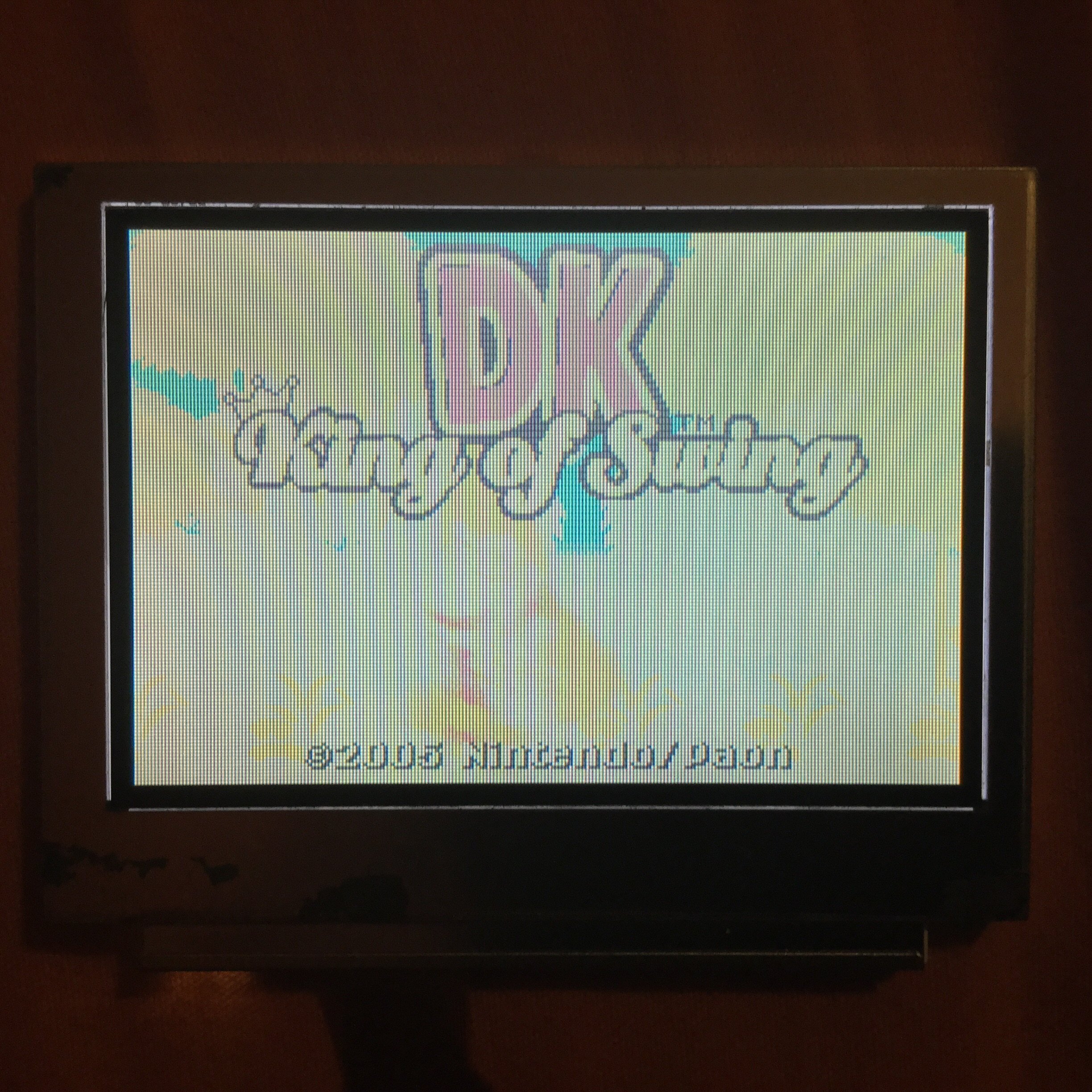

I am getting washed out colors and way too bright. I have tried the trim pot does not seem to help. I have a 40 pin gba with a type b screen ( white connector). Any help is appreciated! image.jpg
I am getting washed out colors and way too bright. I have tried the trim pot does not seem to help. I have a 40 pin gba with a type b screen ( white connector). Any help is appreciated!View attachment 58404
AFAIK this is a known issue with 40 pin + B type screen. Try to get a 32pin GBA or a AB type screen (brown connector).
See this post from this thread for more information.
Have you tried solder this two points? I had same issue, but I solved in this way.

@SaurusX's post shows a comparison between two different screens: AB type & B type.
Looking at the photos from the Aliexpress product page, I can see it has a white connector, also the leads are of uniform width... but I'm not really sure if it's a "B type" since it's OEM (not an original AGS-101 screen). Could someone light me up with this?
Many users have reported having washed out colors with this combination (40-pin mother + B type screen). Some have solved it soldering ground to some solder point on the motherboard or the ribbon cable.

B-type screen (white connector) has tracks of the same width, so it's easy to tell them apart just by looking at the ribbon.

Got the adapter today for 40-pin GBA and B-type screen (with white connector and tracks of the same width)
It works perfectly, I didn't even need to adjust potentiometer!
Everything closed up nicely, just had to take off all the adhesive rubber from display and attach it to shell with double-sided tape.
Brightness on high level is just a little bit lower than AGS-101's high level.
http://imgur.com/a/bGoM2
Very pleased with result.
