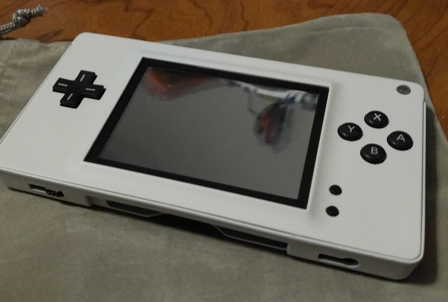

Hello, I am in progress on my project to convert a DS lite to a "fancy" GBA, which has done before. I am wondering, while I have the console open on my desk, if I remove the bits of plastic preventing GB/GBC cartridges from entering slot 2, is there a GB/GBC emulator that can run from a slot 1 cartridge using the physical cartridge in slot 2?
I doubt this already exists and I'm not sure it would be possible, but I don't know where else to try and find the answer. Thanks for your help!

You mean like a GBA Macro?

Might end up doing something like that, I was just curious if I could do it using the physical cartridge. Really was just looking for something interesting to do with slot 1 since normal DS games won't work anymore and this was my first thought.
