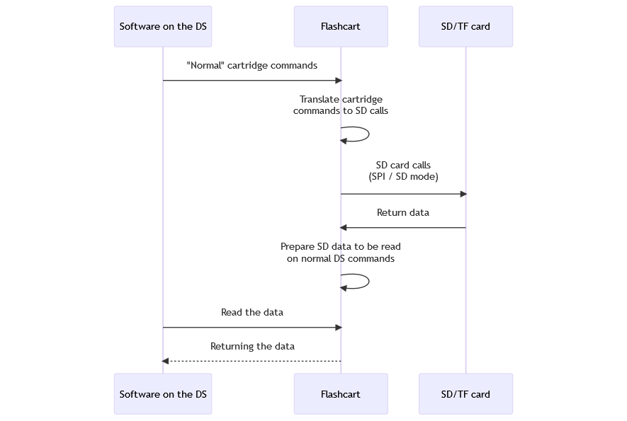

I see, thank you! It seems I was editing my previous reply while you were typing this ^_^.
I'm starting to see the full picture now. My next attempt will most likely be raspberry pi pico or some other devboard and my old DS lite.
I'll research the DSi requirements later -- I'd like the flaschard to work on a DSi (not DSi mode, but work on a DSi). But that's if I ever get it to work on the DS lite in the first place.
Thanks again everyone that has replied here so far. It really boosts the research and I'm sure that I wouldn't have found half of the information shared here if I were to do it completely on my own.

Thanks! That does clear up my mental image. As a matter of fact, it seems I was already browsing that same repository you mentioned :P.
I'm starting to see how data is being pulled from the SD card. I just still have somewhat of a hard time imagining the complete picture. How does the kernel that gets eventually loaded into the DS's memory "pipe" data through the flashcard? Because, as far as I understand it, the access to the SD card can't just be mapped 1:1 to running code on the DS. I can't even really formulate my question on this topic properly so there's still some key pieces I'm missing. ** Edit **: I was either blind or just confused, re-reading your message clears up quite a bit of the SD card stuff. I mainly still struggle with the "DS To Flashcart To SD" part. Is this a good representation of the flow or am I missing key parts (high-level of course)?
Since I'm typing my reply anyways I'm going to add another question :). Do you happen to know how the "bootloader" setup would be implemented on flashcards? I mean step 3 of this process:
That is a key part of the flow it seems and before @ghjfdtg mentioned it I didn't even know it was a thing so any information I can get about the subject is welcome!
This image looks fairly accurate to me.

So, any insight on the SPI communication, how to interpret said communition on cartridge (!) side and so on is very welcome!

As far as communications then http://problemkaputt.de/gbatek.htm#dscartridgeprotocol

I'm mainly trying to understand how the cartridge receives the communication. I am looking to make some sort of homebrew application that allows me to step through the cartridge handshake process slowly, maybe send some types of commands on a button press and inspect how it is communicated over the pins. Examples like GodMode9i and EEPROM.nds (DevkitPro example source) are a good refernce / starting point.
It's not my intention to start diving into logic on a pure signal level - I'm more so trying to understand what it would take on the cartridge (RP Pico) side to make sense of the signals and answer them.
