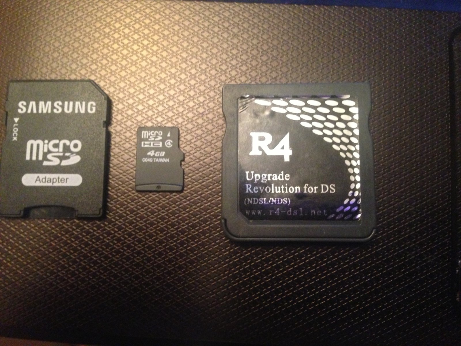

greetings friends, I write to you with the purpose, to ask for your help since I am looking for a backup of a r4 2017, since the backups that I have downloaded from this post have not worked for me, here I leave a for of my r4, thanks Beforehand and excuse English, since I am using the Google translator.
Clean backup for R4 SDHC Revolution RTS LITE 2015 www.r4isdhc.com
Could you give the full name of your "2017" card, or simply post a photo of your card?

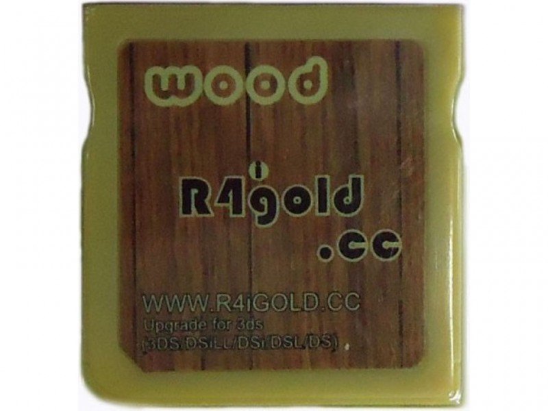

Hello guys,
I'm write because I need help with my wood r4igold, I've used for install Luma and everything works great, but I wanna to make the card useful again, so please any one has the backup for wood r4igold
This is the image:

Appears this is an r4iGold A5
search for "hw_a5"
Thanks for your help but It doesn't works, I tried with the "HW_A5" backup with no success.
Hope anyone have the backup.
EDIT: Found it, the correct version is HW_5 with this backup I bring the card to life. Thanks to everyone for the support.
If any one need this here is the file: www DOT dropbox DOT com/s/j4ys19iike5mpco/R4%20gold.cc%20FW-A5.zip?dl=1
