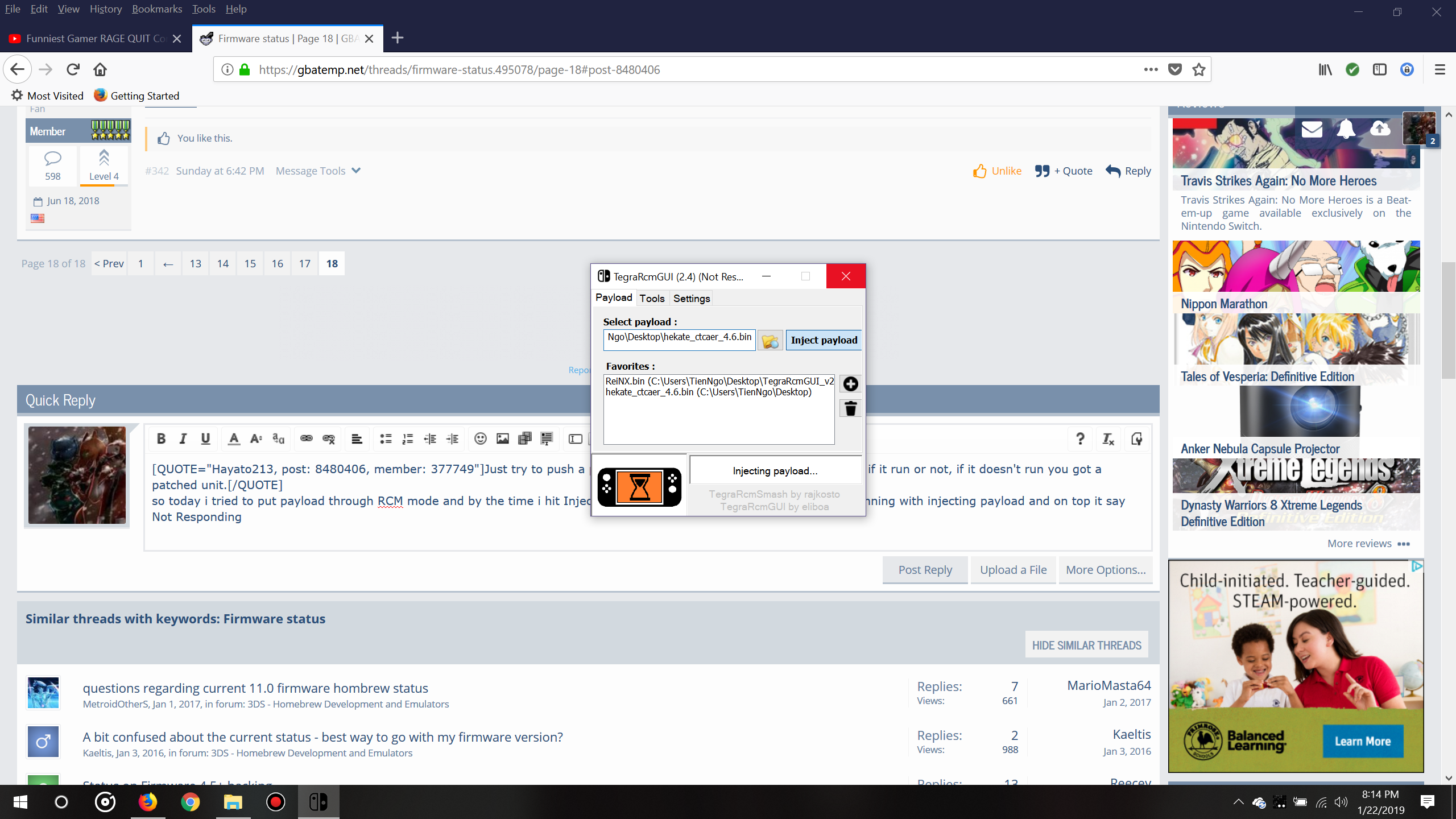

so today i tried to put payload through RCM mode and by the time i hit Inject Payload button on TegraRcmGUI2.4 it keep running with injecting payload and on top it say Not Responding like the picture, can you tell me if i did something wrong or my Switch was patched? it was like that for 30 minutes already...

Very high chance that you got a patch unit.

You're right. If you notice, it never successfully sent the payload with TegraRCMGUI (either an issue with his computer, cable, or TegraRCMGUI with the GUI being the likely culprit here, TegraRCMSmash is much better) so of course the screen would stay black. I also don't know where Hayato got the idea that his serial number was patched. But XAW100680XX is definitely not patched.
