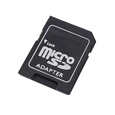

TESTED:
Sandisk 32Gb formatted with windows formatter (default options)
games are on .iso 1.35Gb
chinese SD adpater
they boot up perfectly.

I mean card reader on PC.
Do you have another PC with card reader?
or an external one?

i have a lot of microsd card reader to pcs it will matter what i will use if it will be the same micro
sd card?
Of course.
The Card reader (is also the card writer).
It's the card writer device that "writes" the information (fragmented) on the card.

I mean you need to change this: 510c-Ln-wML._SY355_.jpg.............NOT this : xszbnr1481798663623.jpg
