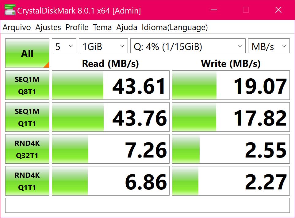

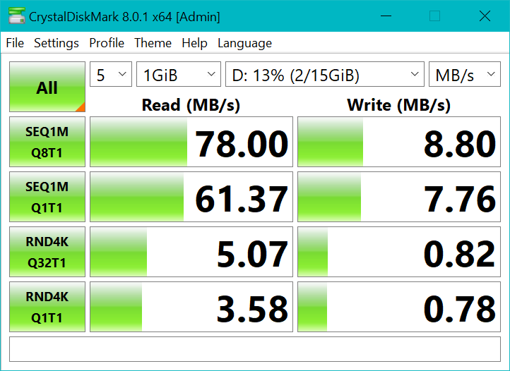

I am interested in what kind of speeds your SanDisk red 32GB scores in test programs like CrystalDiskMark.
Then I could compare it with my Kingston Micro SD and determine if I should try to update to 1.05.

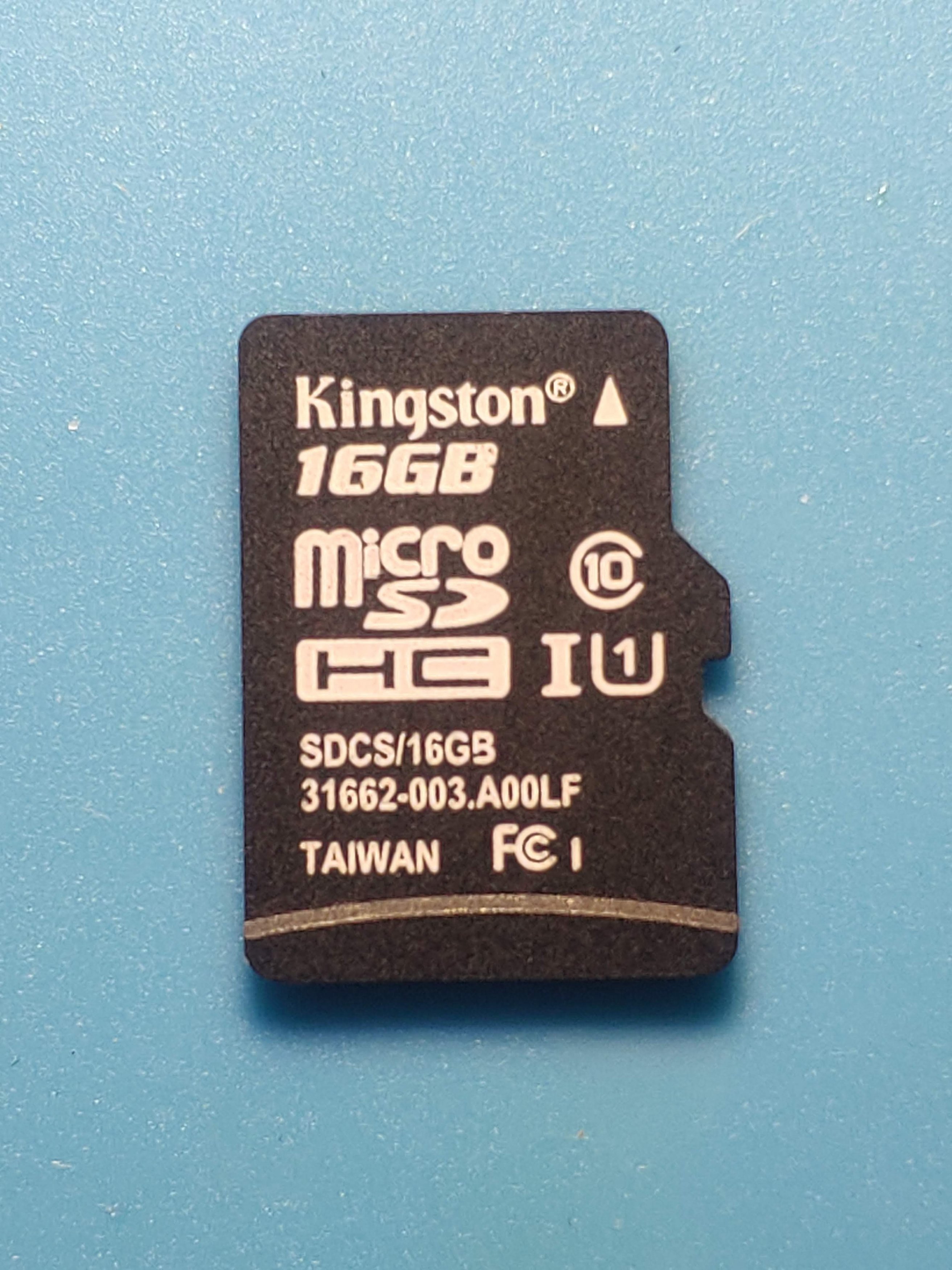

My 16GB card also 32GB (using EZ-Flash Jr v1.04) :grog:

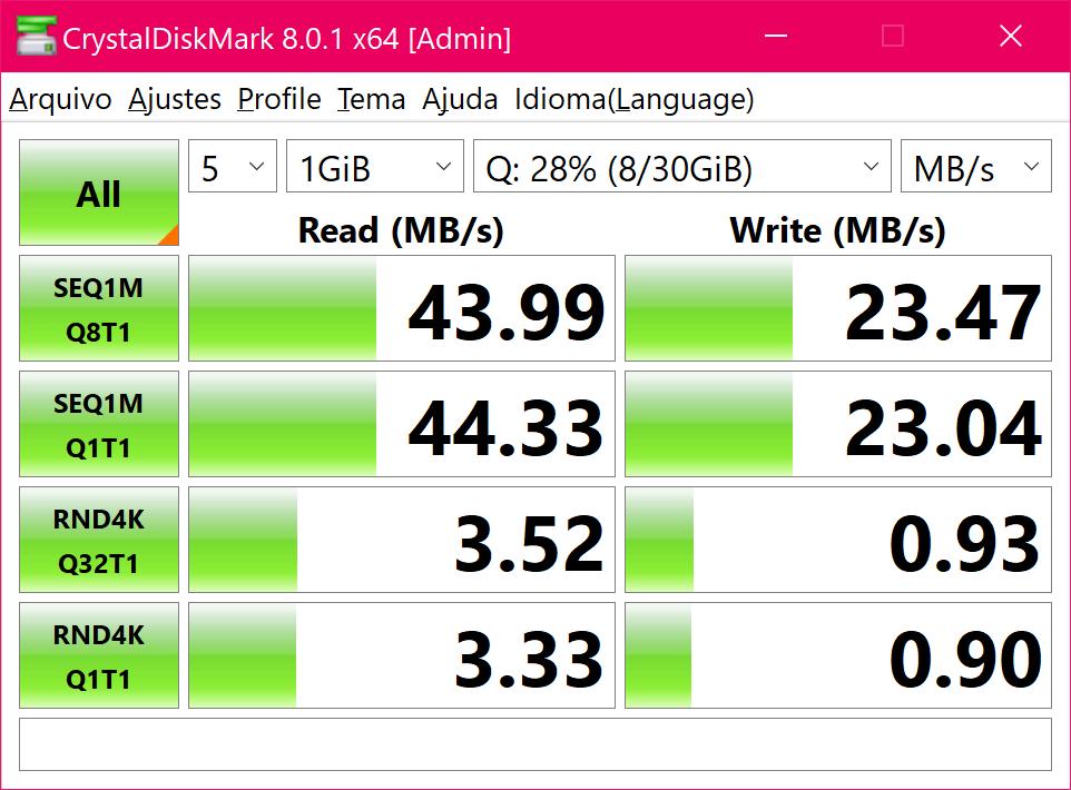

This is the results I got SanDisk Extreme Pro I just got. I wonder if what matter here are the read or write speeds, and the sequencial or random speeds. @EZ-Flash2 , what do you reckon?
You're fine with 1.04 regardless. It's 1.05 that repportedly has the issue with speeds.
oh man, this is sad! Between, nice results there!
Yeah, that is actually why I asked. If we know @EZ-Flash2 their SD card speed we could take that into consideration before attempting the update.

Your read speeds are nice! But, write speeds are slower than mine... Are you on chinese knockoff cards too?
