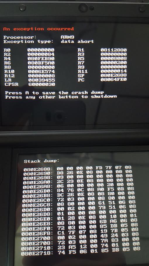

Hey guys, long time reader, first time poster.
I'm running into an odd issue as a first time CFW user.
My main interest was playing Pokemon rom hacks and games in general with this, so I installed a bunch of 3ds and 2ds titles, but heard you could convert a .gba file to a .cia file and install GBA hacks as well.
I did that yesterday using the GBA Injector program posted here on these forums, but looking through the thread I wasn't able to find anyone who had the issue I was having.
So I installed the game through FBI as a cia, then booted it up just to see if it worked via the virtual console, as I wasn't decided if that was the right option or if I should just use an emulator in the future for gba titles.
Then some time later, without any interaction with the title, I scrolled over it by accident and it crashed my system with the attached error.
I'm not super knowledgeable about this stuff yet, but I know it happens every time I select the icon from the home screen, so my initial though is to just uninstall it and move on, as its not something I really even cared to have on the system.
The problem is, when I go to uninstall it the standard way in the system menus, as soon as that list populates, the same crash occurs.
So I tried to uninstall in FBI, and the same problem happens there as well.
Is this all a coincidence or something? If not, it seems that some how this title has gone rogue and I'd like to fix the problem or remove it entirely.
Since I can't do it with the 3ds itself, I assume there has to be some way to do it by manipulating the files on the microSD card right?
I can't seem to find any easy answer to this question though, so I decided to post about it here instead.
I even tried a second install of the same game, and it works fine, but the first install is still there on the homescreen crashing every time I interact with it.

I'm using Luma 9.1
on sys 11.8.0-41U

Check if your SD card is fake.

If your have a counterfeit or defective SD card, your issue stems from data corruption. You need look in that post in what to do to check if it's fake or not.
If the card's no good, you replace it with another card that's been checked to be real.
You should test all your SD card, usb drive, compact flash, or any flash memory product before placing your trust in using them.
Anyway, is there no way to "uninstall" games from the sd card directly?
Delete the title subfolder that corresponds to your game. You'll need to search at advanscene.com, 3dsdb.com or that title site as reference.

You could try to delete and reinstall the game. However, if a similar incident like what you experienced happens again, you should consider H2testw testing the card to determine if the fault lies in hardware or software.
According to your response, I assume you believe that the problem is not just the one title, and instead a greater problem is manifest through it?
The SD card is the foundation of building a functional and stable 3DS setup.
Yes. Anytime there's an unexpected game crash or 3DS behaving strangely, one of the first suspicion is whether or not the card is faulty before considering it's a software or custom firmware problem.

I ran the tests on the blank sandisk card I bought from amazon and that has been sitting unpacked for a long time now, and everything went perfectly. Took like 30 minutes.
I then copied all the files from my current card to this new one and as I was windows alerted me to a file being corrupted. I chose to ignore that file and when I finished copying and loading up the new card, I noticed that the install of that GBA game I mentioned was just gone. I was able to uninstall it and had no problems since.
Now I'm currently running those tests on the original card. Its taking like twice as long though. Estimated 54 minutes at the start. About 20 minutes into it. 30 more to go.
If there is something to report, I will.
As it stands, using the files minus the corrupted one on the new card seems to have fixed all the problems though.
I suppose that means that some how that specific title was corrupted?

If you did nothing out of the ordinary like pull out your SD card while the 3DS was in use, remove the battery while a read/write was taking place, or an instant shut off occurred due to an old battery that can't hold a charge, your game shouldn't corrupt.
Other than a bad SD card that's either fake, defective, or too slow (speed rating of Class 4 or lower), another thing to contend with is a failing SD slot reader. This one is slightly harder to pinpoint if it still works but occasionally derps. You would have to disassemble the 3DS and replace the reader if it has poor pin contact with the card.
Sometimes still, corruption happens out of the blue for no reason at all. Your 3DS and the SD card are machines but are in no ways perfect. This is why it's recommended to make backups of your game saves and extdata with Checkpoint or JKSM.

Gotcha, well anyway I finished the test on the original card. It returned this:
Test finished without errors.
You can now delete the test files *.h2w or verify them again.
Writing speed: 10.4 MByte/s
Reading speed: 18.2 MByte/s
H2testw v1.4
So that's not really giving me anything conclusive to work with. Still, the fresh card seems to be better over all. I feel like its a faster card too, but I'm not sure about that.
Anyway, seems to be fixed for now.
If you aren't sure WHY this happened in the first place, I suppose I am still concerned though.
I have the backup either way though. I was worried about installing things after I saw what happened with this one title, but I suppose I can keep going now and if there is a problem I can just do this whole process again.
  • What model 3DS do you have?
  • Is it on 3DS firmware 11.8.0-41U?
  • Are you using SysNAND or EmuNAND?
  • Is your custom firmware setup using the latest Luma3DS v9.1, boot9strap v1.3, and GodMode9 v1.7.1 on both the SD card and CTRNAND?
If you require updating your CFW, look to these guides:
-or- for a combined guide of the above two:
Ensure you don't have this selected in Luma3DS configuration: ( ) disable ARM11 exception handlers.
- If you have an o3DS using an micro-to-standard SD adapter, try using a new/different adapter with the old card.
- If instead you have a new series 3DS, continue using the replacement micro SD.
- If the problem comes back after whichever card setup you settle for, replace the SD slot reader.
  • look to ifixit, ebay, and aliexpress for tutorial + part.
