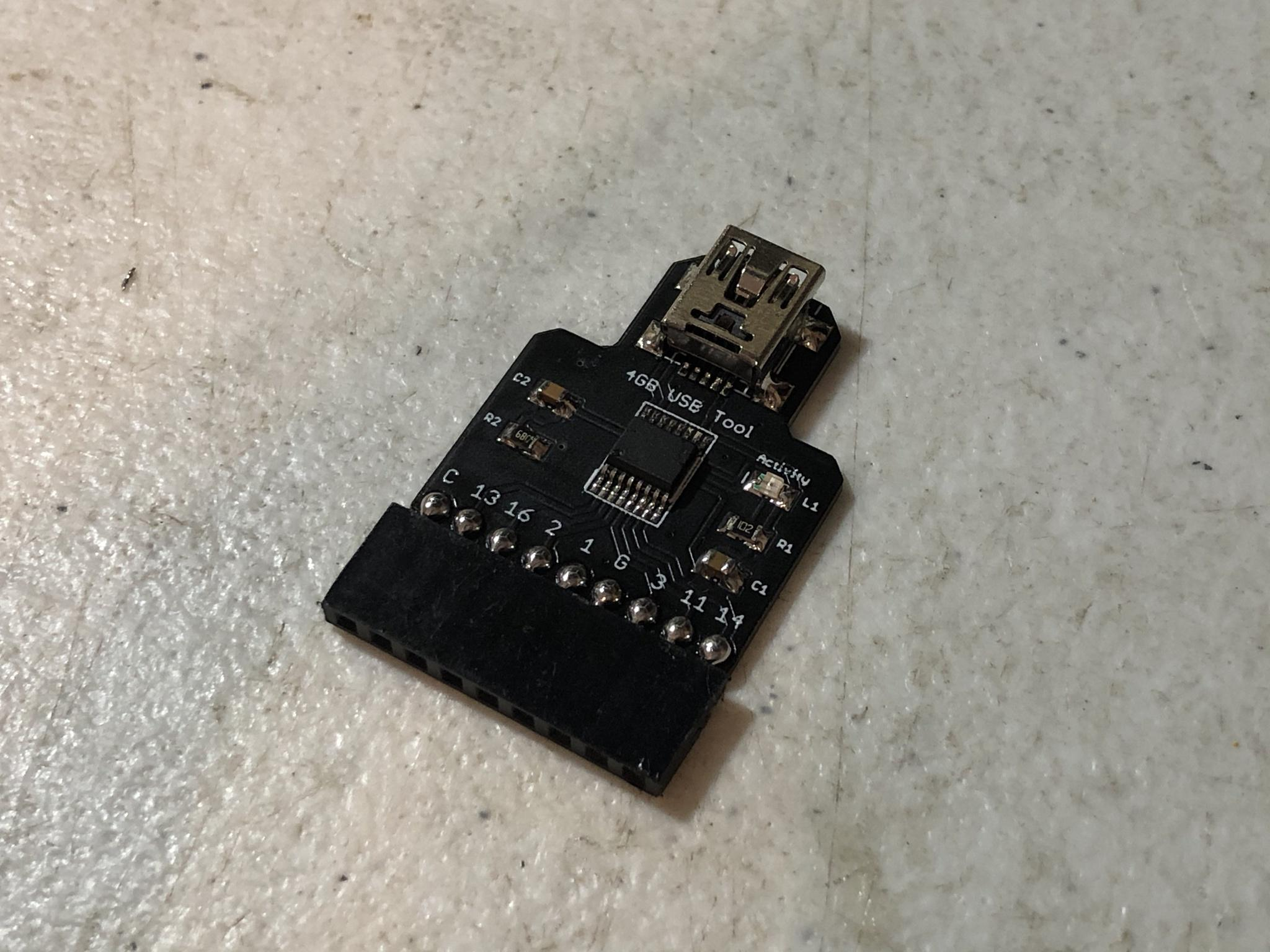

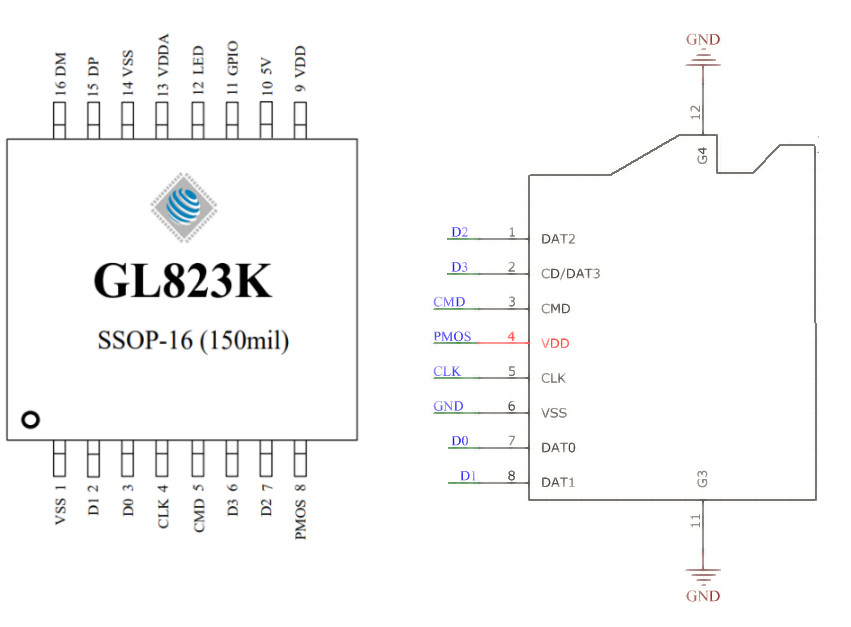

@esmith13 Ok, so to start off with making an Evercade cart reader/writer device, I could use one of these cheap $1 GL823K USB card controllers similar to the one in the 4GB Corona USB Tool or those USB 3.0 microSD card readers.

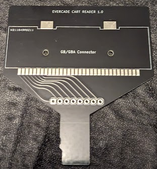

Ahh. You don't like my USB sd reader to GBA socket w/ super glue?? :rofl2:

FYI I did try to use a Retrode 2 with a Game Boy adapter, but nothing showed up except NoName.ngp with the size of 64 KB.
Hopefully it didn't damage the Evercade cart. A Game Boy cart slot provides 5v on pin1. Evercade carts being SD cards expect DAT2 on pin1 and only need 3.3v on their power pin. Both carts have a ground on the last pin. (Evercade carts actually have many pins attached to ground)
I guess time will tell. I was too curious, so I took a calculated risk.
Does this mean you can just plug the wires with male dupont connectors into this thing instead of super glue or solder them to a micro SD card adapter?
