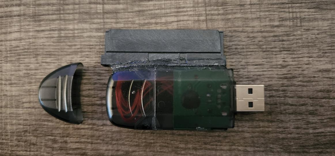

A while ago I saw someone on YouTube who made a USB adapter for the Everdrive cartridges to access the included ROMs. Do anyone know how to make one. Or is it maybe possible to use a Gameboy cart reader like the GB Operator, Retrode 2 or maybe the Save The Hero Project one?

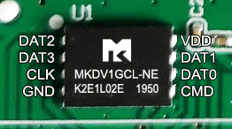

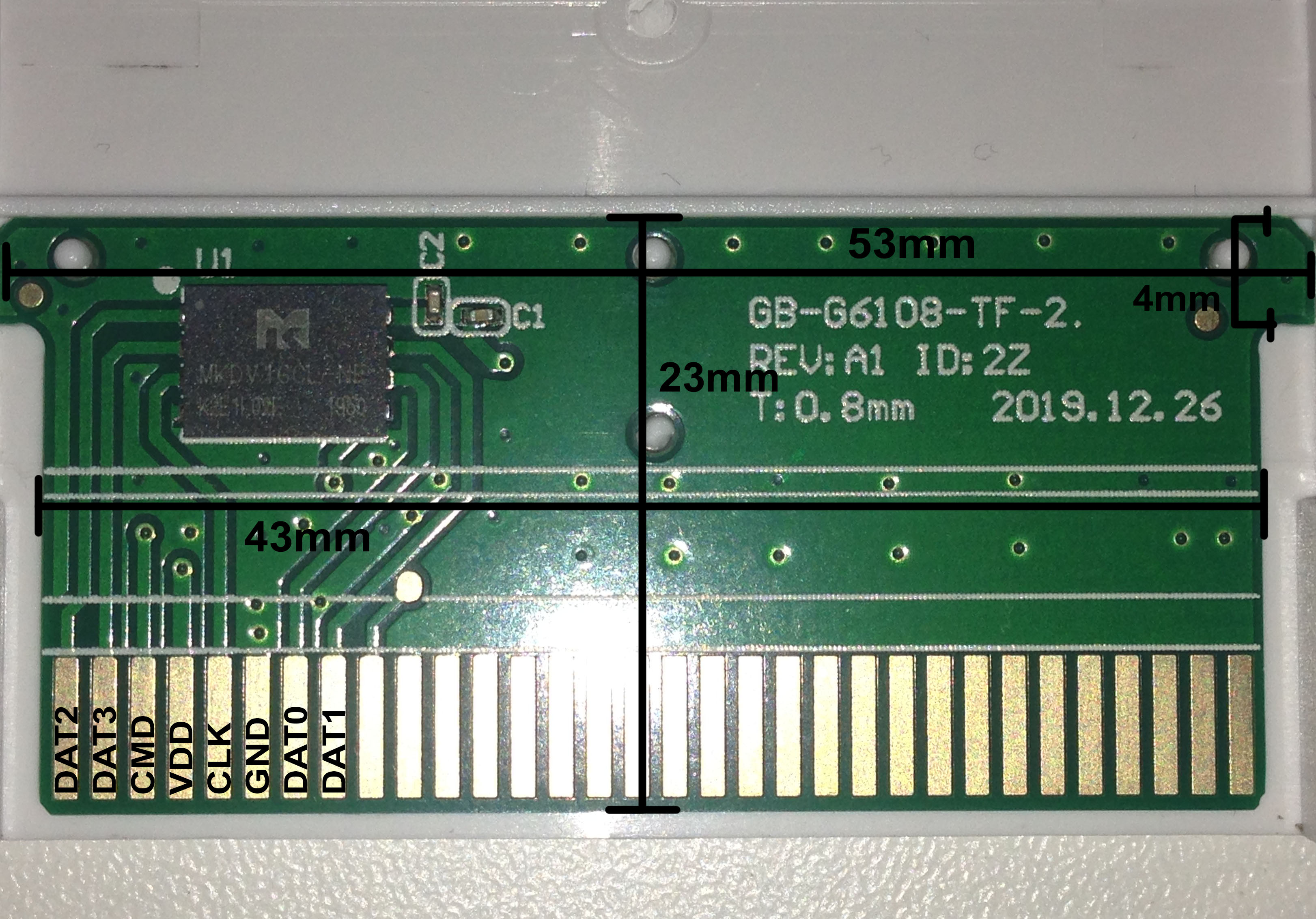

@kjetil_f The Evercade cartridge can be easily read by an SD card reader, the flash chip in the cartridge uses the same SPI protocol as a microSD card.

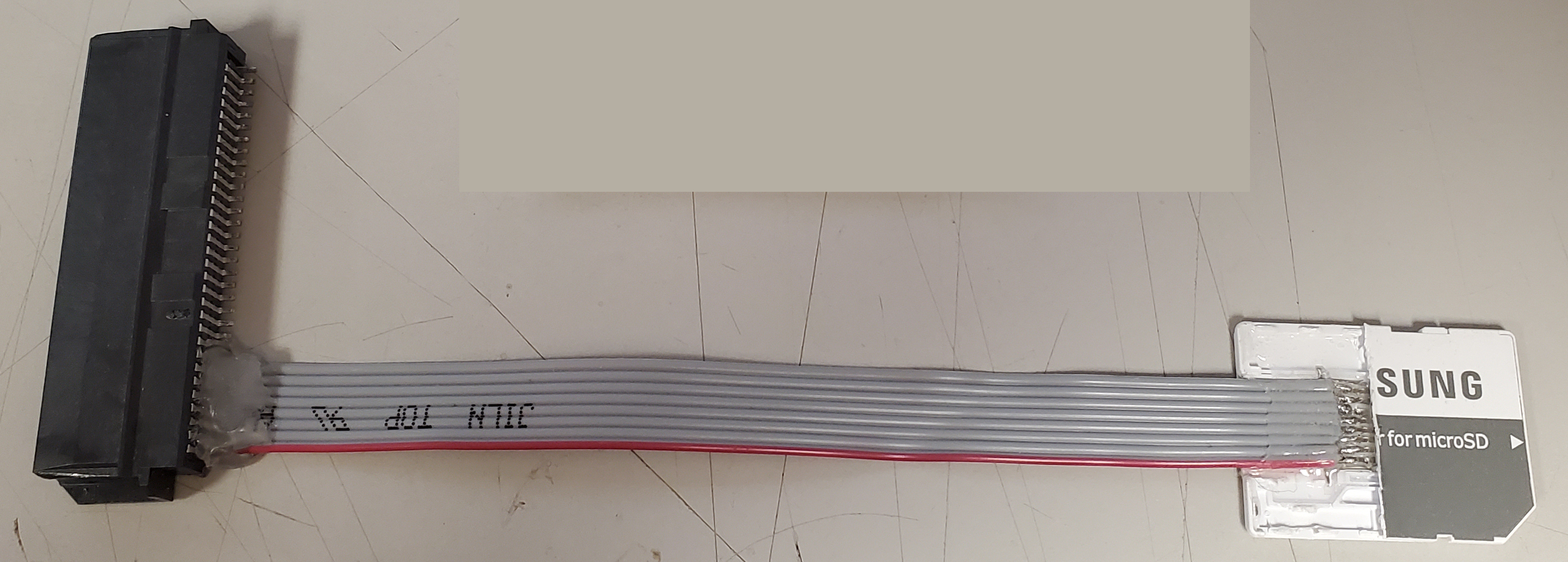

Should you need any assistance in making one yourself I'd be happy to help any way that I can either here or on the EverSD Discord (in my signature). You can literally make this for $5-$10 at most assuming you have to buy everything you need except the soldering iron and solder. Literally a $5 soldering iron is good enough to make this. It's super basic work - even for someone new to soldering.
Fair enough. No problem. I did have my first try at a soldering iron and a Atari Flashback a couple of months ago with great success, so I'm down for a new project. If you can point me in the right direction on the parts I need that would be greatly appreciated.
If you want to make the version that results in an SD Card connector you will also need 8pcs of wire and a free mSD to SD adapter that comes with a mSD card.
If you want to make the USB version, you need a SD and/or mSD to USB card reader to sacrifice. You would desolder the SD or mSD card socket from the reader and solder your 8 wires there.

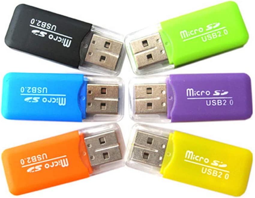

It doesn't matter which adapter you buy, but for reference when I made my 3D printed version I went with these cheap readers since they were very small but still easy to solder. They are the ones that usually come free with Chinese emulation handhelds.
Neither version of the cart reader is superior to the other since at the end of the day the cheaper version with the free SD adapter still plugs into an SD slot on a computer or a USB adapter anyway.

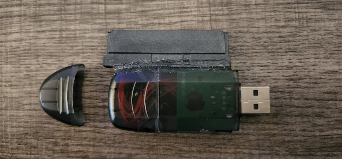

If you wanted to go all out and 3D print a shell and require the use of a USB cable to hook it up, you would basically be making the USB reader version and also desoldering the USB-A male connector off of the adapter as well and using 4 more wires to instead solder to a female Micro USB-B or female USB-C breakout board.
Sounds awesome! Even if you don't plan to sell them directly, I'm sure you'll have a minimum requirement to order and test with. I'd be happy to buy one or more of those to help offset your out of pocket and get a chance to get in on them early and help with testing.
If you're interested, hit me up when the design is ready and you have a cost per board that would help you out. I'll happily paypal you $$ for some pcbs plus shipping. I'm located on the east coast, USA - should that weigh into your decision.

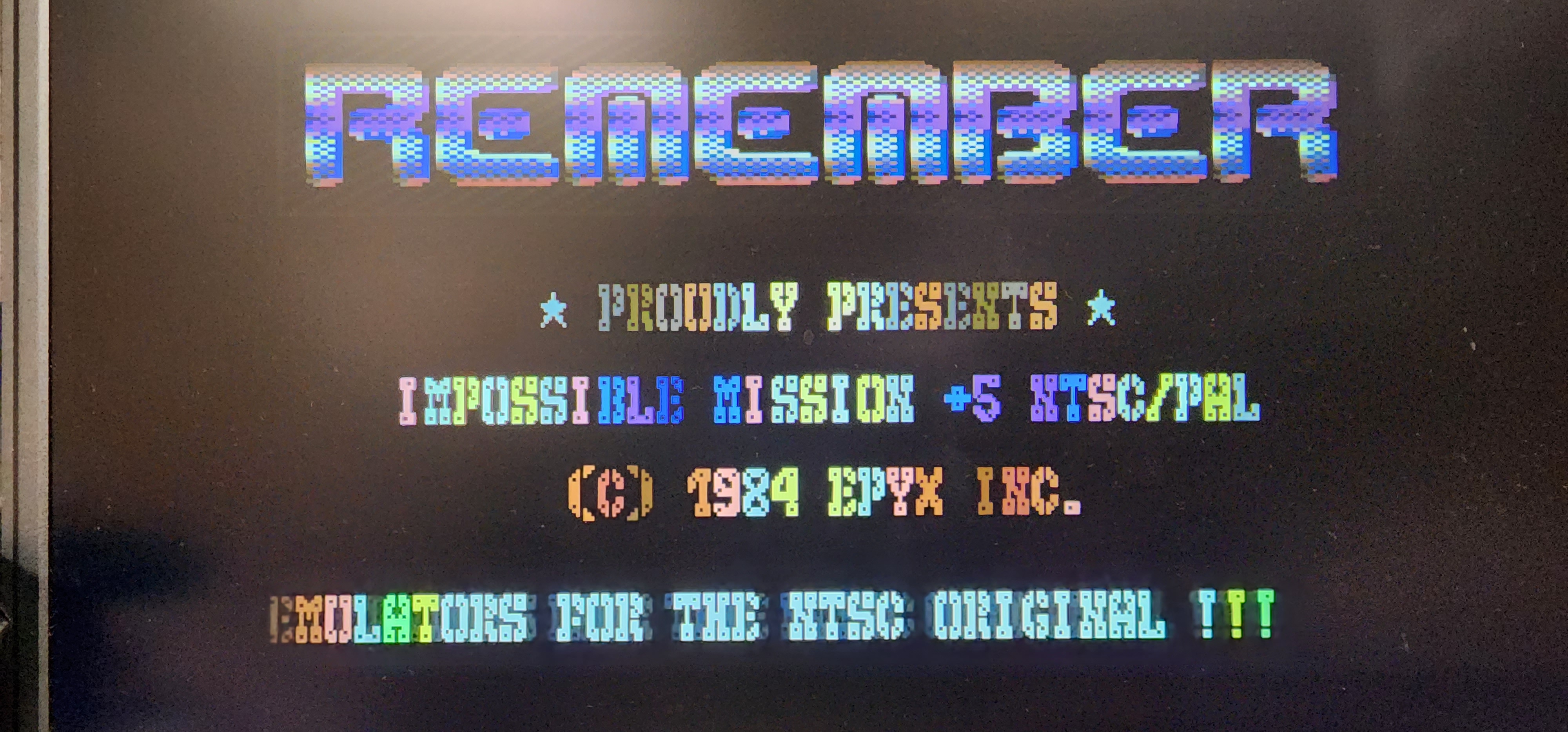

This is what you see if you boot their copy of Impossible Mission without the starting save state:
