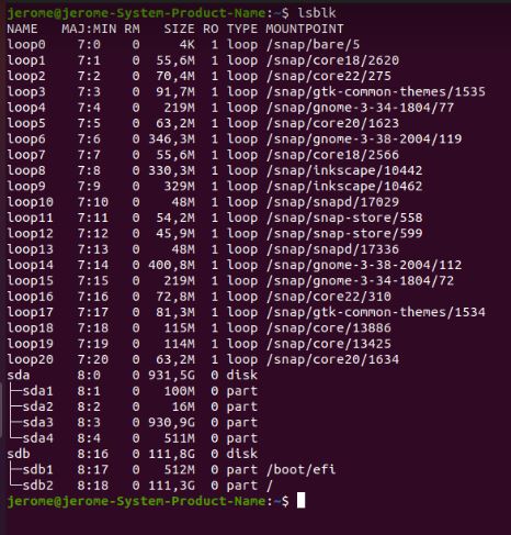

hello,
I received the emmc memory, I am under linux 20.04.03 and when I run this line
sudo dd if=/dev/mmcblk0boot0 of=boot0.bin
it puts me that look the picture
do i need to install a driver for it to work?
Thanks

Can you show me your drives in Linux?
There is an app named drives.
Or type lsusb
Seems the emmc isn't connected.
indeed it looks like it is not recognized, but it may be because I use version 20.04.3 while it is recommended to use version 20.04.1. What drivers should I install?

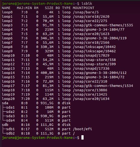

and look on the photo when I turn off my pc it gives me this line

Hmm the terminal output isn't readable can you take a better picture?
it can of course be that the emmc is completely defective.
You don't really need to install drivers. your Ubuntu version also has the right driver with it.
if it doesn't work at all you can try to put the emmc in the freezer.
but you should prepare well.
you only need the two prodinfo partitions and your keys. you can also dump the keys without emmc (on erista unit's)
prepare the dd commands for the two prodinfo partitions. plug in the emmc and make sure it shows up in the Disk Drives app. then quickly run the dd commands to back up the two partitions. with these (and your bis keys) you can then create a working backup.

sorry for the bad picture
