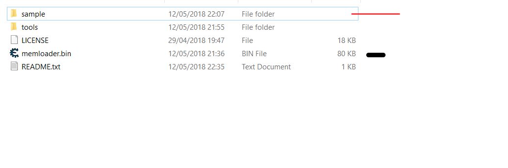

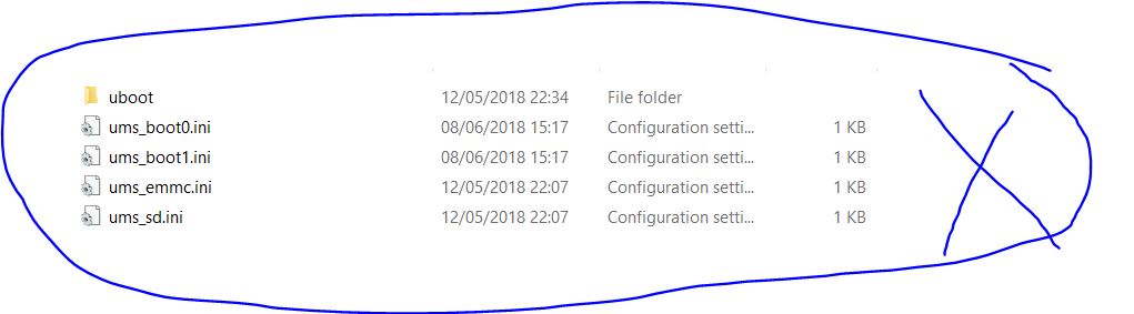

HACDISK WONT SHOW THE SOURCE TO MOUNT UNLESS YOU USE MEMLOADER PAYLOAD FIRST..
place the files from the memloader zip, the files in the sample directory to the root of your sd then load the memloader payload and select emmc..
Then use hacdiskmount...

DOWNLOAD MEMLOADER
EXTRACT THE ZIP.
PLACE THE FILES FROM THE SAMPLES FOLDER
AND COPY THEM TO THE ROOT OF THE SD CARD
PLACE SD CARD IN SWITCH
RUN THE PAYLOAD
SELECT OPTION EMMC
RUN HACDISKMOUNT SELECT OPEN PHYSICAL DRIVE
Do you see partitions ?
