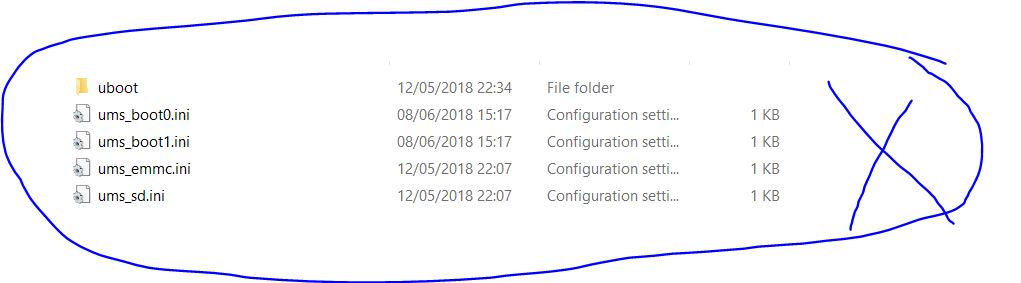

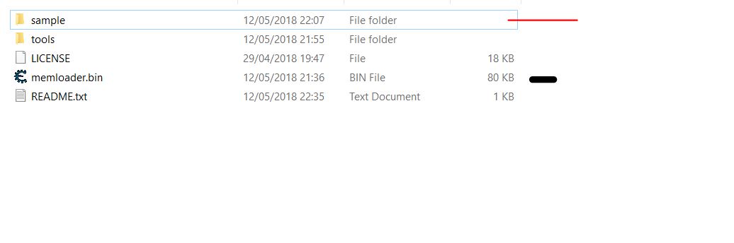

DOWNLOAD MEMLOADER
EXTRACT THE ZIP.
PLACE THE FILES FROM THE SAMPLES FOLDER
AND COPY THEM TO THE ROOT OF THE SD CARD
PLACE SD CARD IN SWITCH
RUN THE PAYLOAD
SELECT OPTION EMMC
RUN HACDISKMOUNT SELECT OPEN PHYSICAL DRIVE
