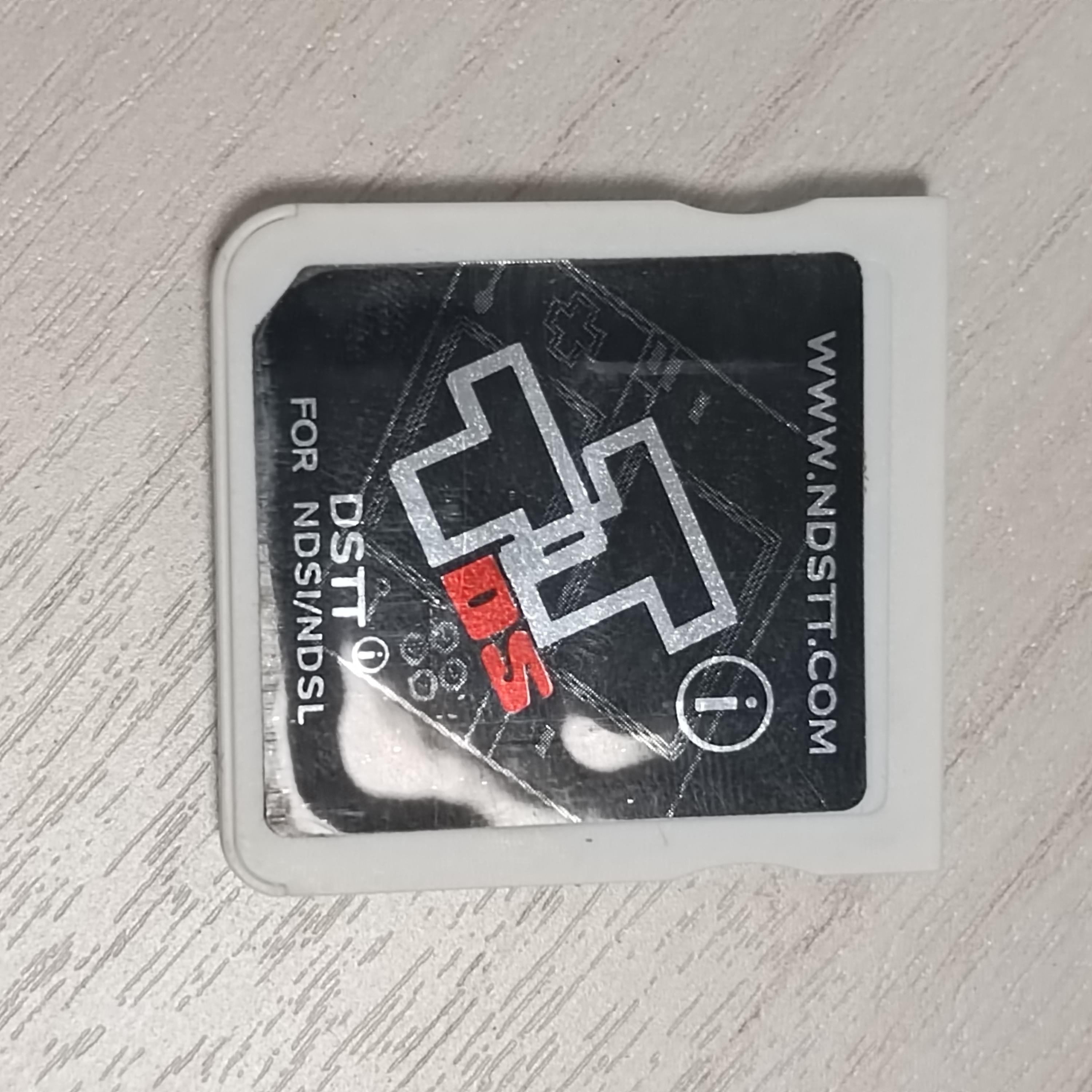

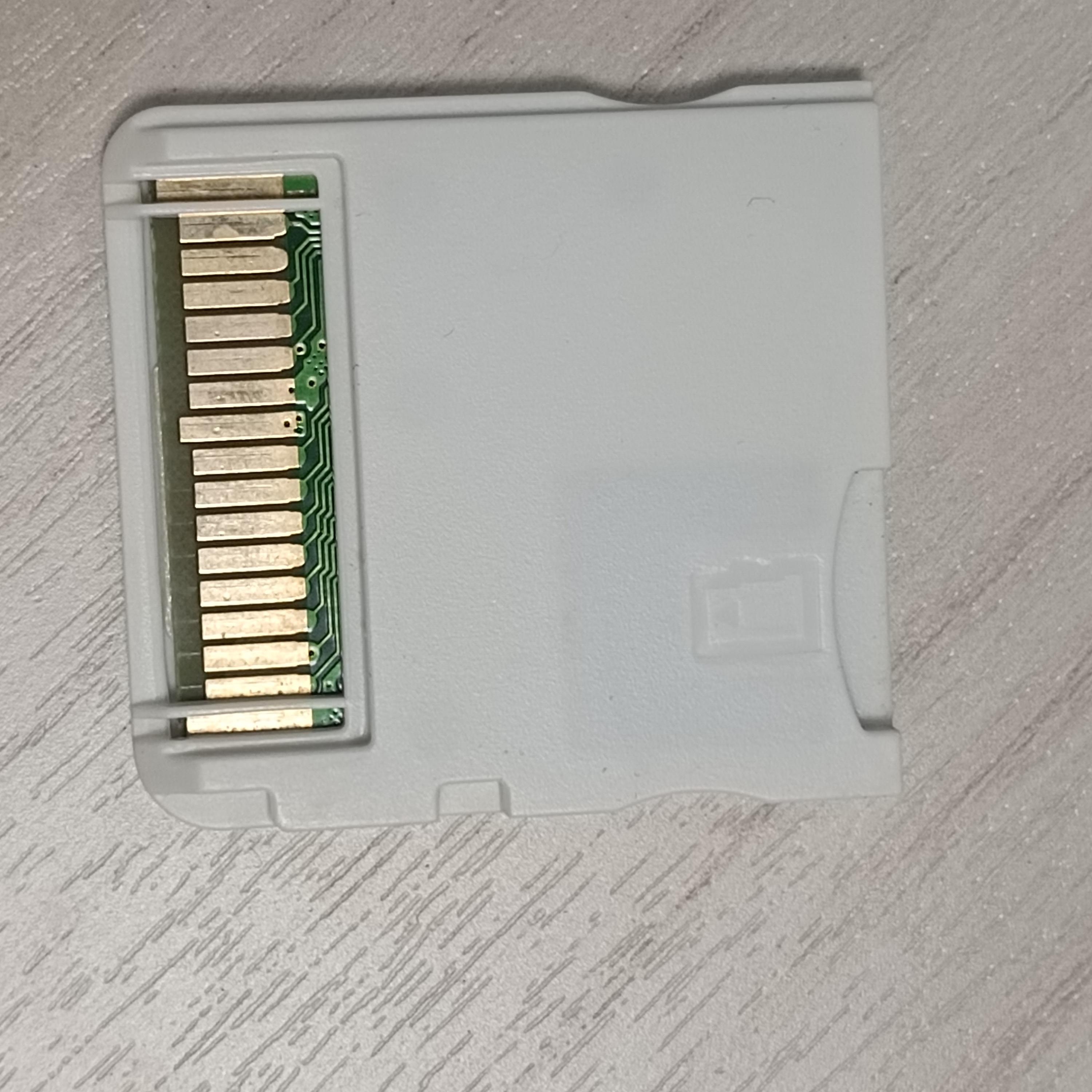

r1vver
Oct 7, 2017
551
979
Russia
Thanks,
my DSI has this FW 1.4.5E. Ca I use the DSTT?? Thanks
If I were you, I would take 2 good photos of the cart (front side and and back side, so that the color of the circuit board is visible) and create a separate thread with the question.
Photos are needed to understand if your cart is an genuine or a clone/fake.
I would also indicate which menu works on the cart (list of files on SD card) if there is one, of course. It's also for the same reason.
Although the answer is likely to be the advice to install custom firmware. https://dsi.cfw.guide
CFW/unlaunch on the DSi overruns blacklist checks.
