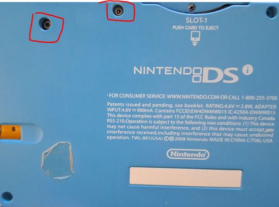

Hi. My DSi got caught up in the wash.
Now if it were just the system, it would still be upsetting, but I have pictures and animations within the system memory that I would like to keep.
I read that you can open up the system and swab it with alcohol. This way the alcohol dries faster and you can clean the motherboard.
Can I still do this even though its been some time since it "dried"? I tried opening it up but two of the screws seem stuck in and won't come out.
Can I salvage the system memory part of the motherboard? If anyone has any advice, please let me know.
I've tried opening it but these two screws highlighted in green won't budge. I'm worried they're too deeply lodged in.
Is that even possible?

I'd suggest leaving your console without a battery to dry in silica or rice for a week before attempting to turn it on or for repair.
Usually, corrosion is cleaned easily with Alcohol and Vinegar, whichever works. So that gives you time to find proper screwdrivers to take apart your console.

Anyway, the DS needs a No.3 Tri-Wing for those.
If you've been using a Phillips Screwdriver, screws might be probably washed. In this case use a drill to completely destroy it's head.

You need the right bit size, as well as a proper bit driver to have enough torque to remove the screw.
I see. I was told it was a square double 0 bit upon basic inspection.

Yes, it's a possibility. But it's really gotta be stored in an extremely bad place to get any real damage to the motherboard. This means, if you leave your console in a place with strong humidity, it will create corrosion that will eat up whatever traces or components.
The main concern is, that you must not turn on your console before it's dry to prevent any short circuits.
Leaving your console in a dry place with something to absorb humidity (Silica/Rice) will help prevent the former problem of real hardware problems.
Like I mentioned, drill those screws to clean your console more thoroughly.
Alternatively, you could try to use the rubber band method that will grip the misding screw parts that's preventing it from turning... or use steel whool if the rubber isn't working (to me it never does) but steel wool has worked for me in the past.
Before leaving it to dry, you need to remove all corrosion (if any) from all the board, or it might not work after the drying process.
I suggest you to rub it using a toothbrush using distilled water and cleaning it afterwards, then apply the drying method you prefer (I recommend using a hot air gun or a hair dryer), but leaving it overnight by itself might be enough unless you didn't clean under the metal parts on the board.
And yes, you should disassemble it all.

I just can't seem to get these two screws out. Doesn't help that they're down holes. Pretty sure they're stripped.
Any advice?
Precision Screwdriver maybe

I have a lot of memories on this DSi that I need to retrieve, but thank you for the advice.
I saw somebody link these bit heads, saying they might work to get em out.
