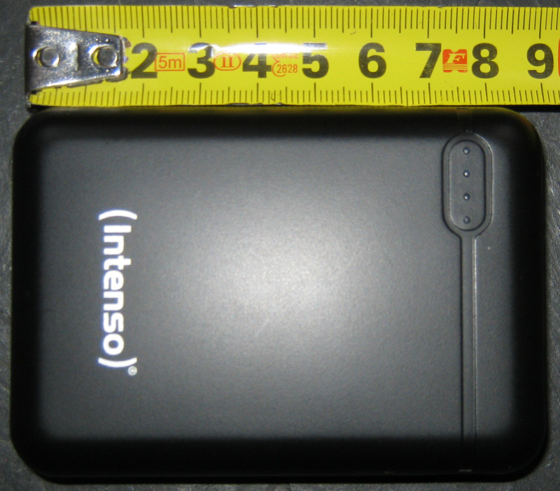

With clear weather and bright sunlight, we can get about 1000 Watt per square meter. If you solar panel has an efficiency of 15%-20% you get the idea what power you can harvest from 1m² under best conditions: 150W to 200W. That is the usual "up to […]"-marketing phrase. We have no idea how efficient the PV in such a gimmick is. Now measure the size of a powerbank and the tiny PV module. The measuring tape slipped a bit, but you get the idea: a bit more than 9cm length and 6cm width.​

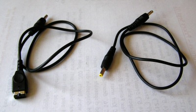

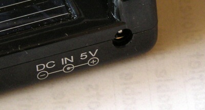

Yes, there are definitely many problems with the accessory in general, but I believe it was meant to charge slowly and be a backup battery, even being able to charge it directly. I managed to find more info, and it turns out the cable is short and detachable, as long as I can find one with the proper ends it should work...
"The shortest charging period you can expect is 8 hours when the unit is placed in strong direct sunlight."
source: aoaforums review of the recharger (it doesn't let me send the link because I only have 3 posts so far :P)
Interesting that they say the thing is accessible in many stores, I can barely find it anywhere
Images are of the cables and the dc input
