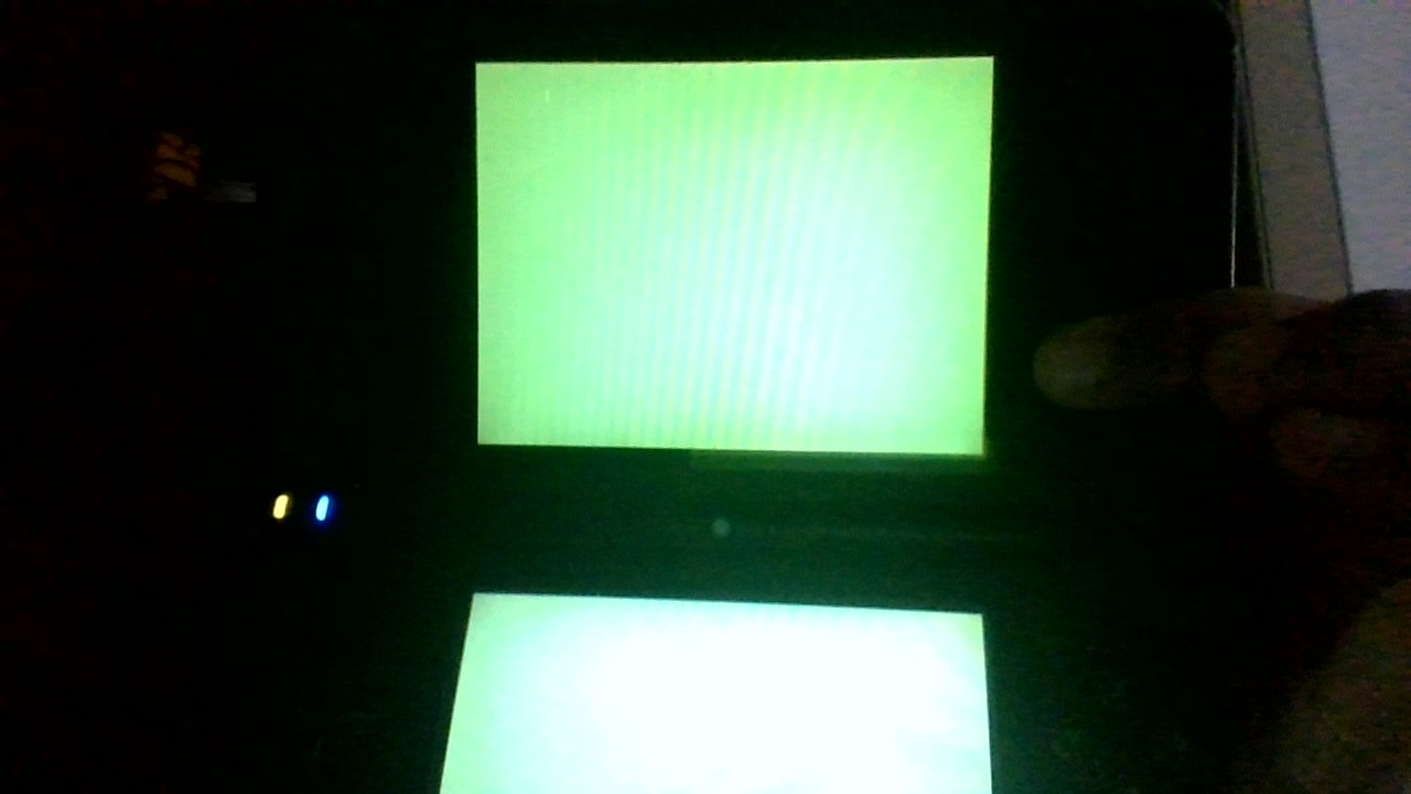

ok pls freaking help me bcs i want to freaking play my freaking ds games now i said it didnt work. see still green screen.
