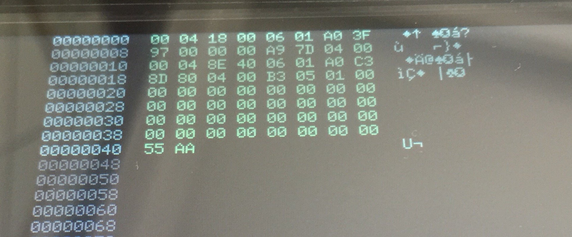

@d0k3
Here is the 2DS's twlmbr.bin.
BTW, firm0 & firm1 are successfully verified.
Only NAND & NANDmin fail.
I found another O3DS also failed on NAND verification.
But that O3DS's CTRNAND can be autofixed.
So maybe the fixing CMAC problem is not related to NAND verification?

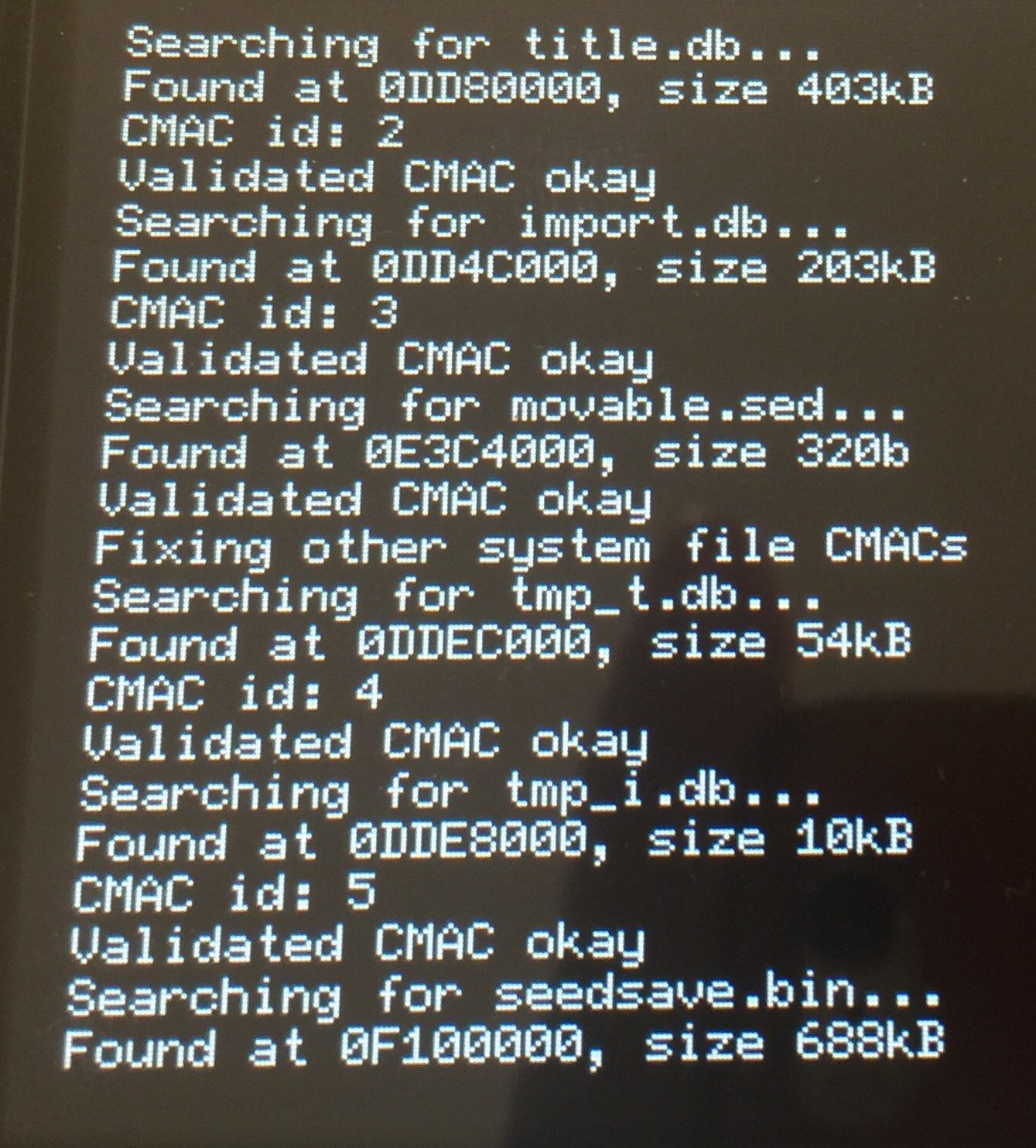

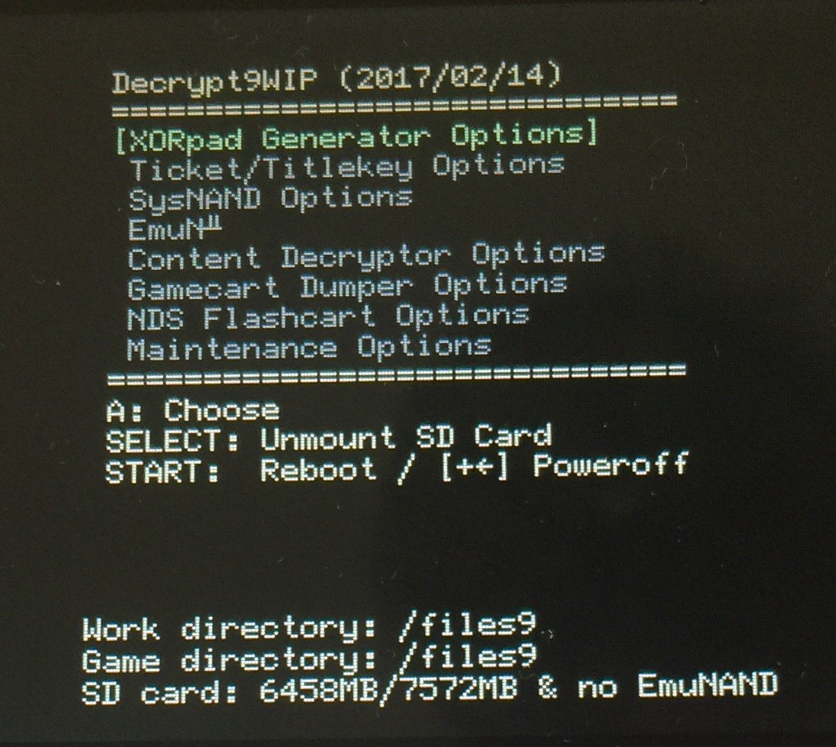

@d0k3
I changed safehaxpayload.bin into D9WIP 20170214.
This time Autofix CTRNAND can be processed, but freezes at processing SeedSave.bin over 10 mins.
(BTW, Safehax/D9WIP's "EmuNAND options" is displayed as "EmuMyu('Myu' is the greek alphabet)".)
@d0k3 2DS problem resolved.
I use Safehax/D9-20161113-release (which ignores that error) to make the CTRNAND transfer successful.
D9WIP 20161113's Autofix CTRNAND never caused any freeze and gave a result of no fixing CMAC errors.
So is the failure possibly from the over-strict of latest D9WIP's new CTRNAND transfer check?
Your TWL MBR looks fine, I'm a but puzzled about this right now, especially cause you're the only person that ever brought this issue up. And you say this happens on 2 different consoles? Can you, perhaps, open an issue on Github so I can keep track?

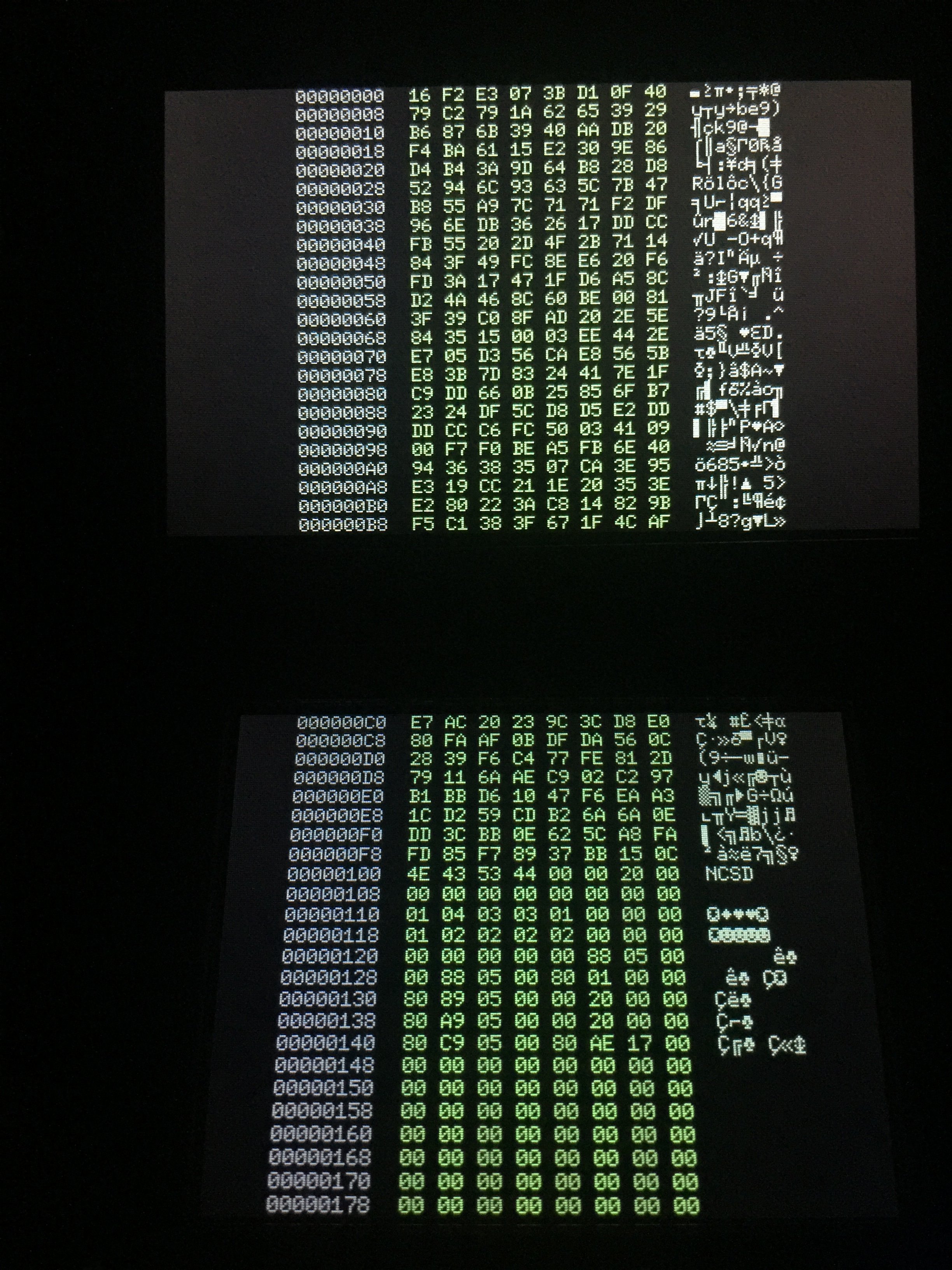

Also, @MelonGx, can you perhaps give me the header of the nand.bin that failed validation to have a look at? That's only the first 512 byte. Don't worry, there is no identifying info in there (even if the header itself is unique), but you can send it in a pm.

Can you, maybe, post the file instead? It would also help you posted both the nand_hdr.bin and the twlmbr.bin. Or send it in a pm, ofc. It's a bit difficult comparing this by hand. Also, @liomajor may be right - this may be an SD card issue, so better check the SD card, too. Does the validation fail in both GM9 and D9? With thze same error message?
