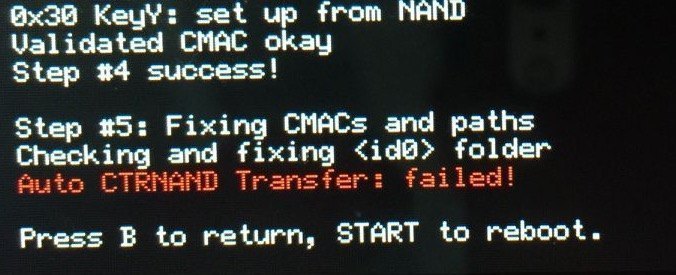

@d0k3 An unknown error on 2DS JPN 11.2.0-35 when processing Auto CTRNAND Transfer Step 5.
Autofix CTRNAND doesn't work either.
Don't know why it happens.
I restore the backup immediately after this error.

That will need looking into. Do you still have that console and are you available for some testing? First of all, I'd need to know the contents of the CTRNAND:/data folder (that's 1:/data in GM9).
I have to operate it on SafeHax/GM9 since it's 11.2.0-35J.
I'll post it 30 mins later.

@d0k3 2DS problem resolved.
I use Safehax/D9-20161113-release (which ignores that error) to make the CTRNAND transfer successful.
D9WIP 20161113's Autofix CTRNAND never caused any freeze and gave a result of no fixing CMAC errors.
So is the failure possibly from the over-strict of latest D9WIP's new CTRNAND transfer check?
