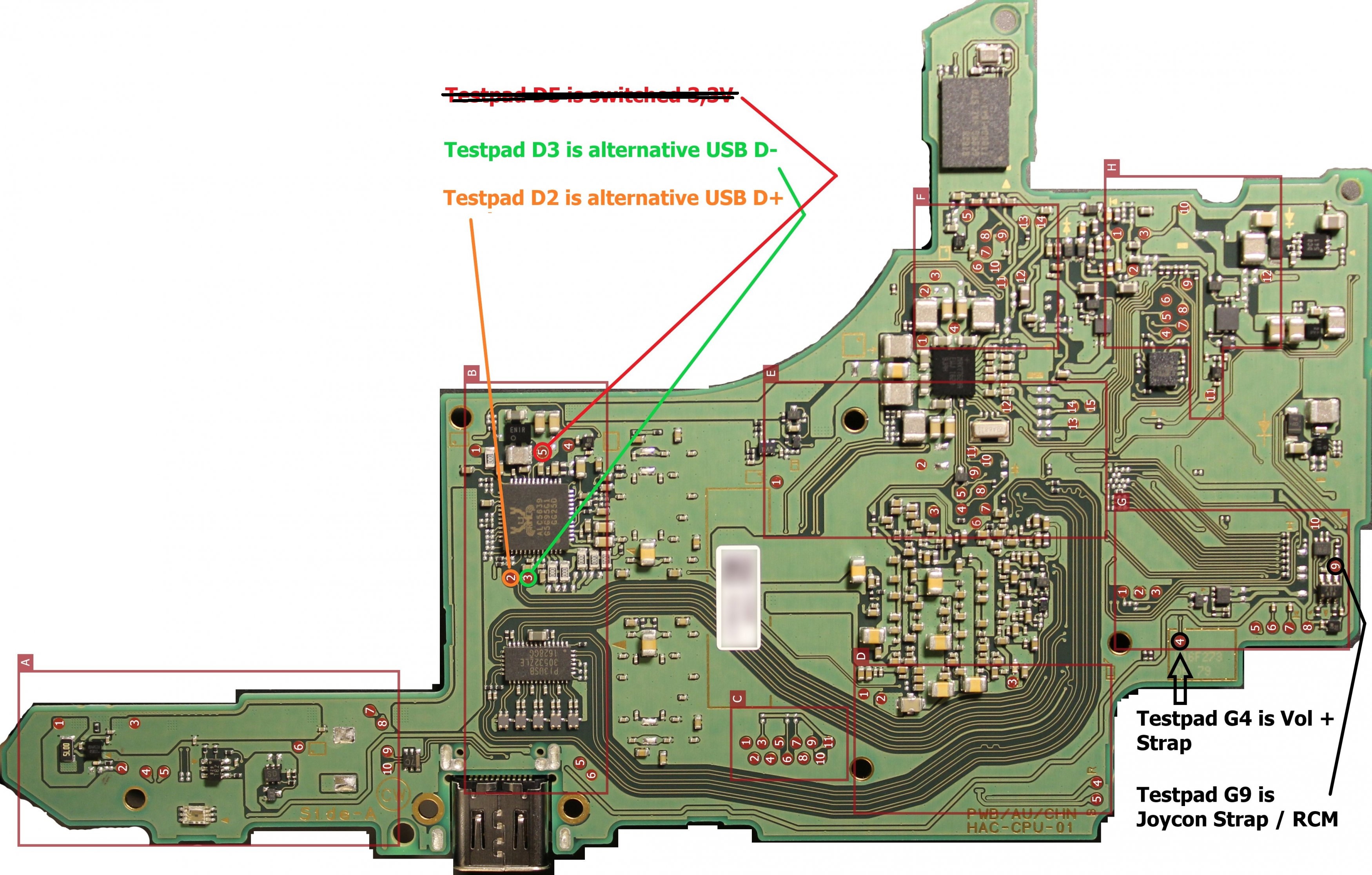

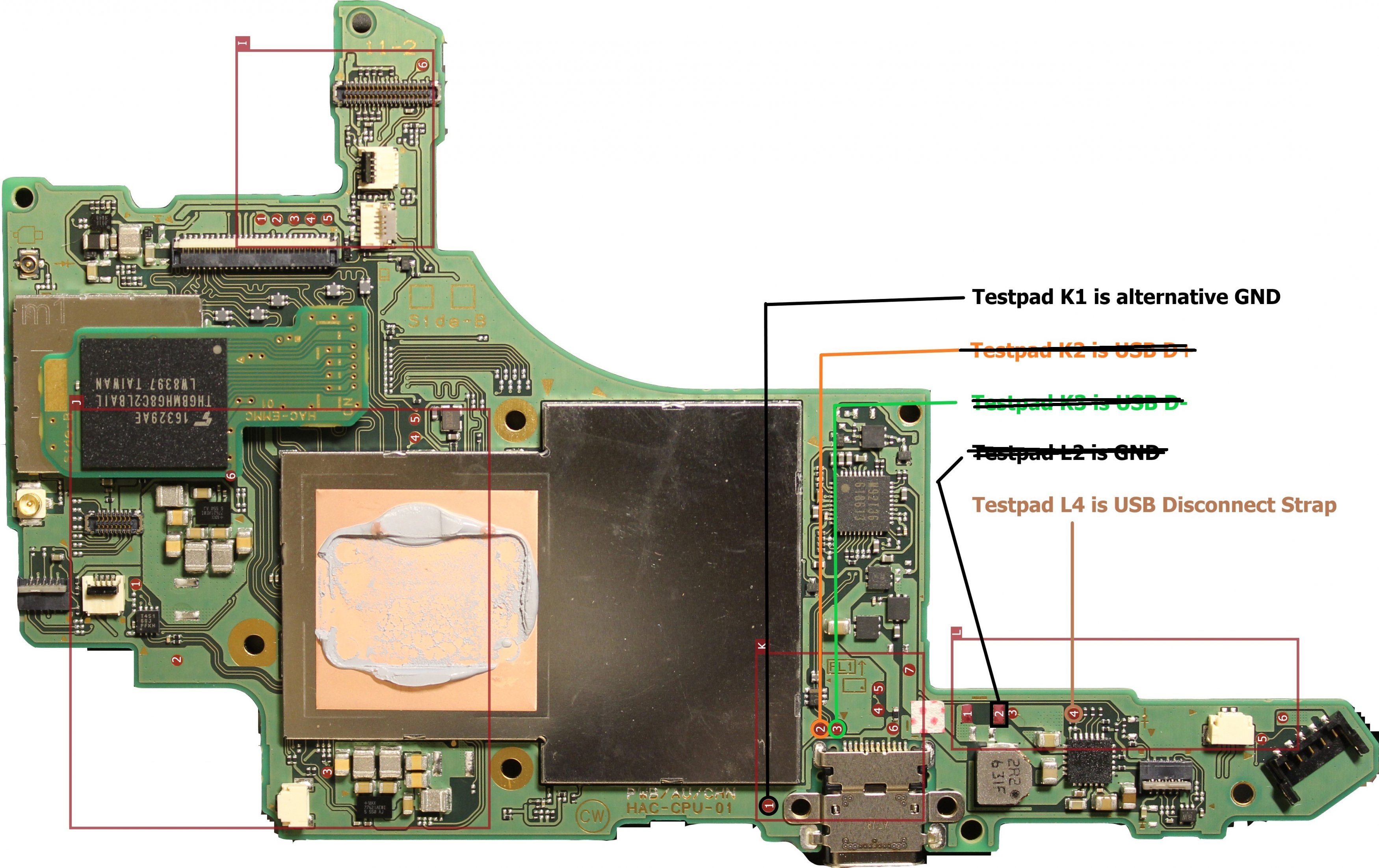

I was trying to install the RCMx86, everything went smoothly (or so I think), but now the Switch won't turn on at all, no icon, no charging, nothing...
One thing that happened is that initially I inverted the D- and D+ wires (connected D- from the switch to D+ on the chip) and Vol+ and Joycon strap (Vol+ to joycon and joycon to vol+); I know, it was a really stupid mistake, I confused the wire colors.
Anyway, after that, I rewired the chip correctly, tried to power but still nothing, so I completely removed the chip and the wires, reassembled the Switch, but it's still dead.
This is the wiring I made: (I attached 3v to the NAND contact, the one under the small detachable board)

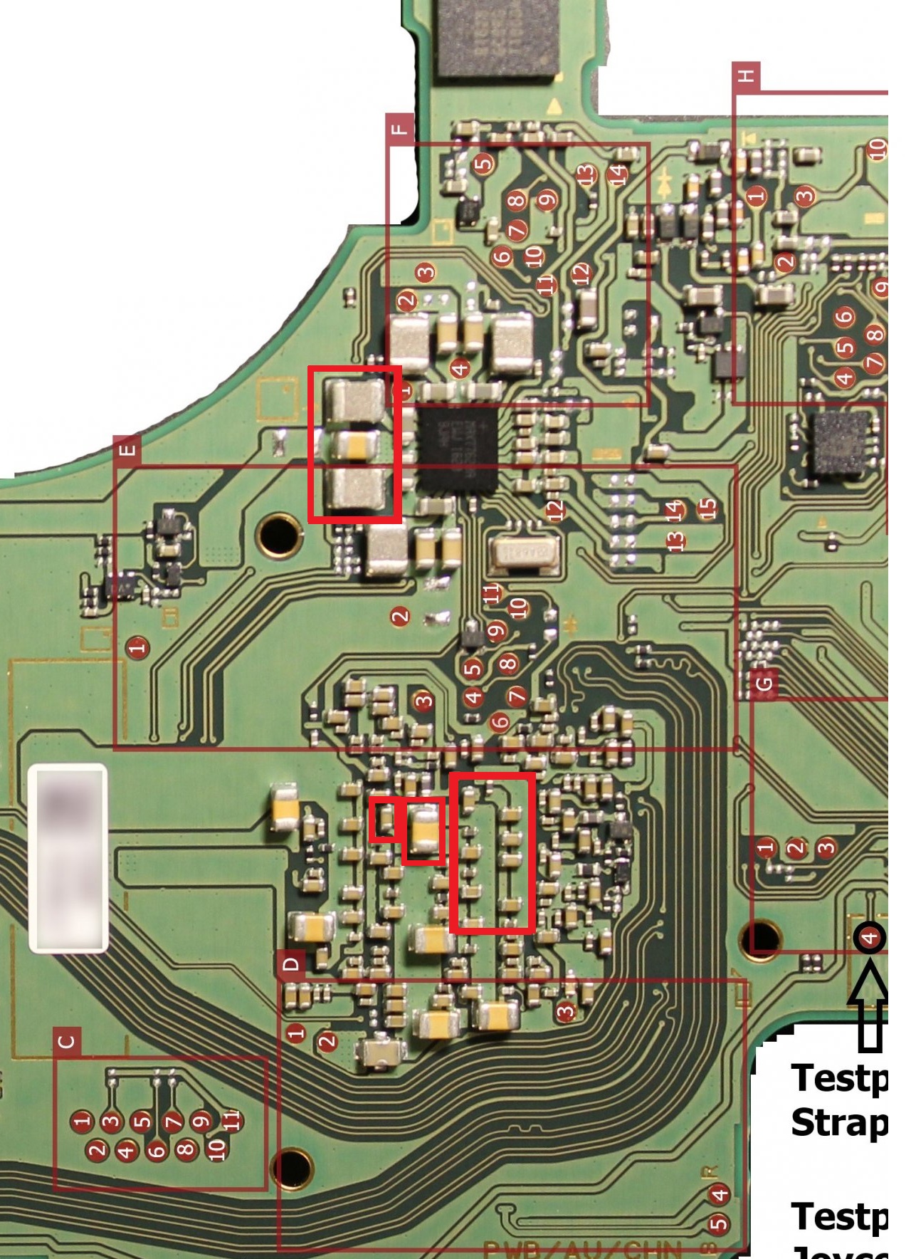

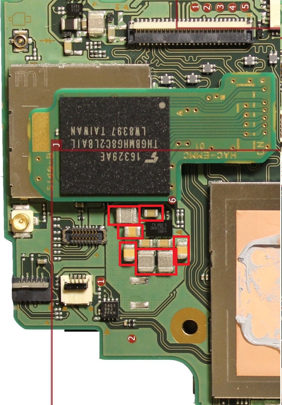

Also, I know that to check if a chip is bad, it's useful to check if there are capacitors shorted to ground, and I've found something but I don't know if what I've found should be shorted to ground and I don't know if those are all capacitors in the first place. (With shorted to ground I mean that both sides shows continuity to gnd)
Anyway, these are the "shorted capacitors":
Front:
Back:
I noticed the few in back, those in the center, are right behind what I think is the main processor, and are all connected to the same trace.
