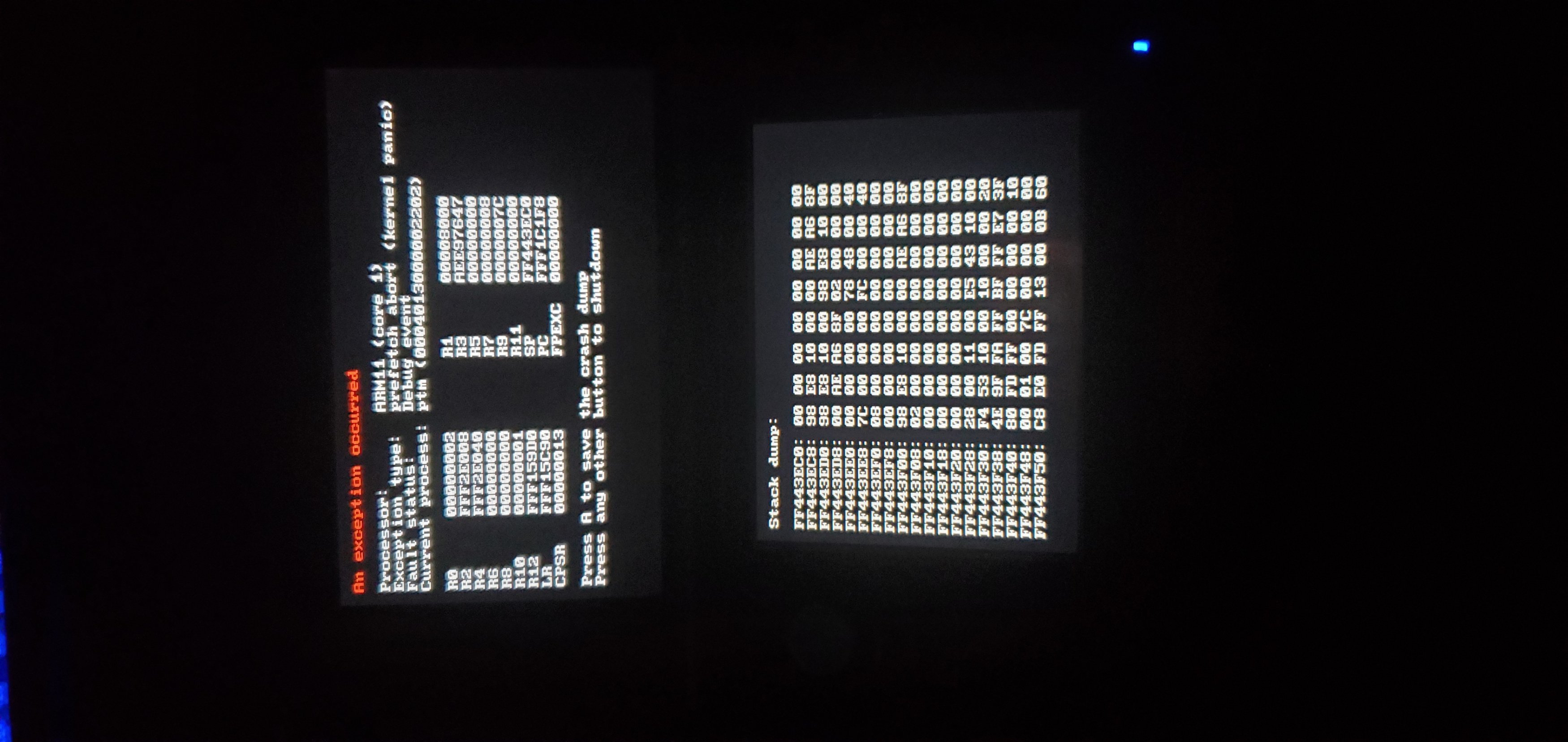

The 3DS boots...kinda. I get a power on but the screens are still black.
EDIT: I got a crash when pressing the power button to turn off
