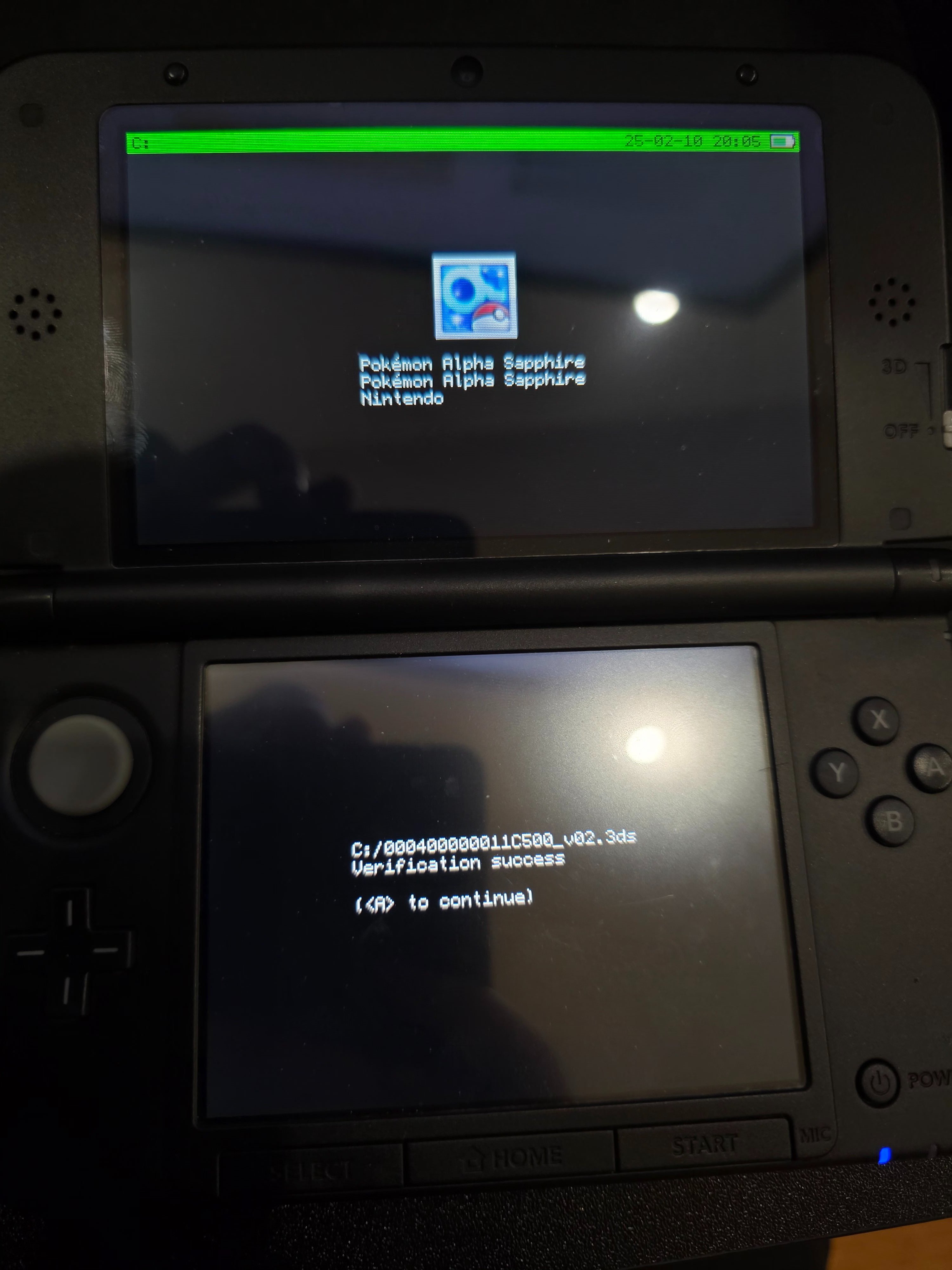

Hi, can someone help me this solution
I bought my friend alpha sapphire and alway error when I try to check the pokedex
After finish the fix cartridge corruption and I try to verify
It's fail at 20% so how can I fix it

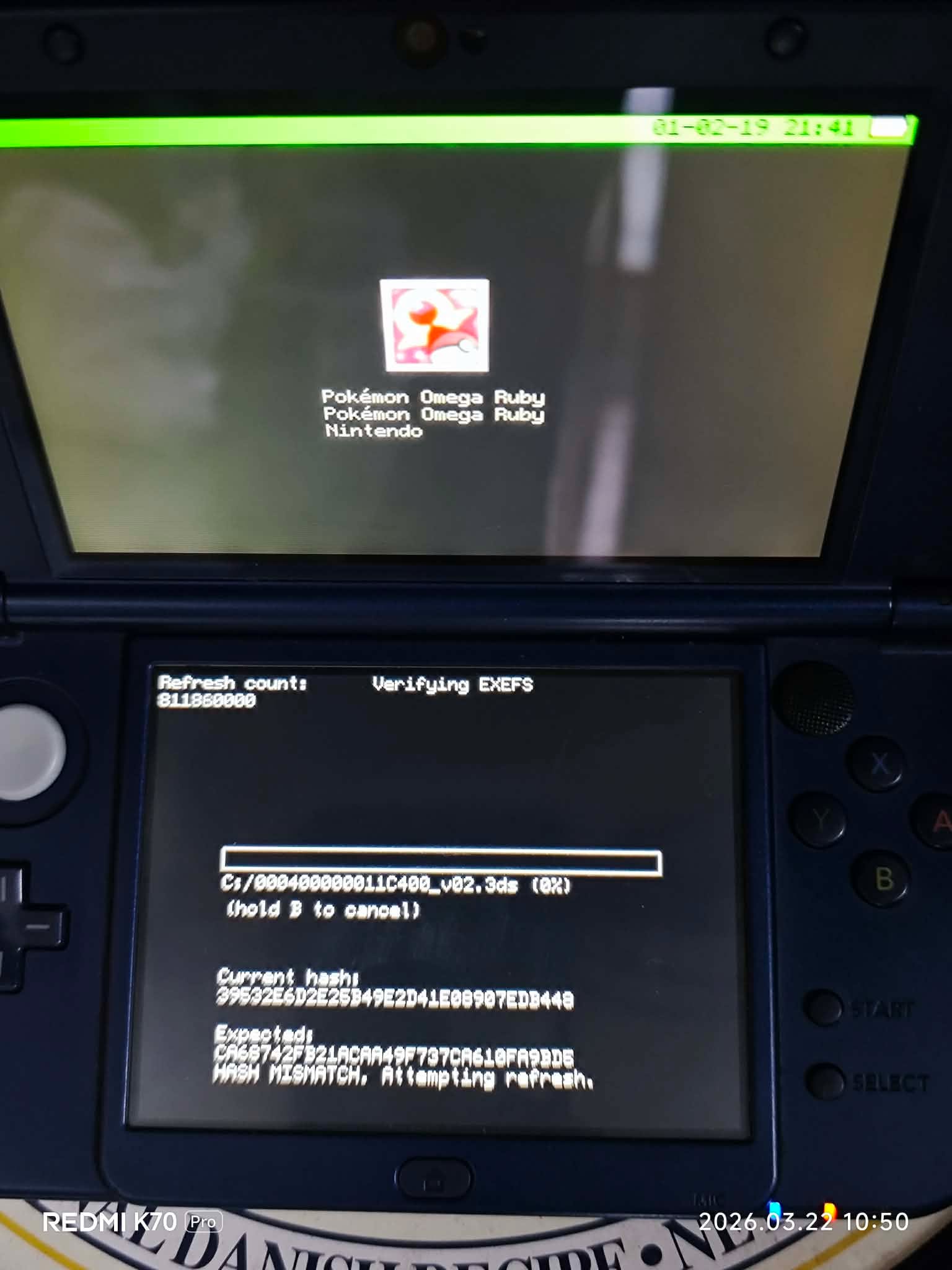

So, I have a copy of Smash that doesn't show the banner and when I try to open it, it says "game could not be loaded" both on a cfw 3ds and on a normal 3ds. I tried the program and it's stuck at the first hash and it keeps reloading for the past 5 hours on exefs without any progress. Is this normal or the cartridge is unrepairable?
The exefs part takes the longest, because the entire thing is just one chunk.
It's not out of the question that it will eventually move on, but it's rather unlikely once it gets to this stage.
Reactions: Frari0
But shouldn't it move past 0% by now? I'll let it run for the rest of the day, but I'm not very hopeful...
